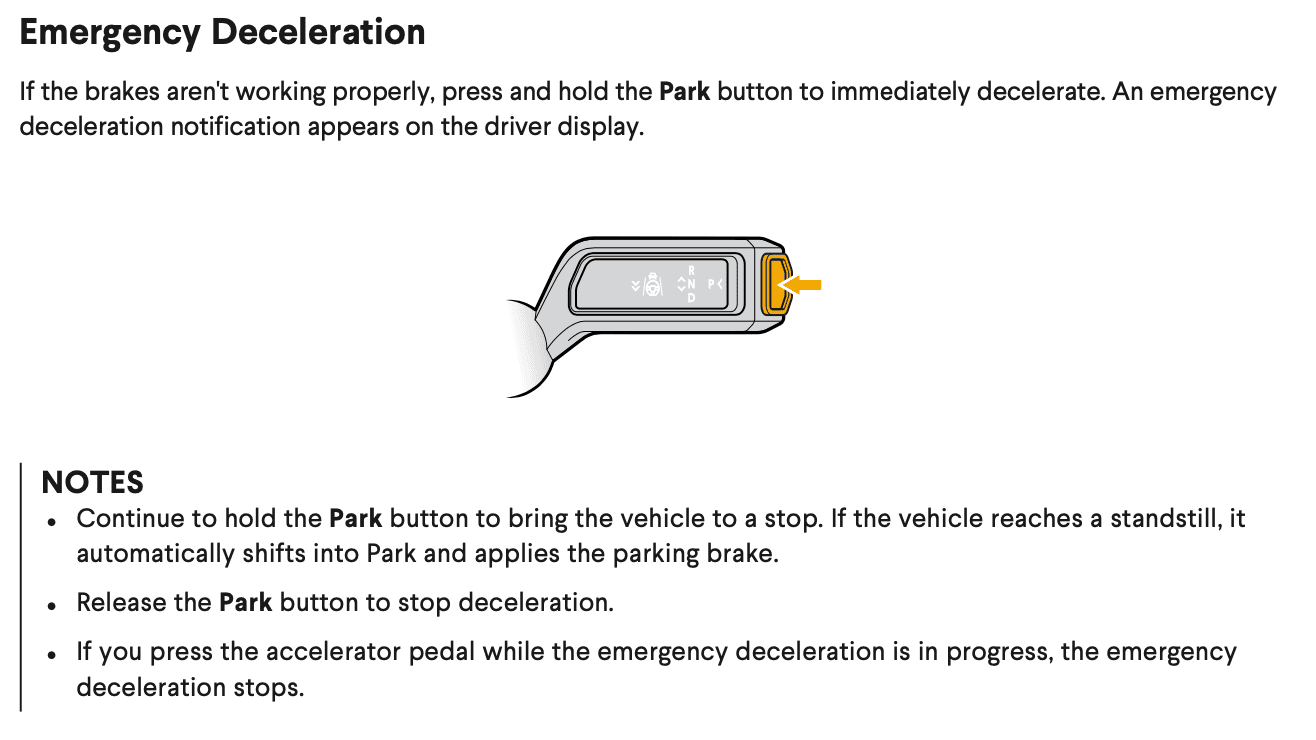

I'd been wondering what we do if we had a runaway accelerator, since there really is no off button/switch, and shifting to park by pushing the button while rolling doesn't work (ask me how I know). I guess you just get off the seat.
Not sure if it's the same with Rivian, but on Tesla I believe holding the park button for a few seconds is designed to act as an emergency brake, slowing the vehicle to a stop.
From the manual (I knew I read this somewhere):
Rivian R1T R1S Truck goes into park when I am in reverse Screen Shot 2022-05-17 at 10.08.31 AM
People who haven't read the manual do an awful lot of complaining/worrying about things that are already figured out. šŸ˜
