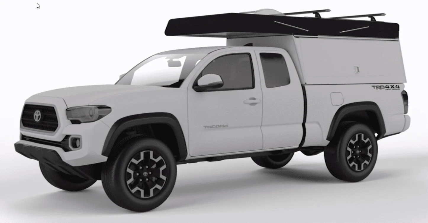

It may be too early, but has anyone tested out truck bed campers on the R1T or have any estimates of range impact from ICE/towing experience? Specifically something low-profile like the OVRLND pop-top camper. I've seen estimates from reddit threads etc ranging from 15-30% reduction and am curious what people here think or have seen.

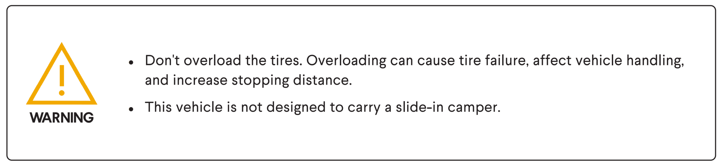

Rivian specifies that the R1T does not support slide-in campers. This makes sense given the weight/load limitations. Even with the Overland or, say, Home - Hiatus Campers, pounds add up very quickly. All gear, people, dogs, have to be figured in. Beyond that, however, there may be concerns and issues about center of gravity and stability when adding something like
I've never come across this. Not doubting you, just haven't seen it. Do you have a reference?

There are some very light, non-slide-in options like the GoFastCamper which should be fine from a vehicle dynamics & payload perspective.
However I'd optimistically guess that you're looking at a 30% range loss on something like these. They'll basically undo any cab & bed aero optimizations (which are numerous, including the rooftop spoilers) while adding a huge air scoop to the roofline and a major vortex behind the vehicle (which the aero profile is otherwise designed to minimize).
For comparison, I see a 30% loss from a low profile rooftop box on my Model Y at freeway speeds.
You'll also probably notice a significant increase in road noise, lose rear visibility, and render the roof glass moot (and a liability due to deflected rocks - I lost a roof panel in my Model 3 to exactly this issue).
All that said, it's a matter of tradeoffs. The range hit will still probably beat a trailer and some of the camper solutions are pretty cool - and it's really nice to have a place you can stand up inside. I'm watching GFCs developments with great interest.
Page 163, manual:
Rivian R1T R1S Truck Camper Range Impact 1651606079938
I really wanted a slide-in, but the payload numbers, not to mention center-of-gravity/performance/stability concerns mitigated against that even without Rivian's warning. Ignoring warnings like that is probably not a good idea.

Page 163, manual:
I wouldn’t worry so much about a “shell with a popup roof” style like the hiatus or go fast ones. They’re light.
presumably rivian means actual slide in campers, which are generally very heavy.
