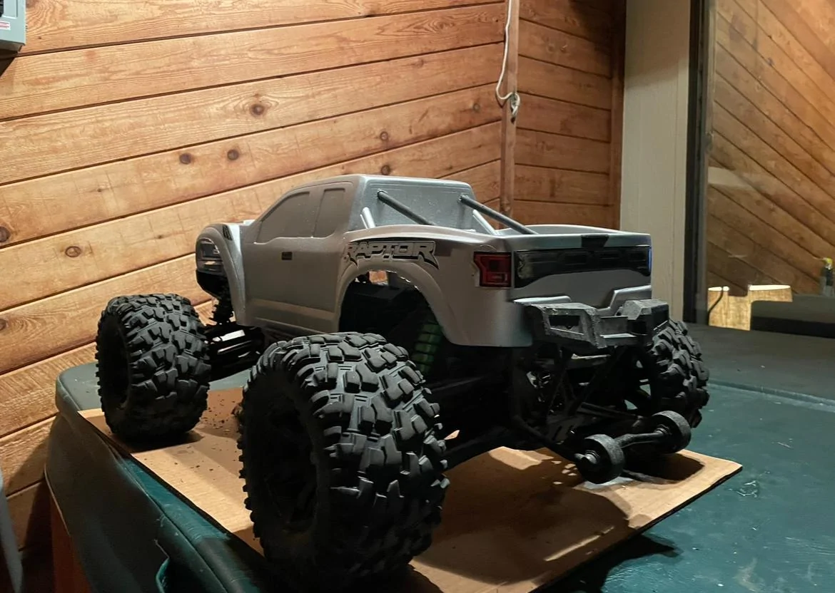

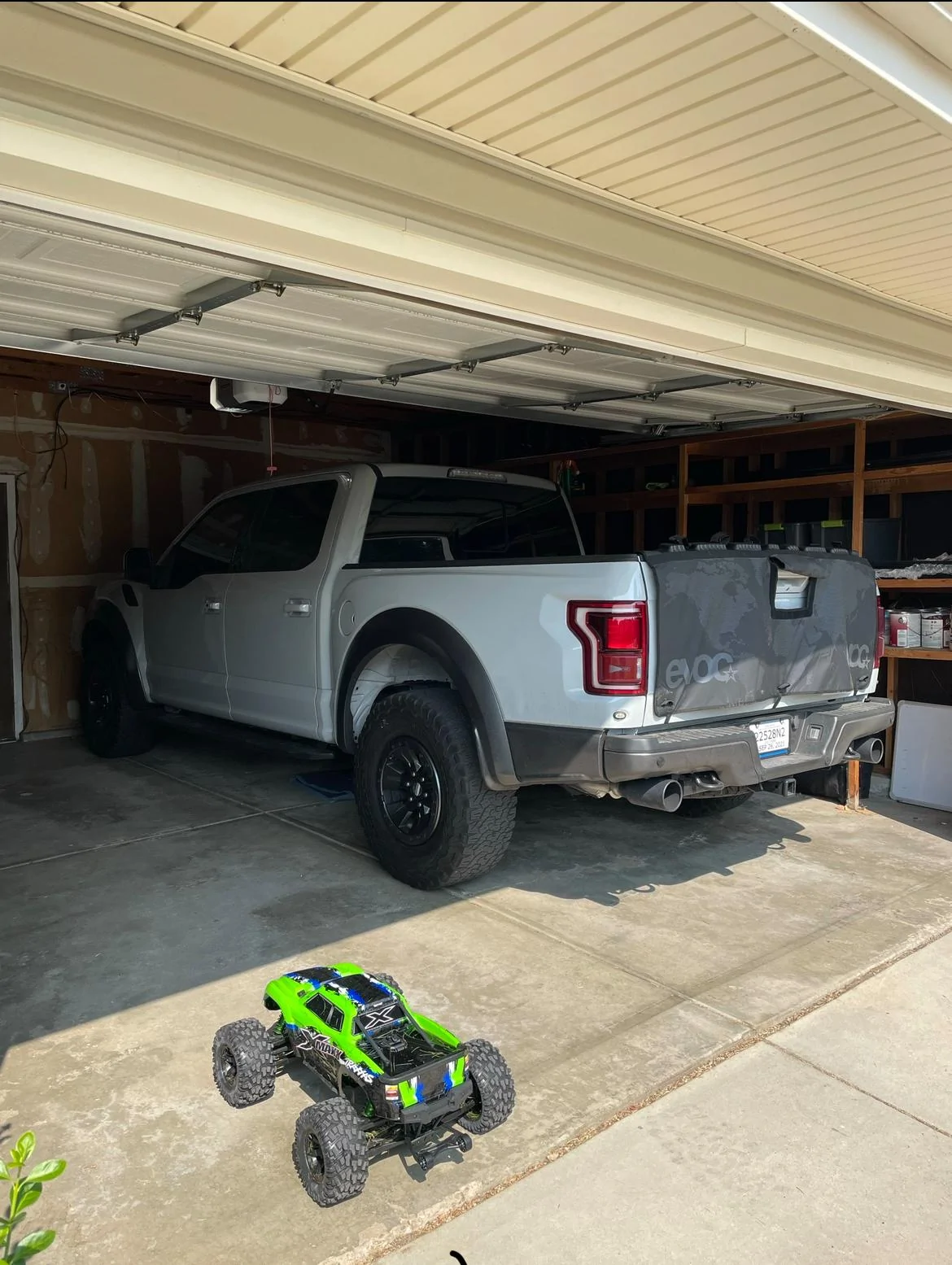

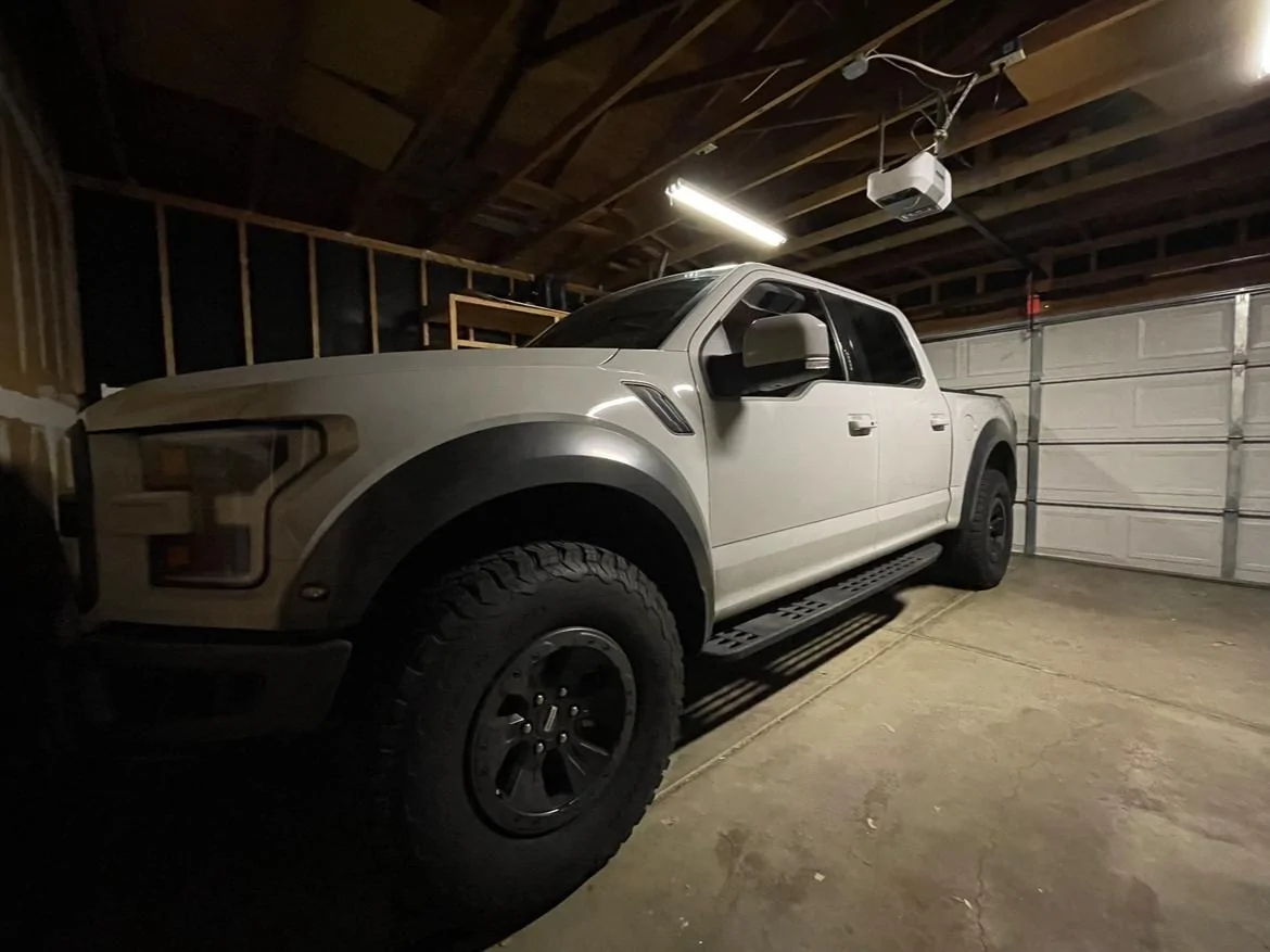

Anyone else out there also have RC cars/trucks? I have a few Traxxas models (X-maxx, Summit crawler, Sledge), and at one point had a Raptor shell to match the gen2 Raptor I had (picture below). Since electric RC trucks reign supreme (in my opinion...), there should be a shell to match the R1T! A full-size R1T and a mini-me R1T. Anyone else consider this or have the skills to fab a shell? I'd buy one.

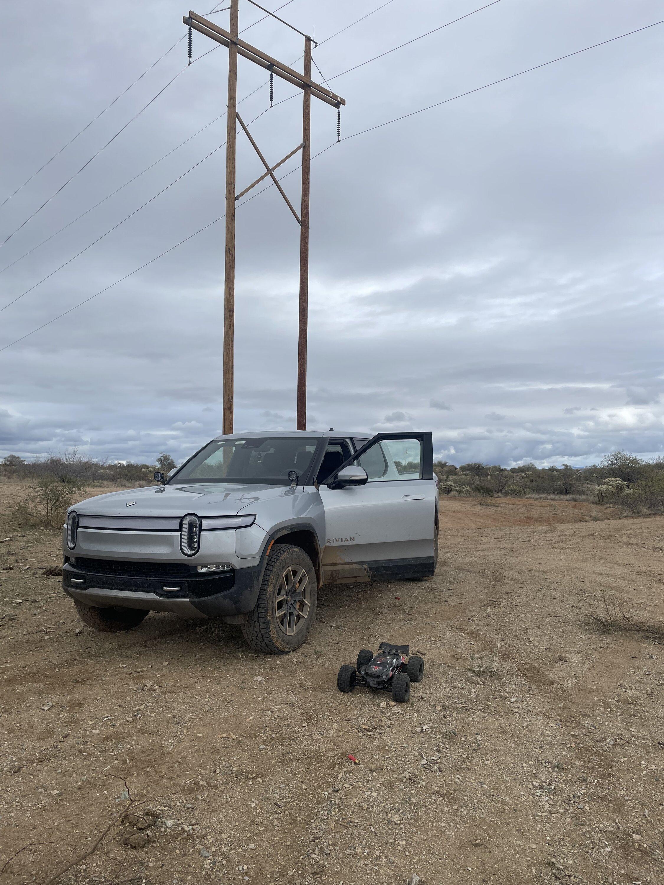

Photo from some desert running the other day where I took the sledge out as well. The only side by side shot I took 😅. Also some offroading shots and muddy buddy takes for good measure.

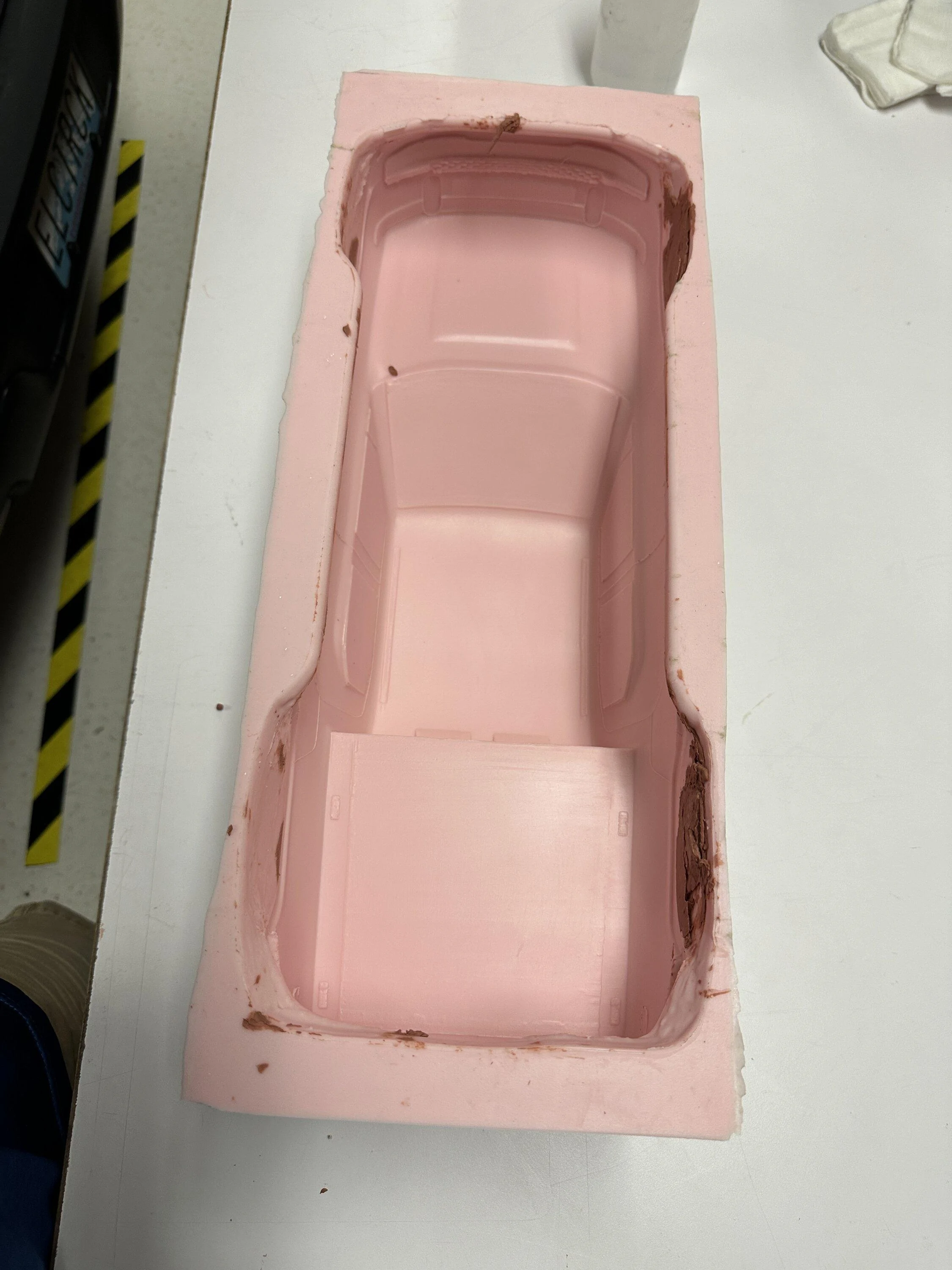

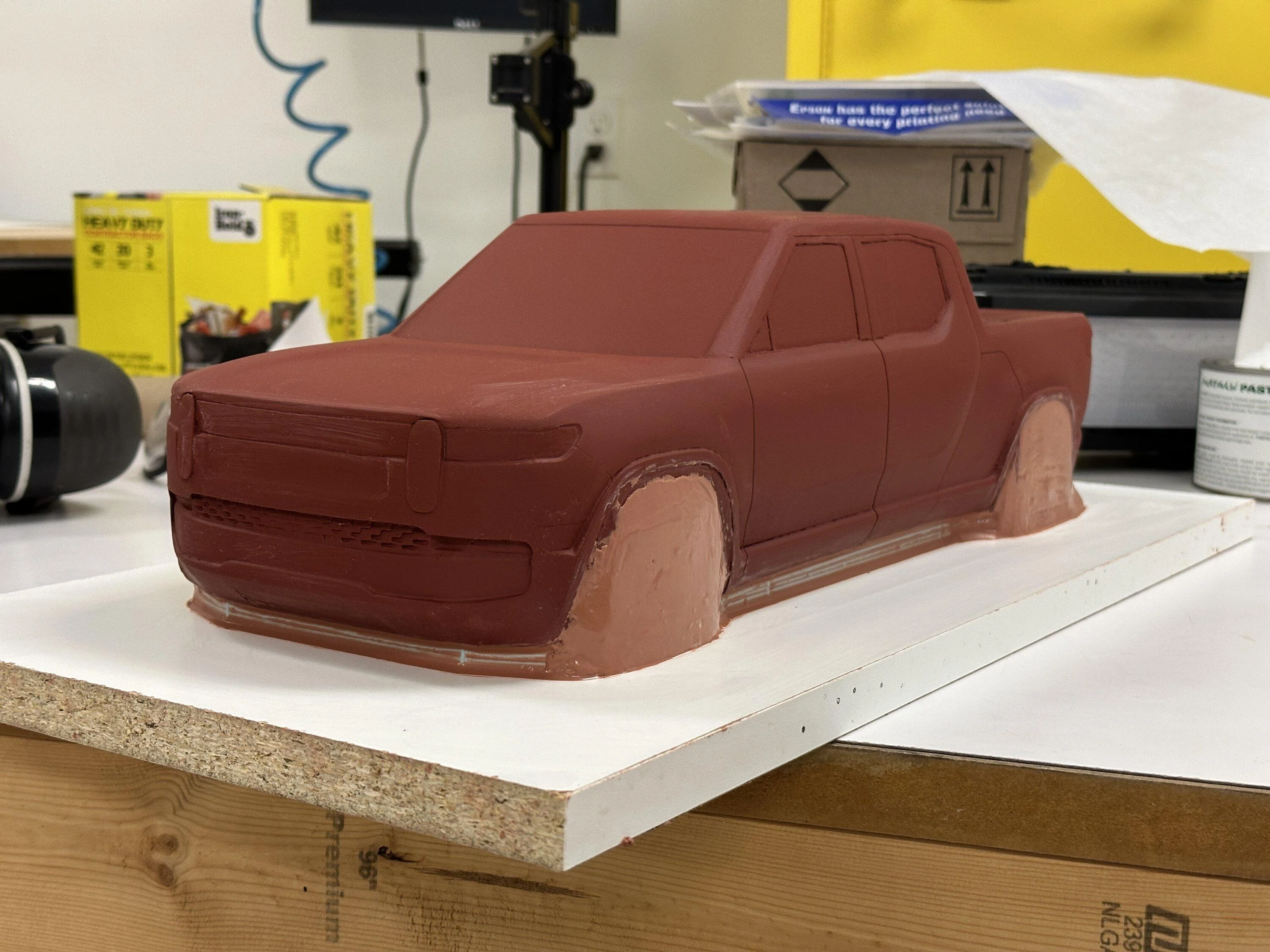

So... I've been holding off on posting anything until I got a little further on the project, to make sure it wasn't a total flop... but yes I am making a vacuum-formed R1T body, 1/10 scale. While I have lots of fabrication skills and abilities in my shop at home, I have never thermo-formed anything like this, so I am expecting a steep learning curve. First step has been building the plug. I'm almost done with that. I'll have a more detailed post about it all soon (TL;DR... 3D printed the body, now creating a silicone version of it with a rigid core, because of all of the undercuts on the body)
I'm mostly making this for myself, but my hope is I get it down nice enough to be able to sell them. Won't be cheap though, this project has turned into a lot more work (and a lot of money in silicone...) than I was originally envisioning :)

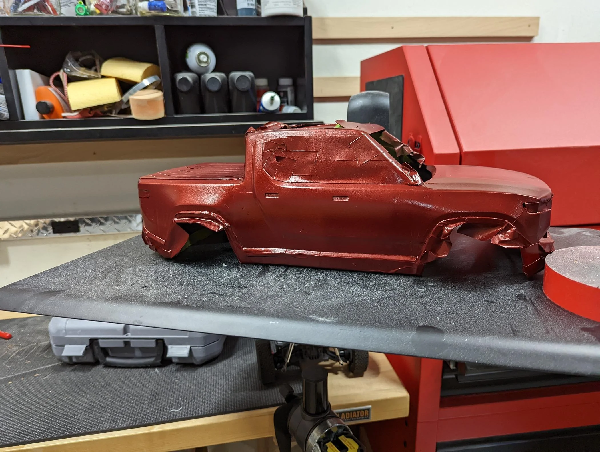

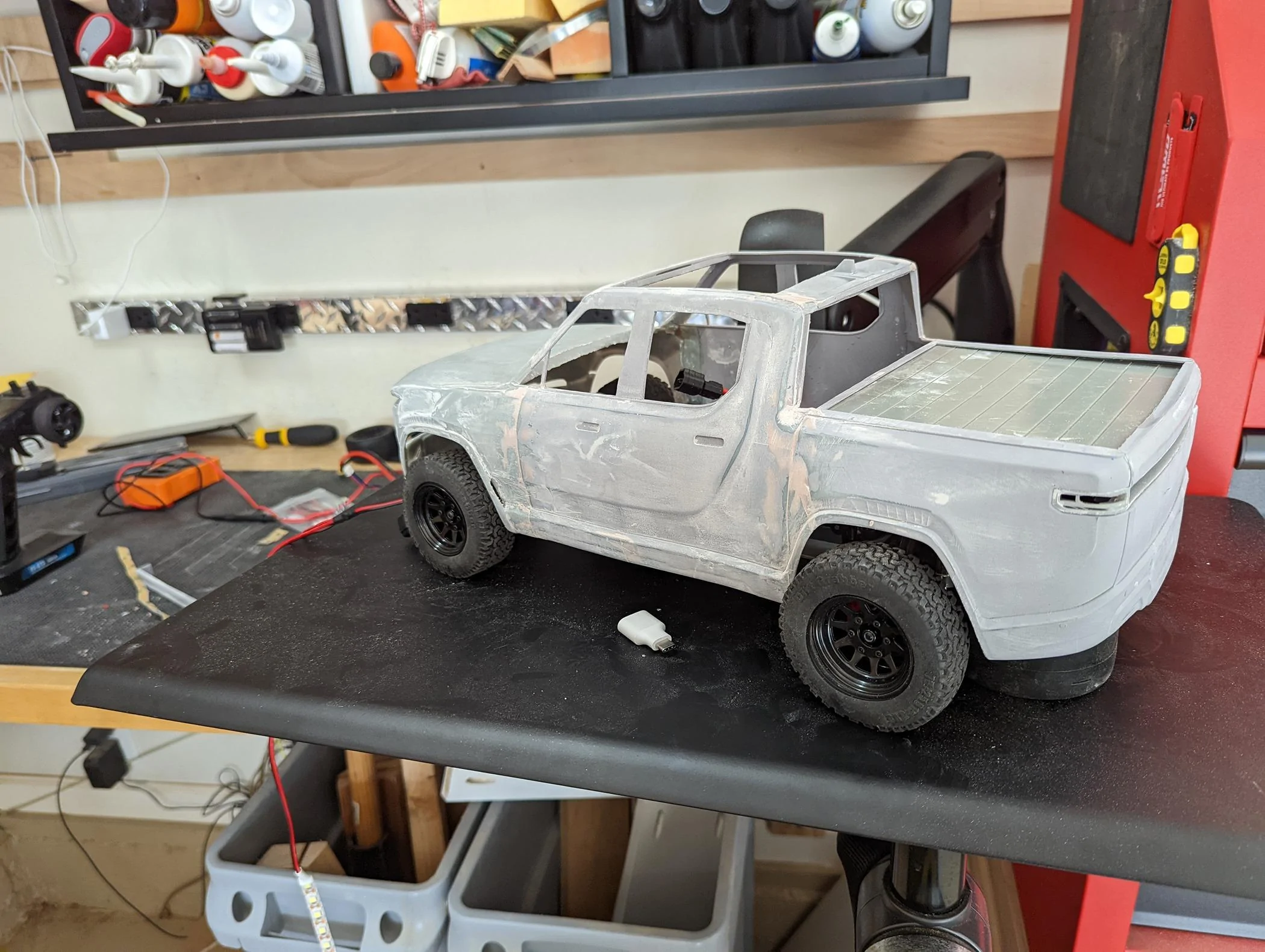

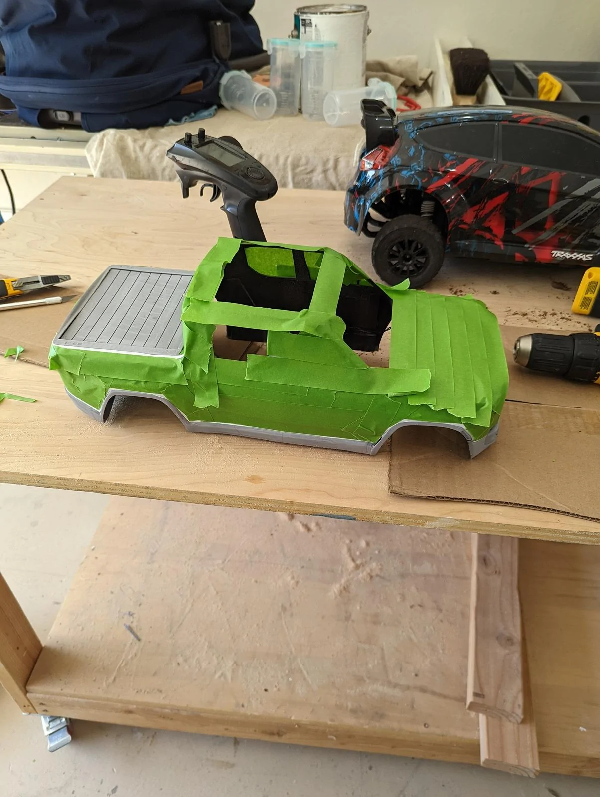

Here is my 3d printed attempt, alas we had a second child so I've never finished it properly. I have some scaled 3d models... Of anyone wants them. But they aren't great as I kinda just hacked my way through CAD.
The chassis is a newer Traxxas 4tech 3.0 as that had the closest proportions to the real thing.
