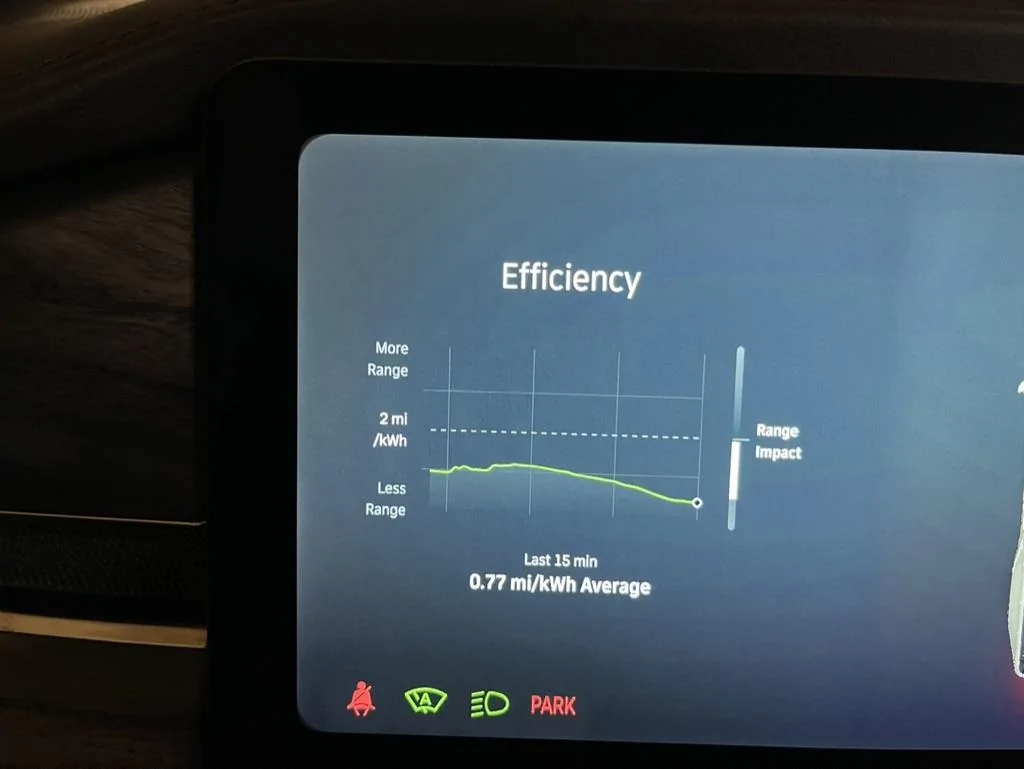

Since this was my first time towing with the truck I charged the battery to 100% overnight. As you probably know, battery regen turns off when they battery is in a high state of charge which made for an interesting start. The first part of my trip was hilly and I used a lot of battery dragging the trailer up these hills and got zero regen back down. From memory, I think I averaged .73 miles/KWH for the first 15 minutes. It was enough where I was doing the math to see if I needed to stop mid-trip to charge. Thankfully, the trip leveled out and the regen turned back on as the state of charge came down.

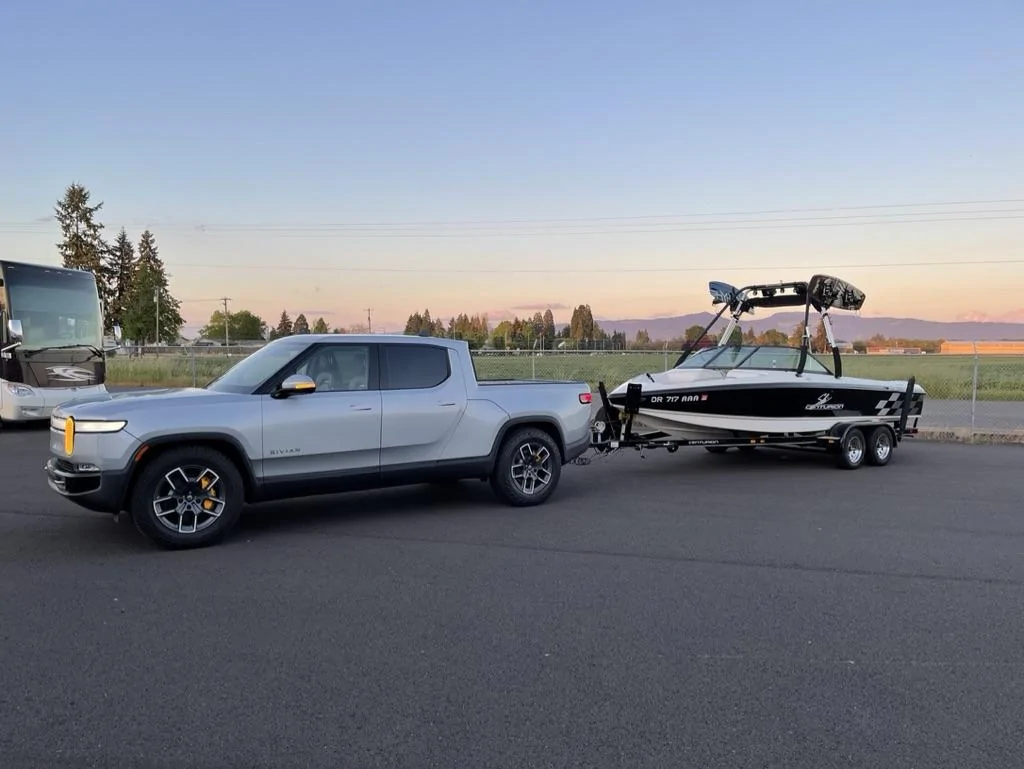

Here are some stats:
  • 42 miles round-trip
  • 5000 lb boat + trailer
  • 400 ft elevation change
  • Mixed city, freeway, highway, backroads
  • 70% SOC start
  • 38% SOC end

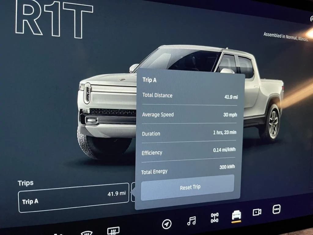

Can you clarify your stats and your picture? Looks like you used about 32% of the battery, on a 125 kWh usable that would be about 40 kWh used so just about 1 mile per KWh.
That trip A picture is really messed up, shows 300 kWh used .14 miles per kWh.
I think what you typed seems to be what I would expect but that tells me the trip meters at this point are not trustworthy.
Yeah agree, I think the trip meter is off quite a bit on the 300kwh used and the .14 miles per kWh. When I got home the other meter on the driver display said 1.17 miles per kWh .
