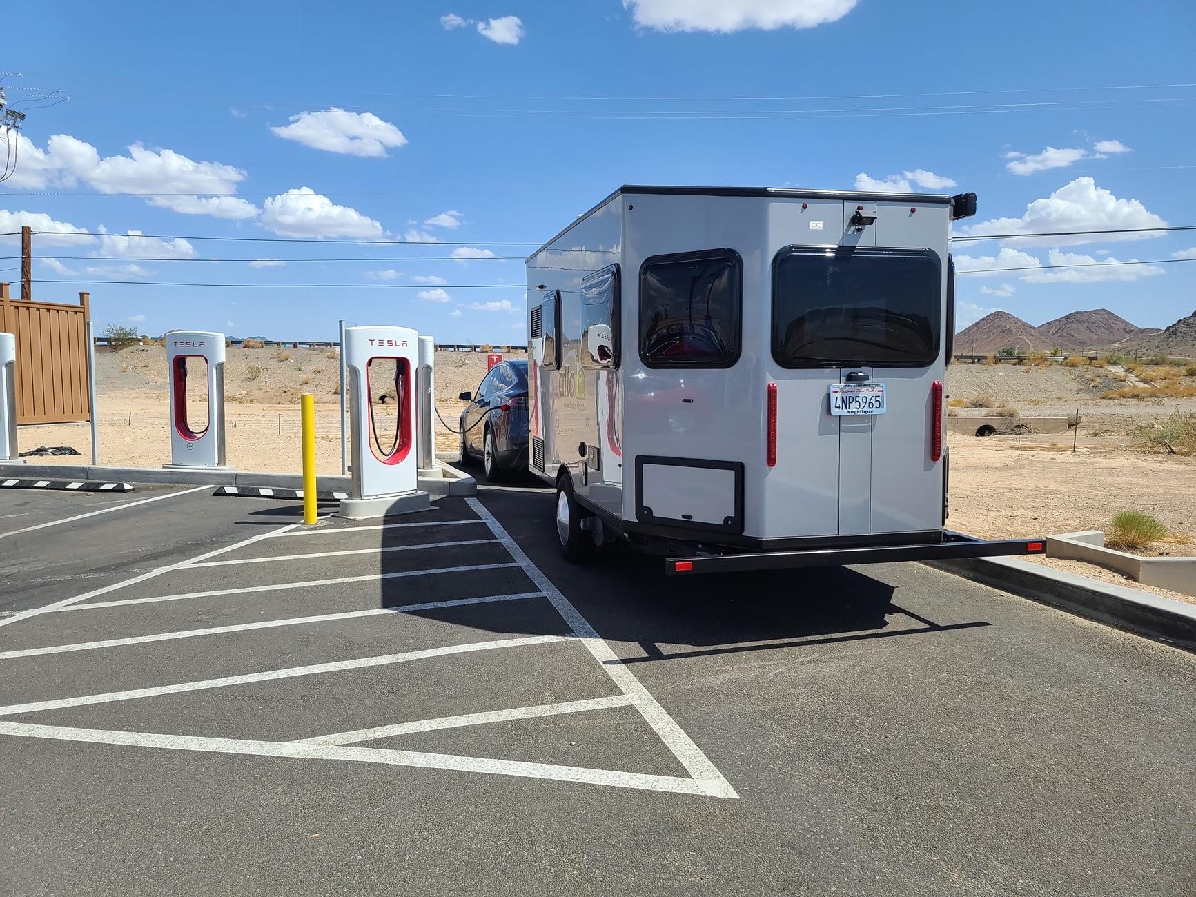

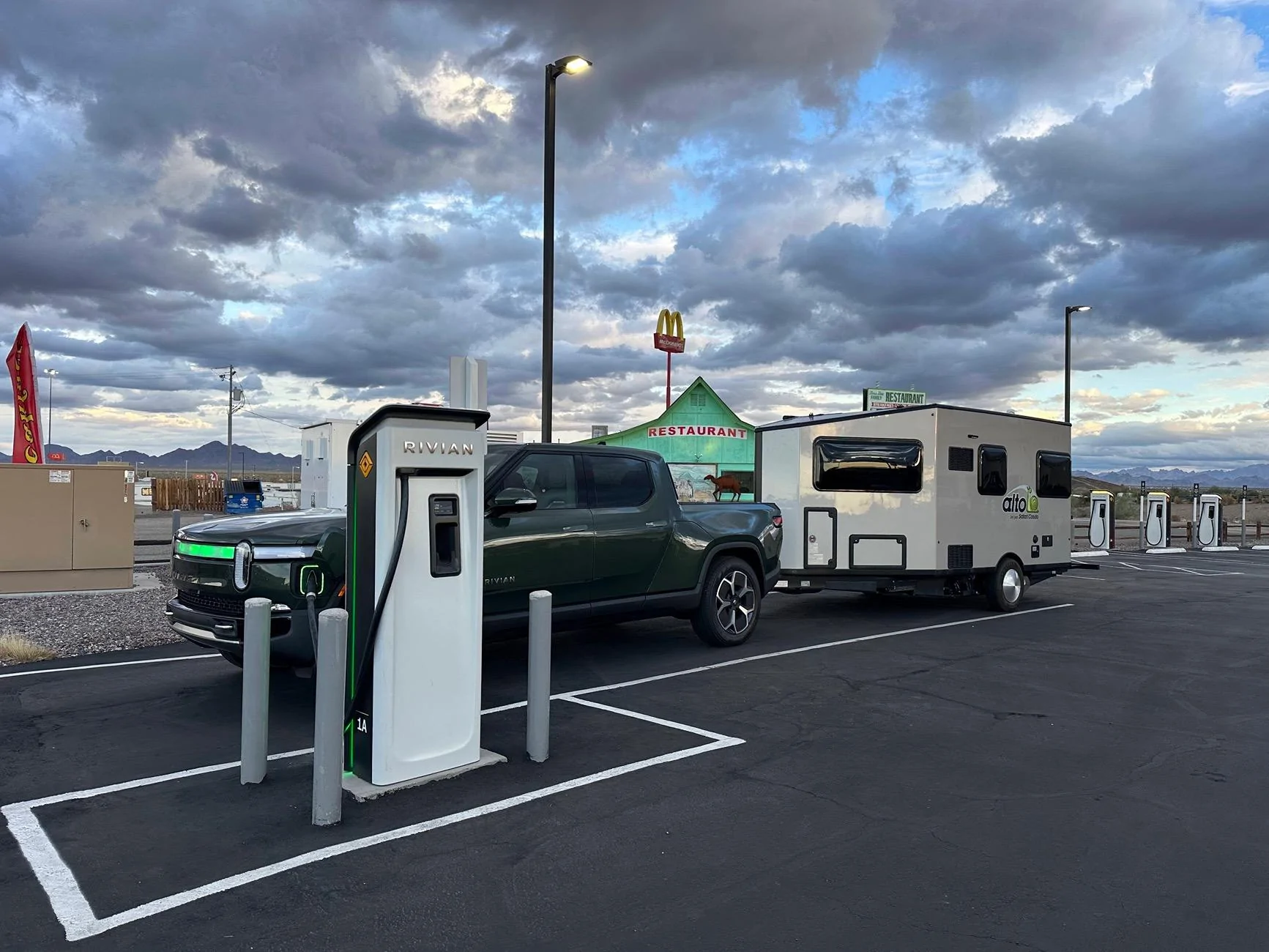

I used to tow our Alto A2124 with a 2017 Tesla X100D and switched to a 2023 Rivian R1T Dual Max Pack Performance the end of last year. With the X I kept speeds to 55 mph max for more range. We averaged about 520-540 wh/mile but hills, wind, and temperatures all impacted those results. I remember averaging 1280 wh/mile for the first 20 or so miles climbing out of Death Valley but by the time we reached the supercharger in Baker my overall average was 555 wh/mile. In the R1T I go a bit faster ā€” 60 mph. With that I average 1.6 miles/kwh (1/1.6=625 wh/mile). The X towed great but i wanted more range. The R1T pulls better ā€” even more stable even in winds. With the charge port on the front and longer CCS cables I rarely have to drop. With the X we dropped about 1/2 the time.
Rivian R1T R1S Towing stats: 3650 miles, total miles just under 4400 miles (2023 R1T DM Max pack w/ 2020 Airstream Basecamp 16X) IMG_7287_Original
Rivian R1T R1S Towing stats: 3650 miles, total miles just under 4400 miles (2023 R1T DM Max pack w/ 2020 Airstream Basecamp 16X) 20220630_145505_Original

I used to tow our Alto A2124 with a 2017 Tesla X100D and switched to a 2023 Rivian R1T Dual Max Pack Performance ā€¦ In the R1T I go a bit faster ā€” 60 mph. With that I average 1.6 miles/kwh (1/1.6=625 wh/mile).
Towing my Alto F1743 I get about 550-600Wh/m at 60mph (level dry road, no headwind). The R1T is not as energy efficient as the Model X so I think you are doing well to get 625Wh/m at 6mph with your A2124.
