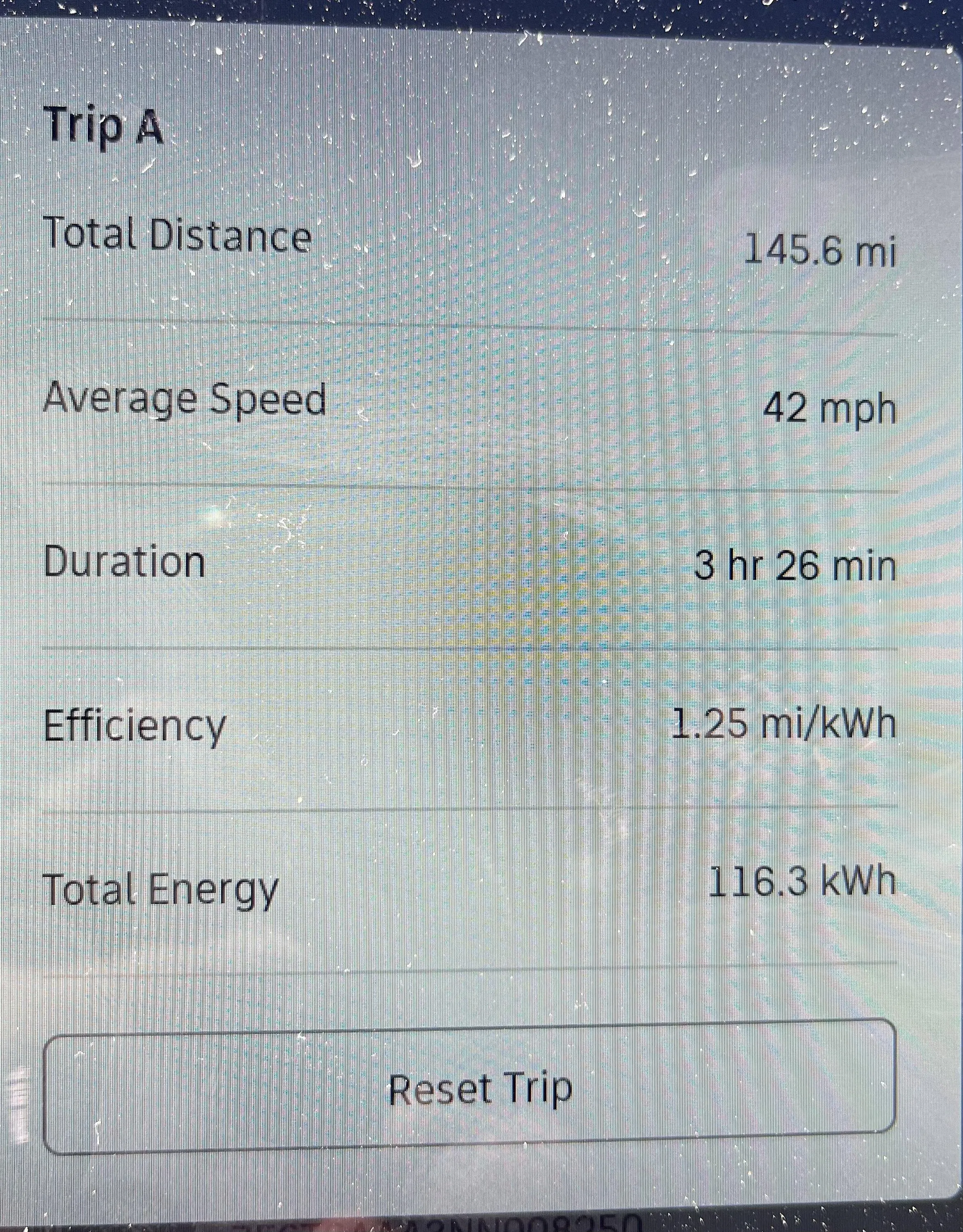

We just finished the 1st half of our trip towing our 28' Airstream to Vancouver Island. Leaving from Bend I admit to some range anxiety traveling from Madras OR (2200 ft) and crossing over Mt Hood (3900 ft) for a climb of 1700 ft. Actually the climb was probably closer to 2500 ft as there is an 800 ft drop into the canyon just north of Madras.
At Madras we charged to 100% and arrived in Clackamas with 34% (86 mi) for a total efficiency of 1.25 mi/kWh. I was very cautious driving up Mt Hood, going no faster than 55 mph and due to construction often quite slower.

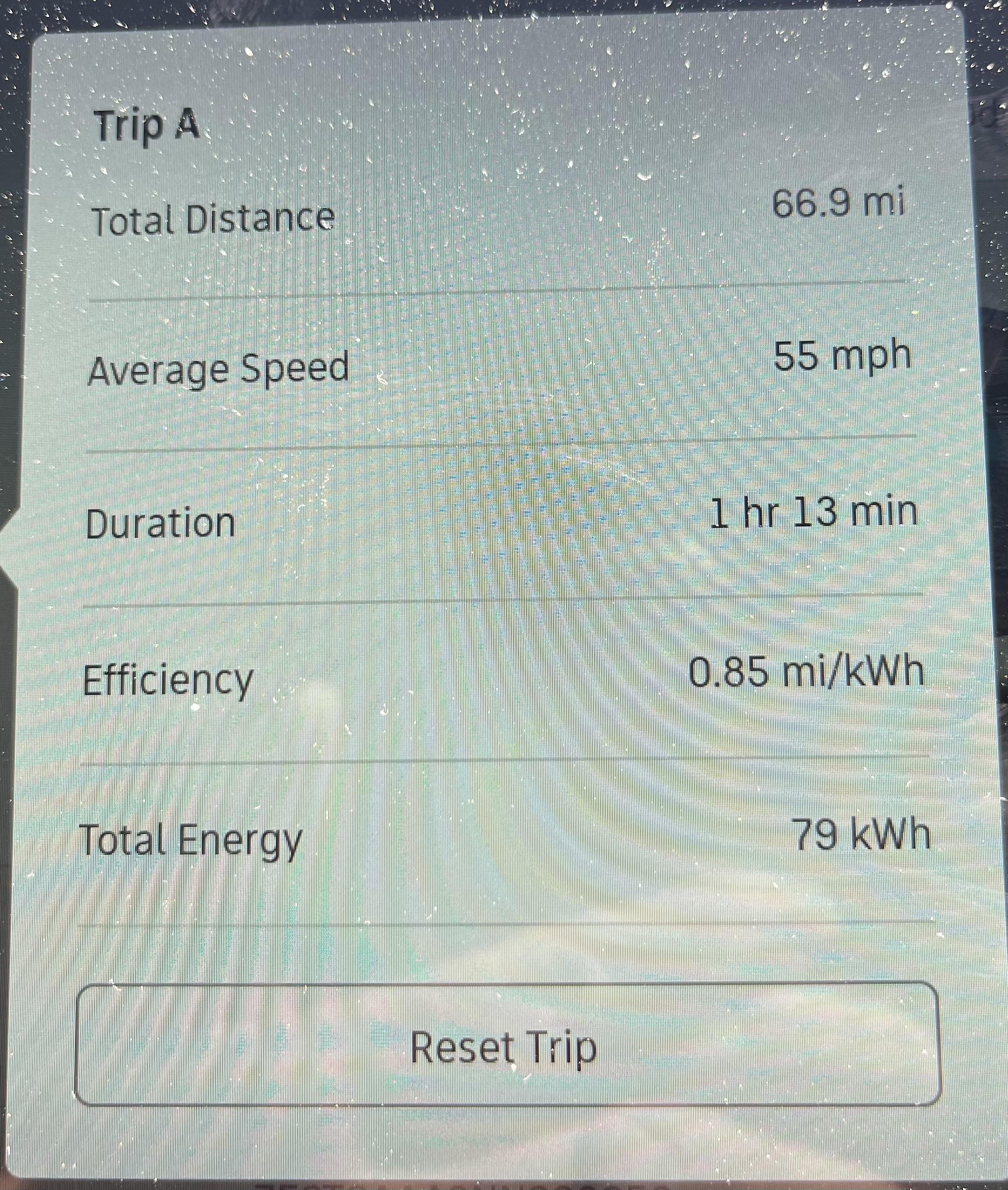

From Clackamas we drove to a campground just north of Castle Rock with an efficiency of 0.85 mi/kWh. This can be explained by my exuberance at having made it over Mt Hood and we drove I5 at 70-75 mph with a 25-30 mph headwind.

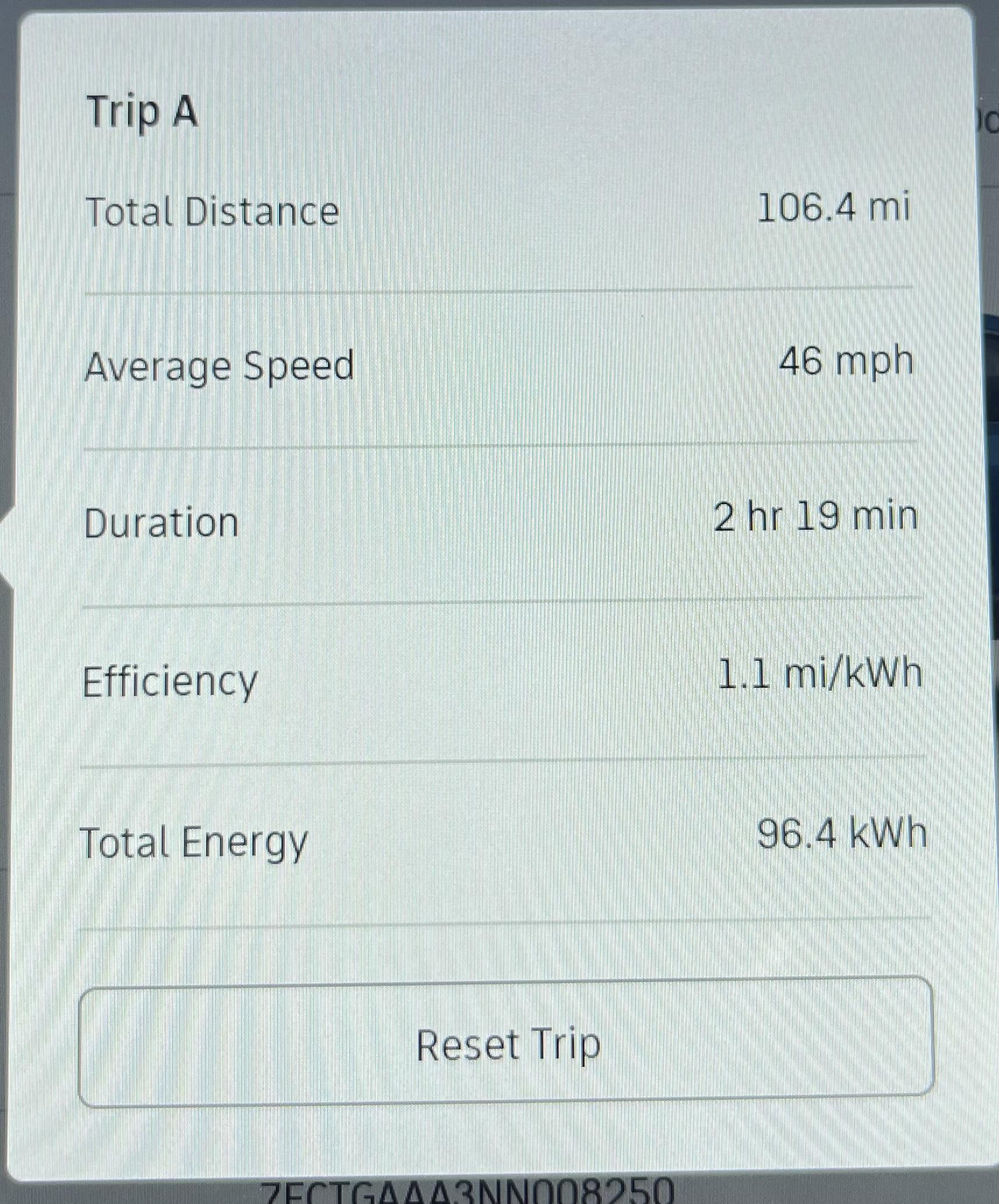

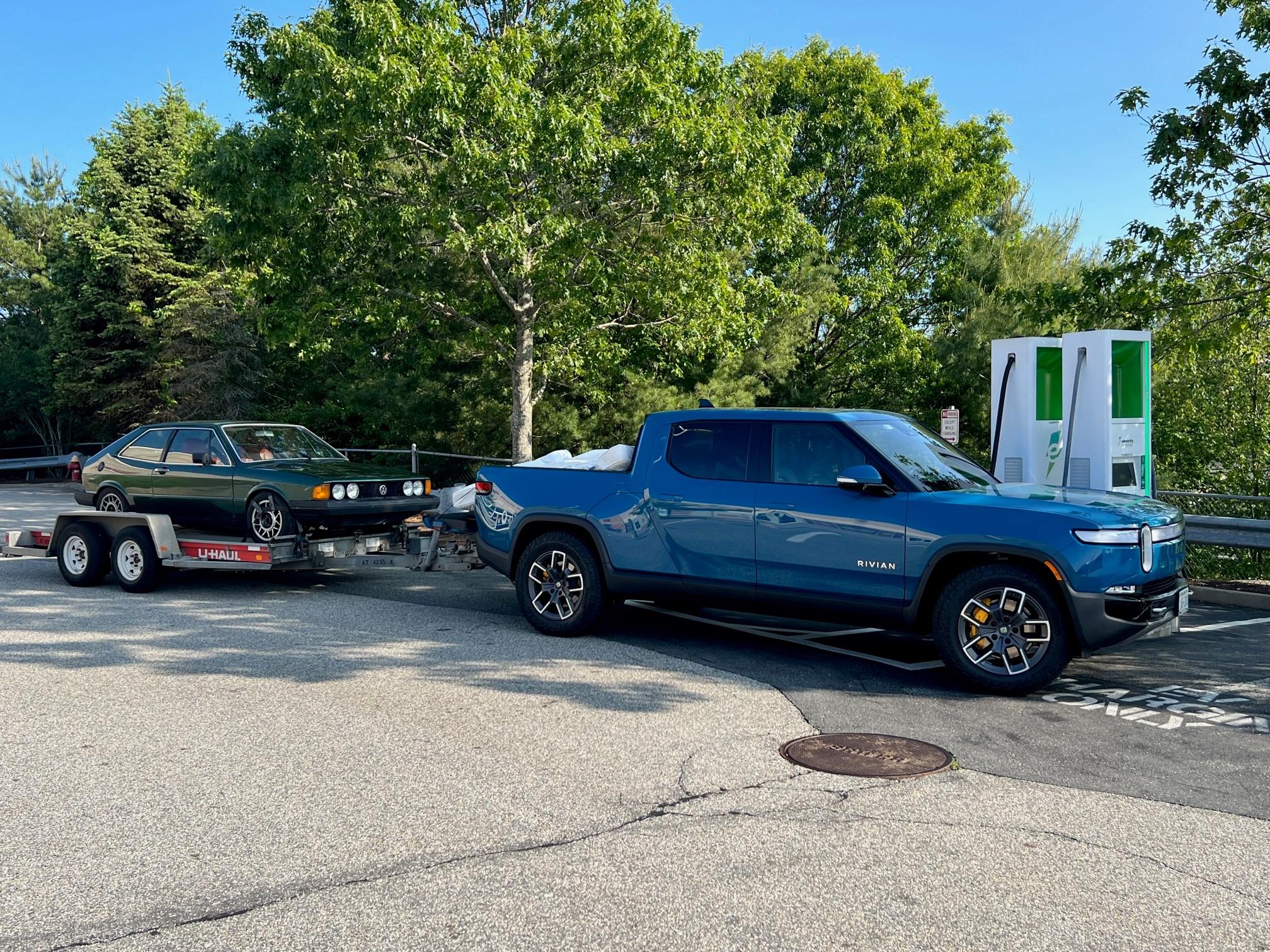

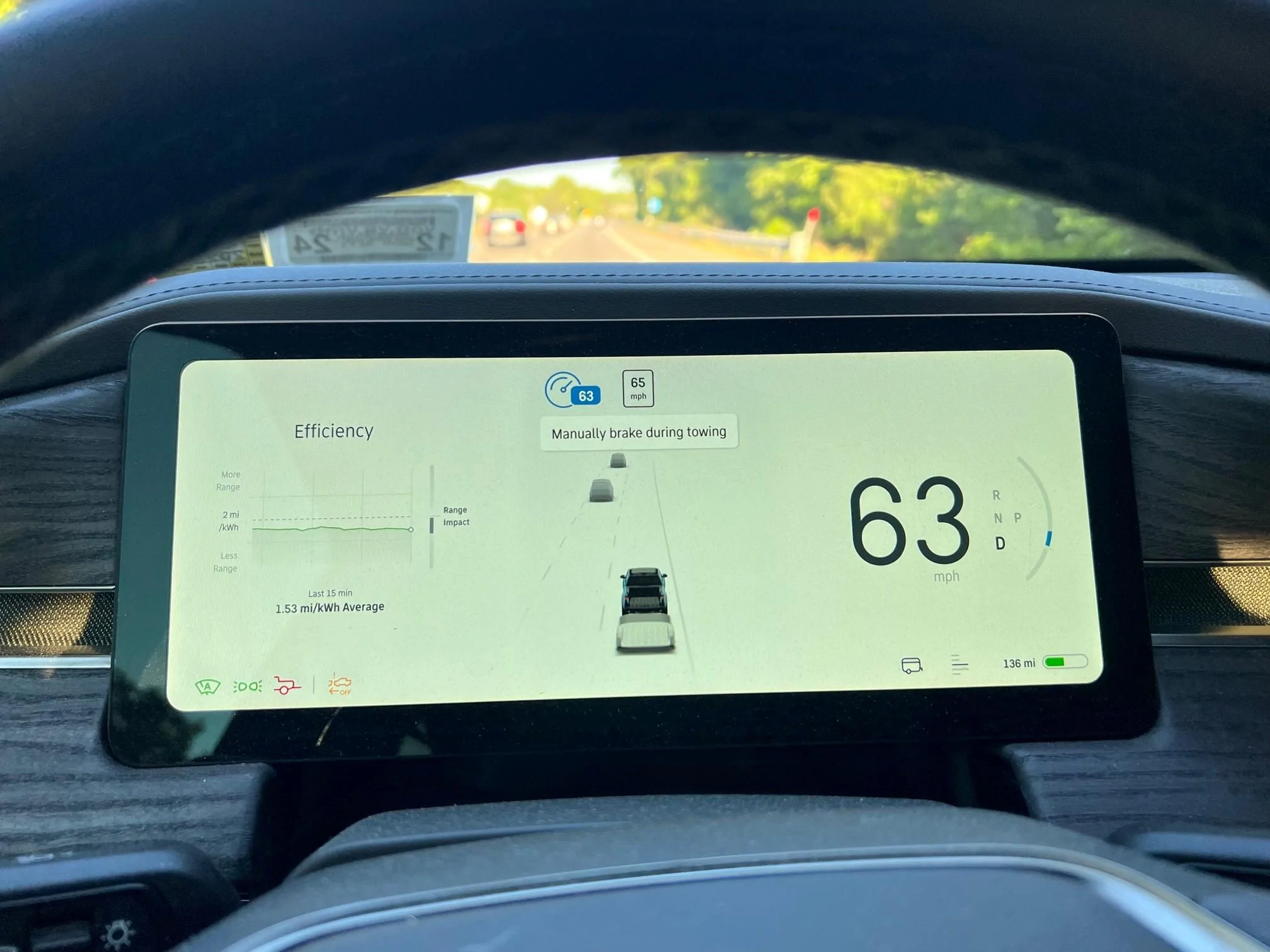

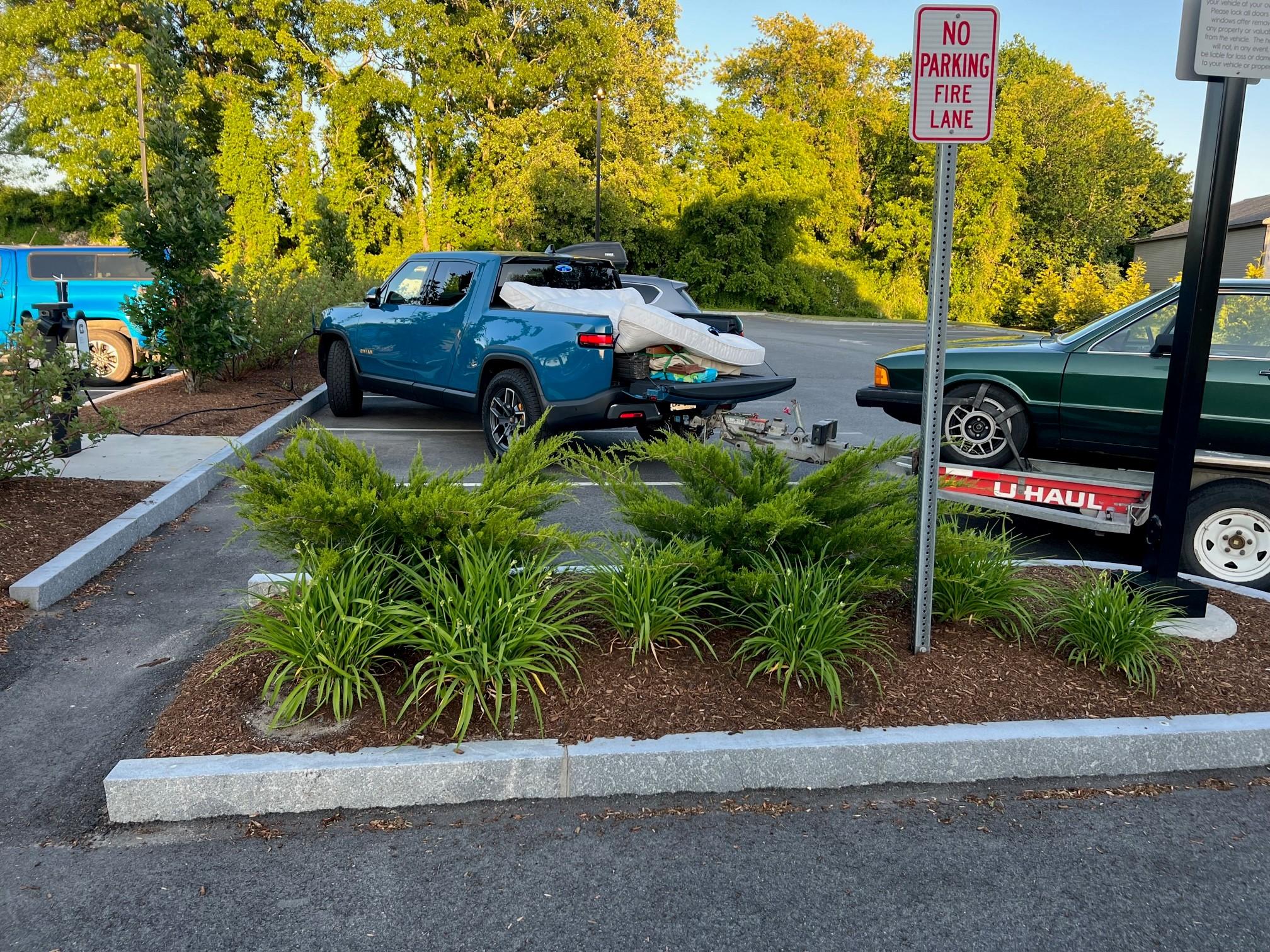

Thanks for the good report. Rather than start a new post I will share my recent first tow experience here. From Westchester County, NY to Danbury, CT to pick up a trailer and my 1980 VW Scirocco project car in storage up there and then to my house on Cape Cod. Started at 100% from my home charger drove 27 miles to get the trailer and the car, they had a combined weight of 4100 lbs (uhaul auto transporter is heavy!). Plan was to drive another 81 miles to EA station in Eastern CT and top up there (no issues thankfully and quick charge on 350kW to 80%). Then another 77 miles to the hotel in Westport MA - Marriott with free 6.6kw charger where the plan was to leave it on for 12 hours and head to the Cape the next day.
Here is where plan broke down - 1.5 hrs into the charge, somebody complained that I was taking multiple spots in the lot. Mind you I carefully located truck/trailer so that no other vehicles would be blocked in any way and without exaggeration there were like 50 empty spots in the lot. The nice young woman at the desk called our room and apologetically told me I need to move the truck to an overflow lot as technically there are not supposed to be trailers in the main lot. I could have taken trailer there and unhitched but I had the gate down since I was bringing a bed and mattress up there, so it was a tight fit for the trailer tongue under the open tailgate and I didn't want to deal with that in the AM with my wife. That and the overflow lot was desolate, two blocks away and anybody could have hitched to the trailer and made off with my car. When I got back from moving the truck she gave me a small bottle of champagne and two plastic flutes as she felt bad about it (said Rivian is her favorite vehicle just loves the R1S). I realized I was taking a risk planning on this overnight charge at the hotel and I paid for it.
Next drama - we needed to be at the Cape 73 miles away the next morning by 9AM sharp for an appointment we could not miss. I saw 105 miles estimated range and rolled dice. I drove 60 mph on cruise control and the estimated range dropped as we went - got to our town in the Cape with 15 miles left. In general my consumption ranged from a low of 1.25 miles/Kwh to a high of 1.50 miles/kwh. Aside from tesla stations, there is only one high speed DC charged on Cape Cod - in Hyannis 19 miles from my location. Ugh - my initial though of having 32 miles range to play with was suddenly too chancy for me so off to a 6.6kw charger at a technical college 4 miles away and a long lunch there to get enough in the tank to make me comfortable to get to Hyannis. All good in the end but yeah not a good long range tow vehicle I would hate to do 300+ miles with current infrastructure. Also I have the 20" ATs which doesn't help, I think the OP had 21s.
I agree that range issues aside, the R1T is a fantastic tow platform - I did not notice 4100 lbs back there at all. Felt like I could still drag race pickups without a trailer if I wanted to make a statement. Looking at EA fast charge rates of $0.30/kwh and current reg gas price here around $3.50 if I take the highest efficiency I averaged, it's like 17.5 mpg equivalent

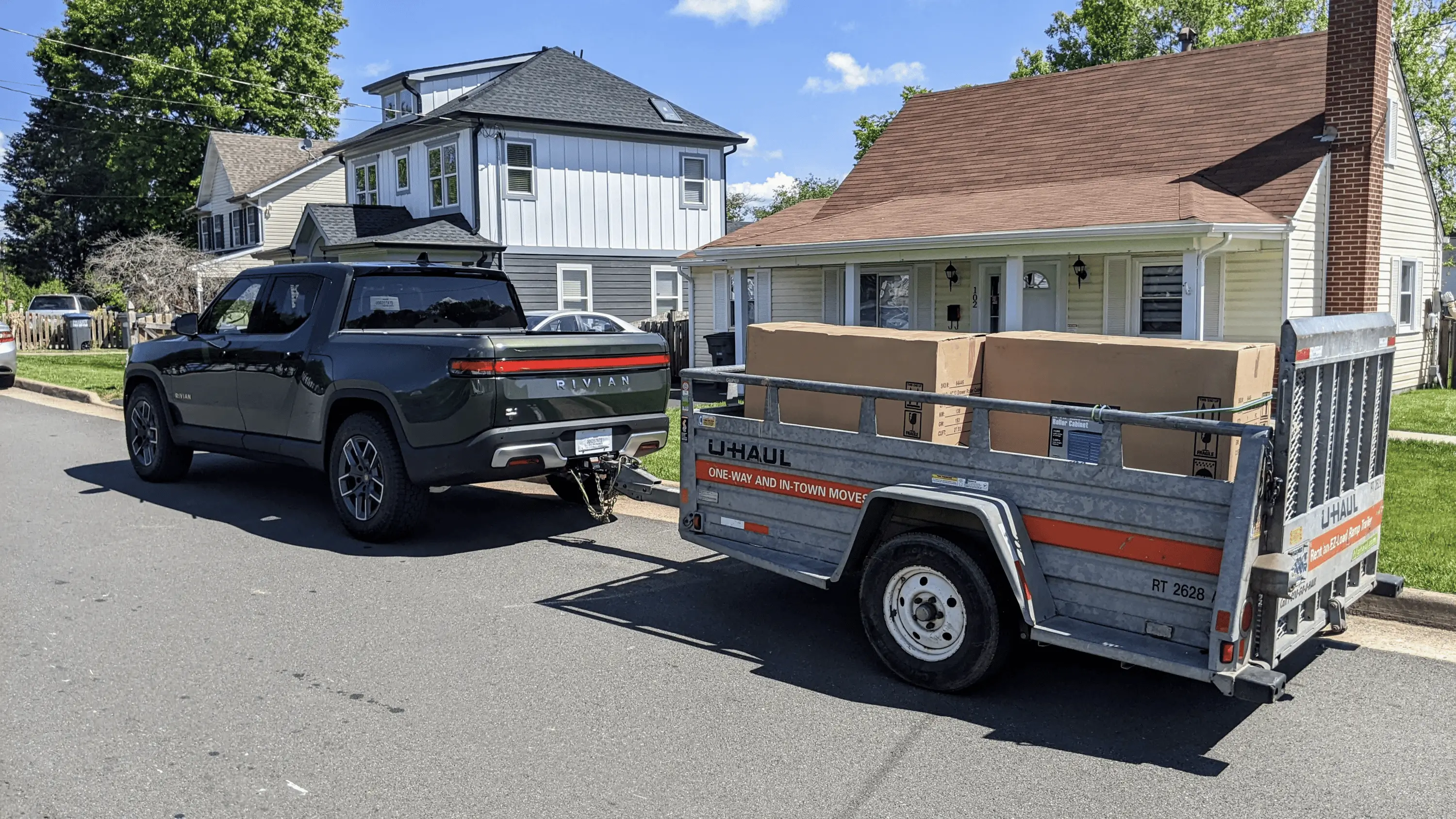

Excellent write-ups! Really enjoy reading people's posts about towing in this forum. As someone who hasn't (yet) towed more than a couple thousand pounds with the Riv, am taking note of your experiences for my own longer trips.
Here's my own biggest load so far - some new toolboxes for the shop, LOL. 😆
Haters gonna hate.
