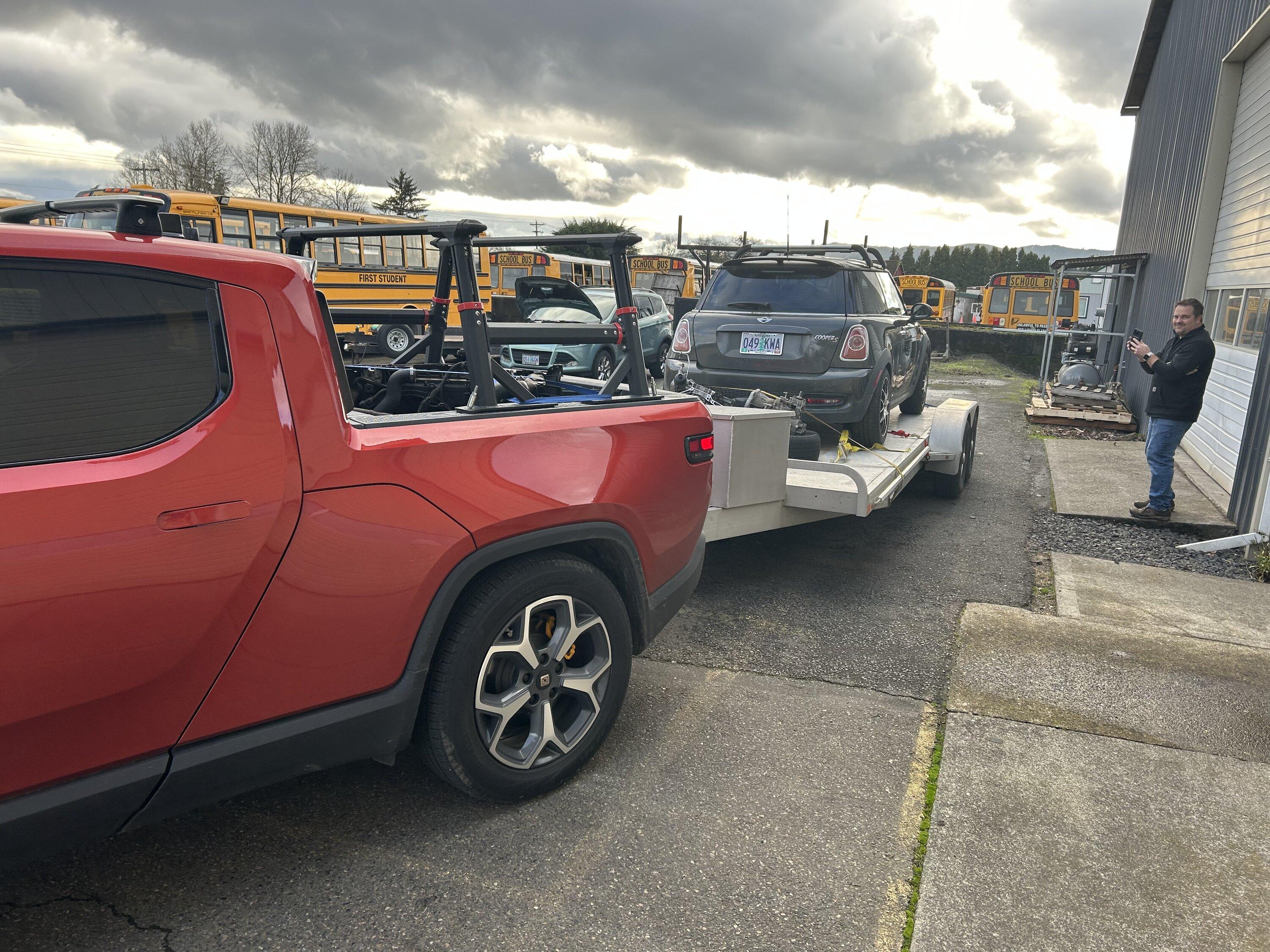

I have towed 2 vehicles with my truck. Once for 200 miles and once for 40 miles. With towing a vehicle that size you will experience a drop of about 35 percent. I went up over a small mountain pass with it also. Nice thing is the regen on the way back down.
I will say I find satisfaction in a crazy road trips with an EV. My son bought a Mini SE (95 mile range in winter) and drove it from Portland back to Salt Lake. So either way have fun with it. Make it an adventure. Let us know how it goes.
Note: this mini was not the SE
And I removed my racks for the longer trip for better aerodynamics

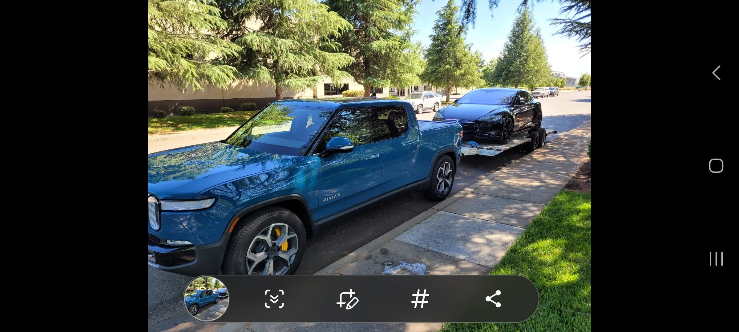

I lost about 25% range, but was towing my MS to it new owner :)
