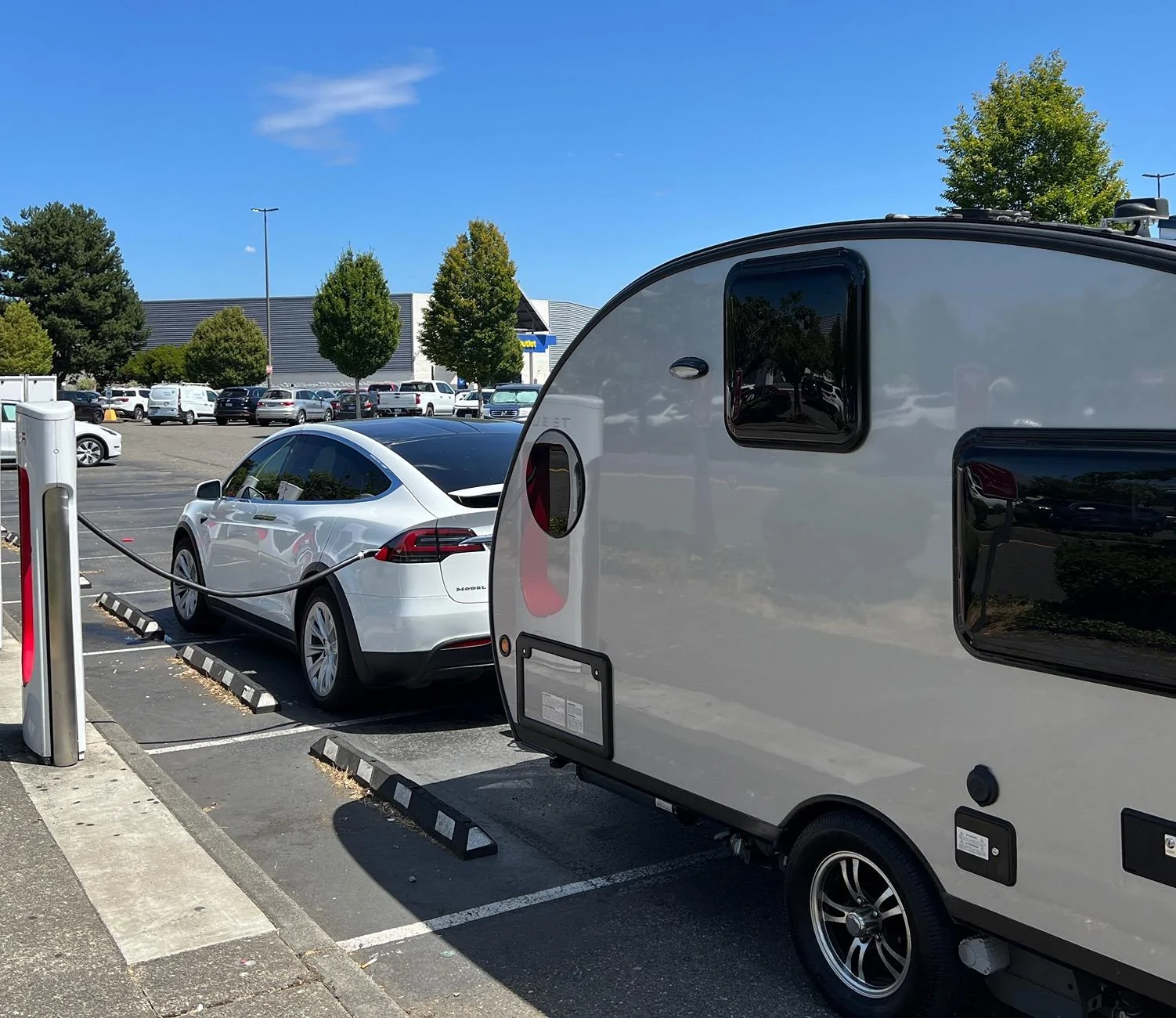

Introduction:
I’m new to this forum. Have owned only Teslas for the past 10 years; Roadster, Model S, currently a 2018 Model 3 and 2017 Model X 100D which I purchased specifically to tow a Safari Condo Alto F1743 trailer. It is 17 ft long, weighs about 2,200lb fully loaded, and has been extensively modified; added 600Ah of LiFePO batteries and 735W of solar panels among other changes.
I have towed the trailer for probably over 12,000 miles. The X hitch is only rated for 3,500 lbs but the car easily handles the relatively lightweight trailer and feels stable while towing; no surprise there since the car outweighs the trailer by much more than two to one.
When towing at 55mph on a level dry road with no headwind the car gets about 2m/kW which decreases to about 1.7m/kW at 60mph. For such a large EV the X is very energy efficient, getting about 3.2m/kW at 60mph when not towing . When new, my X showed 285 rated miles at 100% charge, it now shows 264 miles fully charged (7% decrease) and has 74K miles on the odometer. A new Model X is EPA rated at 330 miles.
I’ve been following Rivian for years now and have always been impressed by their vehicles, and the coming R2 and R3 vehicles are very compelling. The R1S is almost exactly the same length and width as the Model X but has more cargo capacity because of its squarer shape; the downside is that it is not as aerodynamic and therefore is not as energy efficient. But Rivian clearly puts more effort into towing capability and related features than Tesla ever has; for Tesla towing has always been an afterthought. People towing RVs is not their target market, but when I bought my X it was the only EV available that could tow.
Rivian Towing Advantages
This list also includes some non-towing features the R1S has that I find compelling and the Model X lacks. If I have made any factual errors please correct me.

Will the Rivian Max Pack Dual Motor give me significantly more towing range than my X100D?
This is a difficult question to answer but it’s a critical one for me. I have researched this forum to try to determine how the R1S Dual Motor energy usage compares to my Model X. It’s difficult because people post numbers but not for a fixed speed on a level dry road with no headwind, and of course tire size and type make a big difference as well. As near as I can tell, R1S energy usage is significantly higher than the Model X, perhaps by as much as 40%. However, there is another complicating factor in trying to compare towing range between the two vehicles; how their shape alters the air flow impacting the front of the trailer.
When towing at highway speeds the primary reason for increased energy usage is the increased aerodynamic drag of the trailer. A secondary effect is the rolling resistance of the two trailer tires; that predominates at speeds below about 35mph but is a minor factor at higher speeds. The larger frontal area of the taller R1S compared to the Model X, and its squarer rear end, may serve to more effectively channel air away from the front of the trailer, reducing the amount of additional energy the R1S uses while towing.
In other words, while the R1S baseline energy usage is higher than a Model X, when towing the R1S may show a smaller percentage increase in energy usage compared to a Tesla because of the different aerodynamics and that may result in an overall greater towing range with the R1S Dual Motor Max Pack compared to my 2017 Model X.
But there is no way to know for sure without a real world towing test with my trailer behind an R1S Dual Motor. If I get serious about replacing my Tesla with a Rivian I could ask my local Rivian showroom if that would be possible. It would be a very interesting test.

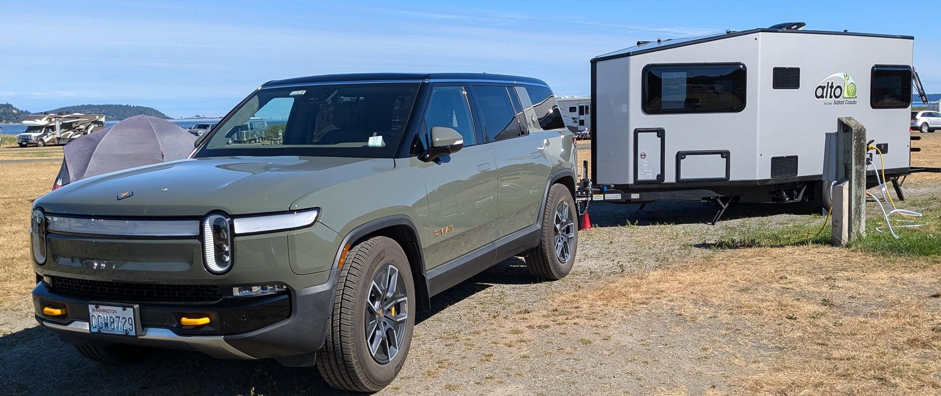

Hi EVTowing (nice to see you on these forums too),
Similar story here. We have owned all the Teslas, and my wife still has an X. We tow a Safari Condo Alto A2124 (different model than yours, but on the old forums we used to get pretty similar towing efficiency numbers IIRC). We used to tow it with a 2017 X 100D, but now we tow it with my 2023 R1S (quad, large battery).
The X (even our 2017, but more so for her 2023) was indeed notably more efficient when not towing, but as you suspect the percentage hit on the R1S when towing is lower than it was when towing with the X. Overall efficiency while towing was still better in the X...but range is still better with the R1S simply because it has a larger battery.
Another advantage to the R1S over the X: it's easier to hook up, because the towing bits aren't buried so far under the car. And I like that the R1S is heavier and has a larger towing capacity; the X's was sufficient, but now I don't feel bad about not having a weight-distributing hitch.
We've been getting about 1.5 mi/kWh towing the A2124 with the R1S (we got about 1.75 towing with the X). That's with speeds generally around 60mph. Another thread you might find useful is HERE.
