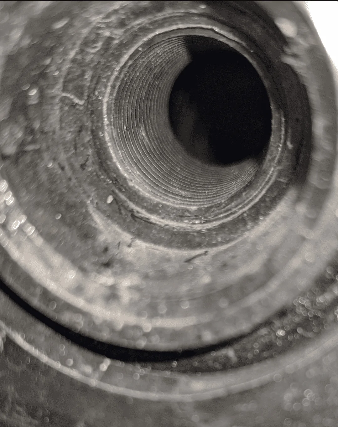

Does anyone know the size of the tow eye threads? Talking about the mostly useless one hidden behind the passenger tow hook rubber flaps. Investigating using it for a tie in point for an ORV flag. Looks like it is a Left Hand thread but I don't have a set of thread gauges to figure out the rest. Any help is appreciated!
Rivian R1T R1S Tow Eye Threads- Anyone know the size? Screenshot_20221114-113501
(I know it would be easier to have a U-bolt or pipe clamp solution as shown in the forums but I'd like something that is hidden and easier to remove since the first mount I bought was pretty loose and required shims/4 screws to attach. And always fun to have a little project.
Concept is to have 2 parts, the screw in part past the rubber flaps and the exterior part bent down and around the hook on the outside. Then join them in the middle with one bolt so I can connect/disconnect there.)

Per MI Service the thread pattern for the hidden tow eye is:
M22x2.5 LH, M22x2.5 "LH" 61.5mm thread depth from front face
Now to start my hunt for something that fits in that space...
