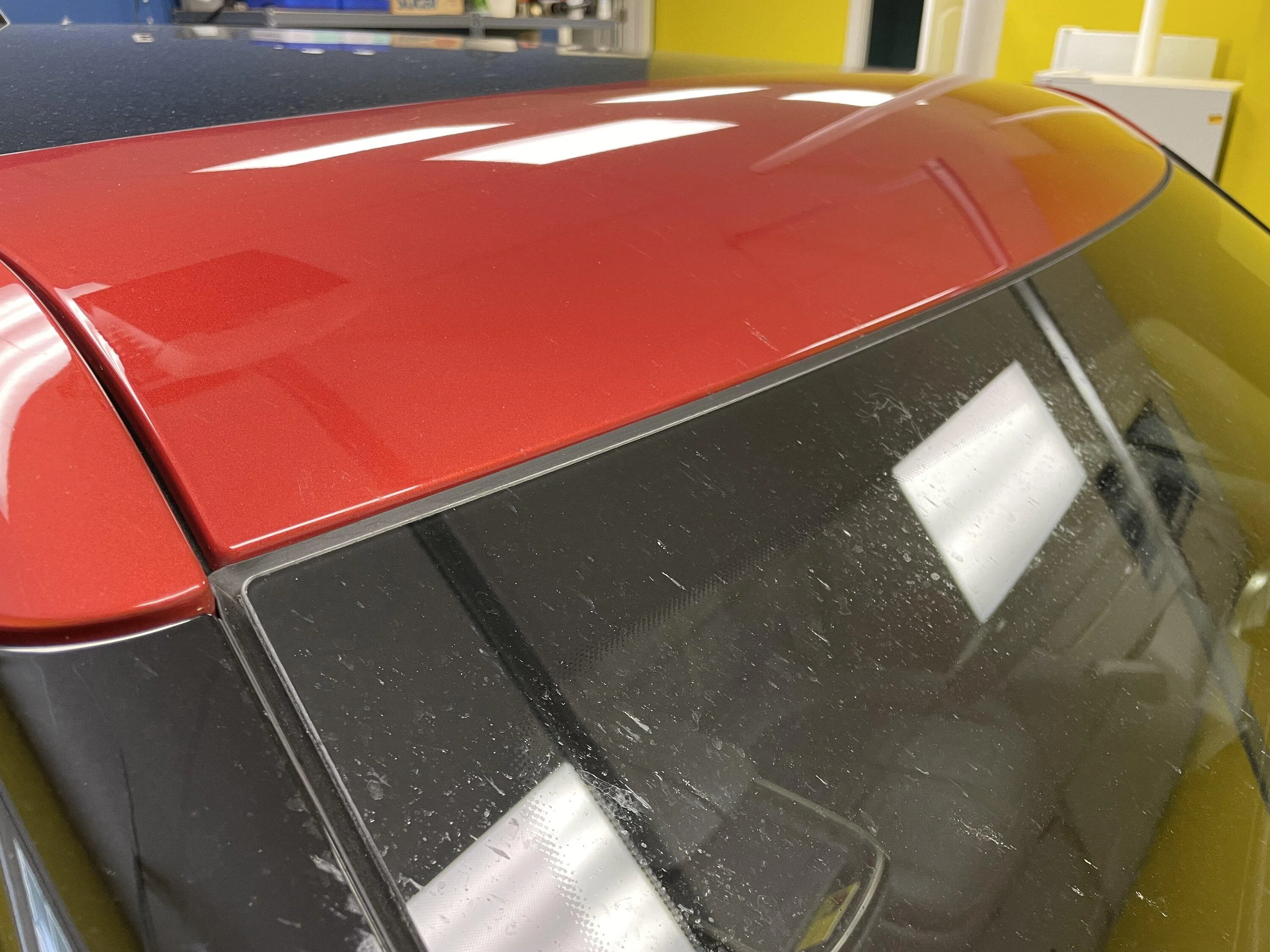

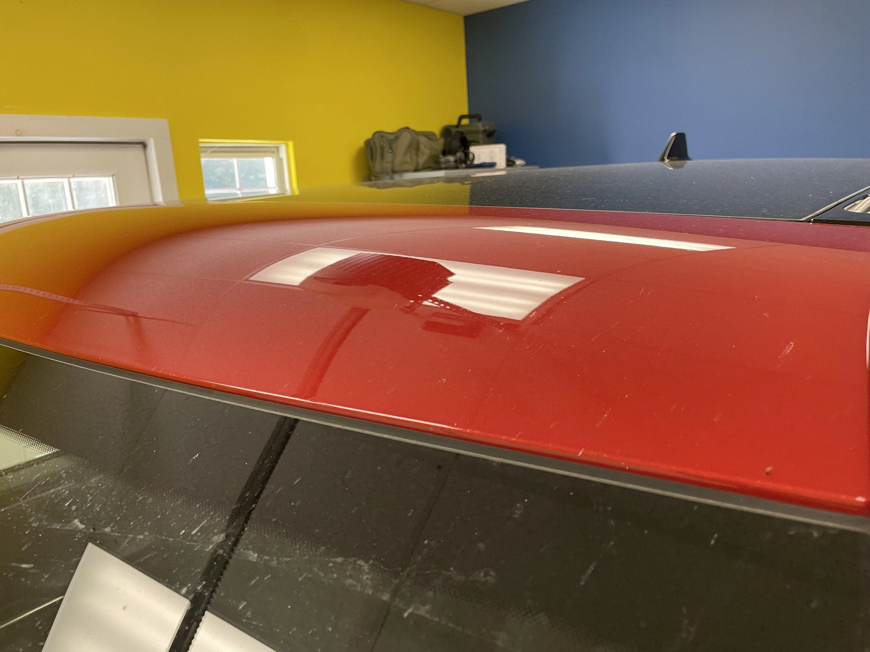

I've been experiencing what I believe to be more than expected wind noise at the top of my windshield at speeds above 60mph or so. Upon inspecting the truck, it seems like the gapping between the shield and the panel above isn't quite right and that it dips down at the top sides.
If you compare this to your truck, does it look normal? Any feedback here is really helpful as I think I'm going to log it into service.

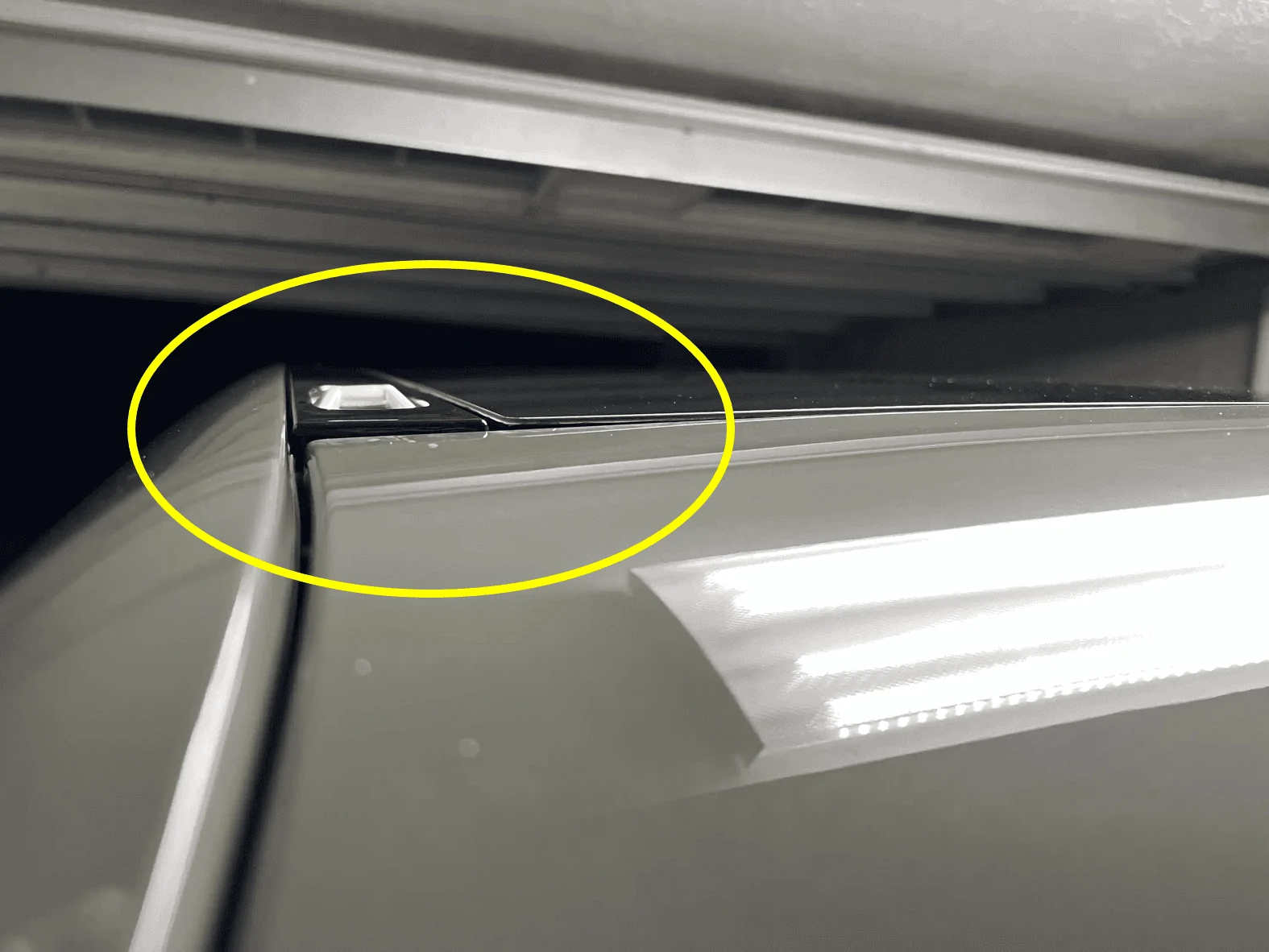

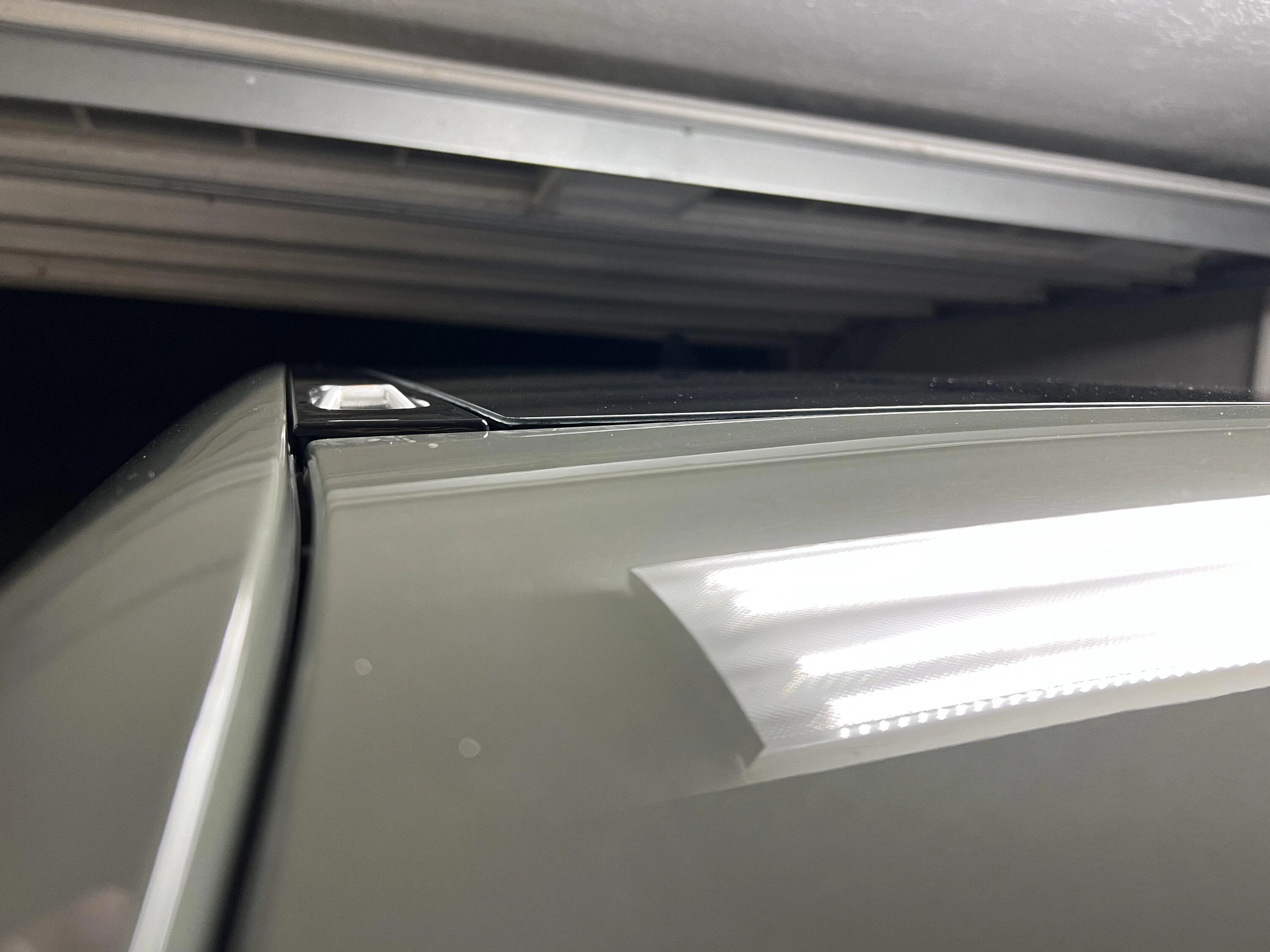

The "Applique" (other's terms not mine) - that is the painted piece between the windshield and the roof, has been installed incorrectly (my term) causing wind turbulence that you're hearing.
See this thread: https://www.rivianforums.com/forum/...anoramic-roof-cracked.7773/page-2#post-196341
My T has the same issue and should be getting serviced imminently. It's been reported here in other threads - most of the time the SCs remove the piece and then just re-bed it in the "glue" in the correct height/position. It's held in place by two fittings and quite literally glue - a bonding compound.
To test this - just use some tape to cover up the gap between the low piece pieces and the high pieces so wind travels more laminar and less turbulent. Then drive 70 and see if the wind noise goes away.

I think this is what it's supposed to look like, minus all the dead bugs. See how the rubber trim touches the painted body panel, that means it's quiet. My truck is the quietest vehicle I have ever owned, and that's saying something because I have an Audi with the privacy glass package which is also really quiet. To be fair they are pretty much identical with the Rivian having slightly better acoustics inside.

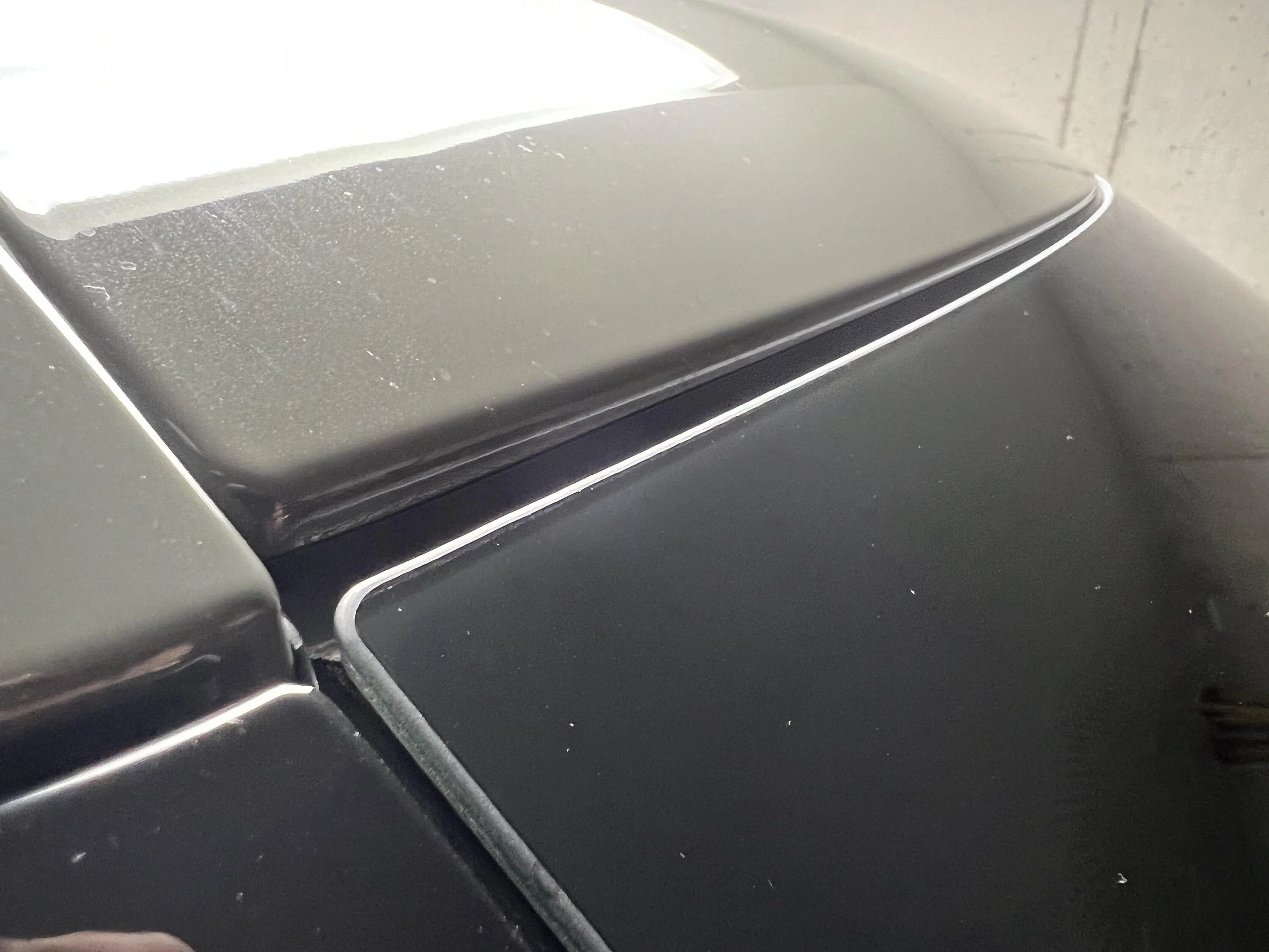

I wish mine looked like that - IMO the wind noise is more from the sides than the front windshield/applique' interface. It's where the windshield meets applique' meets roof panel meets top of door applique' meets load bar applique' and resultant uneven gaps.
But yes your front and back look great and are smooth transitions.
