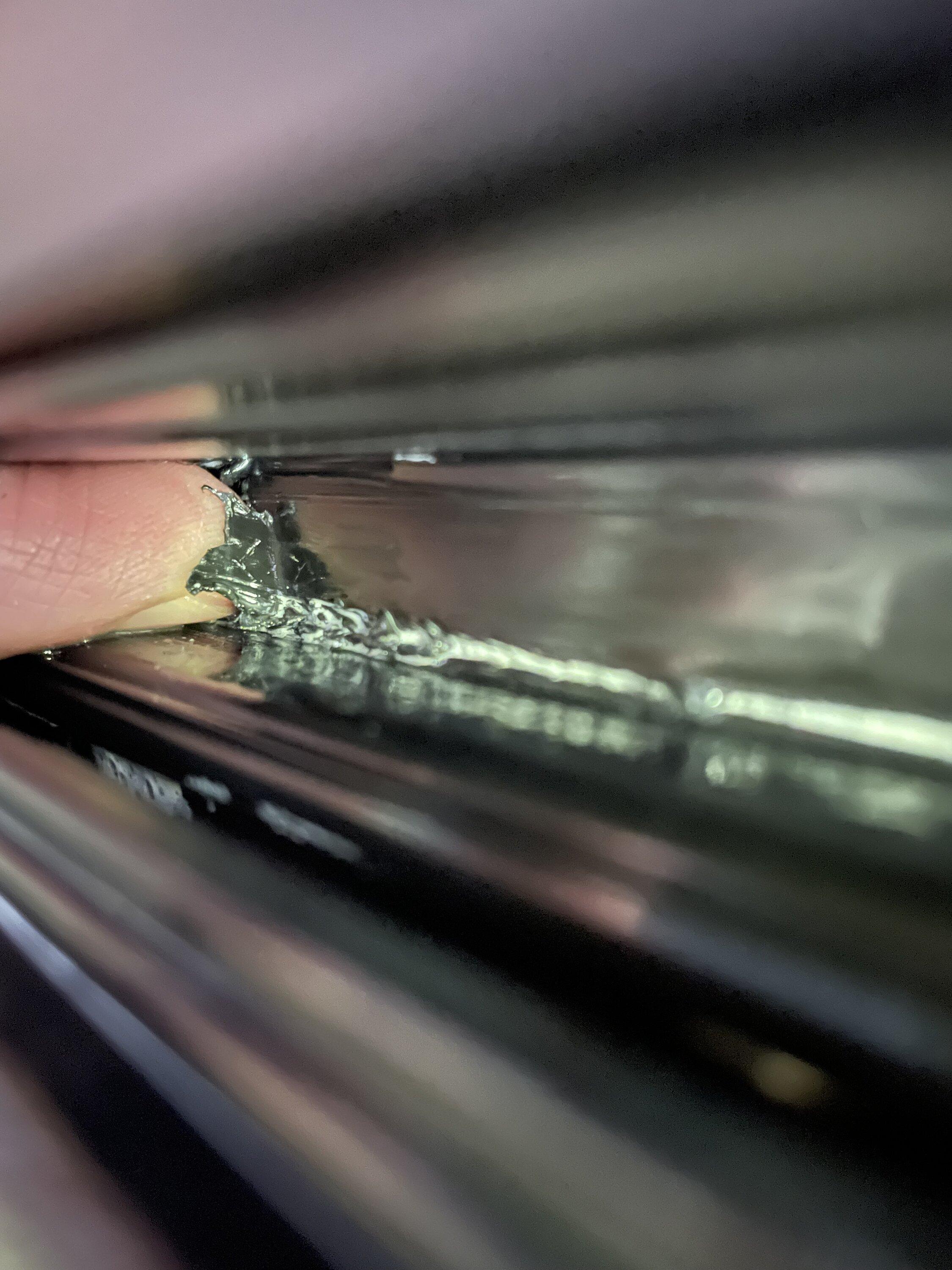

Well, got my truck back. The tonneau was open when I picked it up, because it had all my old wheels and tires in the bed, so I didn't get to test it. When I got home though...
First attempt to open it, only one slat came out. The rest just stayed in there. So I pushed that slat back towards the cabin, hit the button again, and it retracted back in as expected. Then I tried to close the cover again, it made two slats out, but the leading one caught on something in the track which caused the whole thing to go rather cockeyed. So now that's all stuck. I tried to retract the cover to the open position and everything's back in, except the leading edge slat, which is still crooked.
This is pretty frustrating, of course. I'm going to try and open this up and see if I can straighten out this stupid slat. Then perhaps I have to clean and lube the tracks before I try closing the cover
edit: I managed to open it all up, which was a bit of a pain. After a bunch of attempts, I actually got the leading slat properly connected to the other ones, and the entire cover closed fully, and then opened fully. The hardest part may have been putting everything back together again. Now I'm terrified to use it, but I'll go get some of that dry lube and really clean/lube the channels. It looks like the biggest issue was a slat just getting a little crooked and hanging up along the track

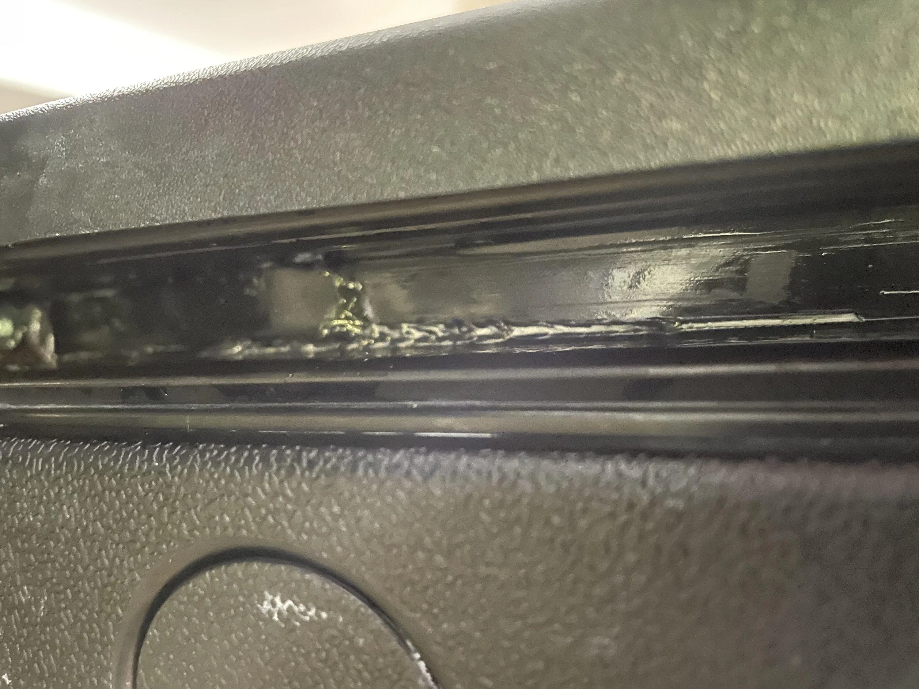

I didn't see the motors, but I feel like two motors won't change anything. The problem is with the tracks. And that all I said, I just got some dry lube and cleaned out my tracks to lube them up and noticed a problem. the outside wall of these tracks has a kind of slippery plastic in there. I can tell the goal here is to prevent binding of the slats if they get a little bit crooked, as they are wont to do.
Well, in mine, there's a tear in this plastic, not far from the cabin of the truck, and it's exactly where I saw it bind up when first trying to close the new cover they installed. It seems they replaced the cover and whatever parts of the mechanicals, but they left the tracks, and one is flawed. I've submitted a follow up service request and I am sure hoping they can send a mobile tech out here to address it, because that drive to/from my SC sucks something awful.
May be hard to tell where the torn plastic is in these pics, but note that my finger isn't really pressing on this plastic, it's just sticking out that much on its own.
