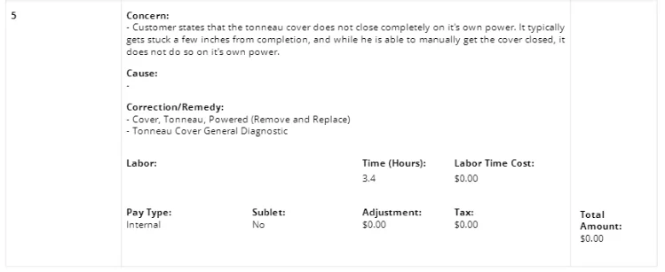

General consensus is that repairs to the tonneau aren't being scheduled until redesigned parts arrive in mid-August. I just got the call to schedule my appointment in 9/2 and indeed the work order specifies a remove and replace.

This is what my service order said for reference/comparison.

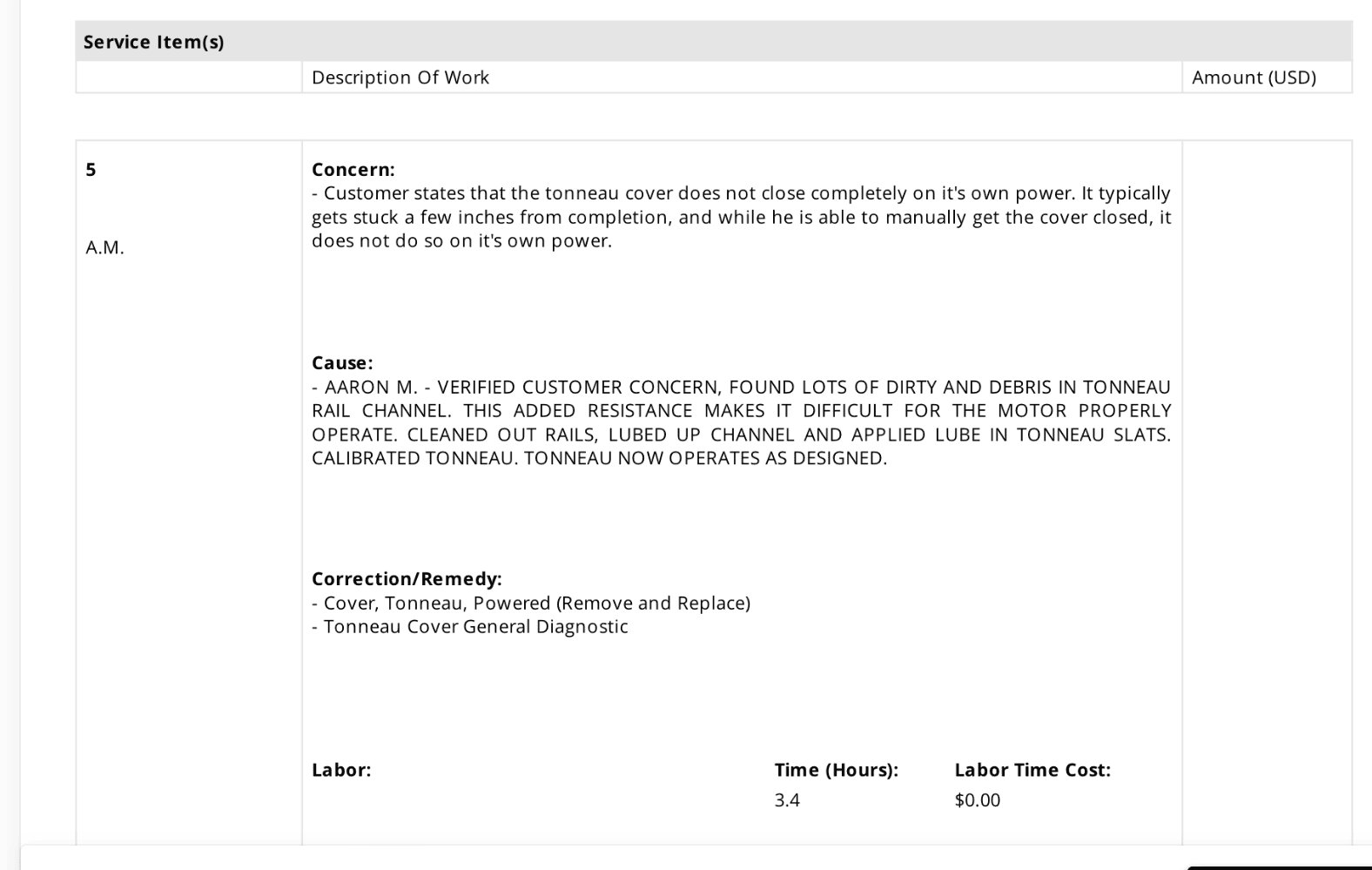

I had a ticket open for my tonneau not closing all the way (along with a few other nits) and was told they aren't doing any tonneau service until the new redesign is available. Like Josh I have to have the truck transported up to Bellevue because they need to check the alignment and my service date is 9/7

I just got the report on mine. They finished up with my service and are waiting on sorting out the logistics to send it back.
Doesn’t sound like any part changes on my cover.

And as a matter of fact, just got my truck back from service. The just lubed it and ran the calibration said it worked fine.
First test of the tonneau cover, doesn’t open completely and still closes then bounces back leaving a gap… sigh
