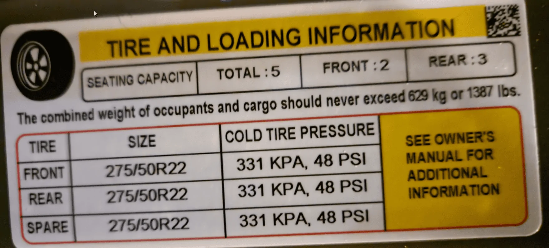

If you are not going off road, there are costs aside from the initial $. It does weight something and that has an impact on your load capacity and, to some extent, on your range. I have the full size spare (22") and the underbody shield. The theoretical load is, as I recall, 1760lbs. My sticker:
Rivian R1T R1S To Shield or Not to Shield? Option the Reinforced Underbody Shield? 1670136646827
Between the shield and the spare, I lost almost 400 lbs off the load capacity.
I got the shield because some boondock camping is in order...and better safe than sorry. Worth asking the question. Before I got mine (April 4, 2022), there weren't a lot of people with the experience to have an informed opinion.

I debated the off road Shield to many times and ultimately decided to not get it. The underbody shield weighs 140 lbs. I have the Adventurer with 22’s and the spare and my payload is 1,527. I know Rivian quotes 1760 ish lbs for payload but that must have been a theoretical Explorer model, which was never produced.
