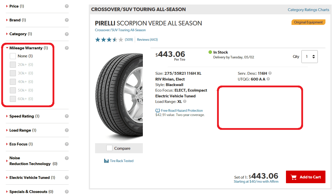

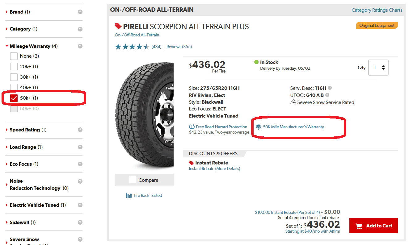

Well, at least your future new tires should come with some sort of tread wear warranty, looks like it will be needed too o_O
Odd.. if you look at the 20"s on Tire Rack they come with a 50K/unlimited time mi tread wear warranty, if you look at the 21's... there is no tread wear warranty?
