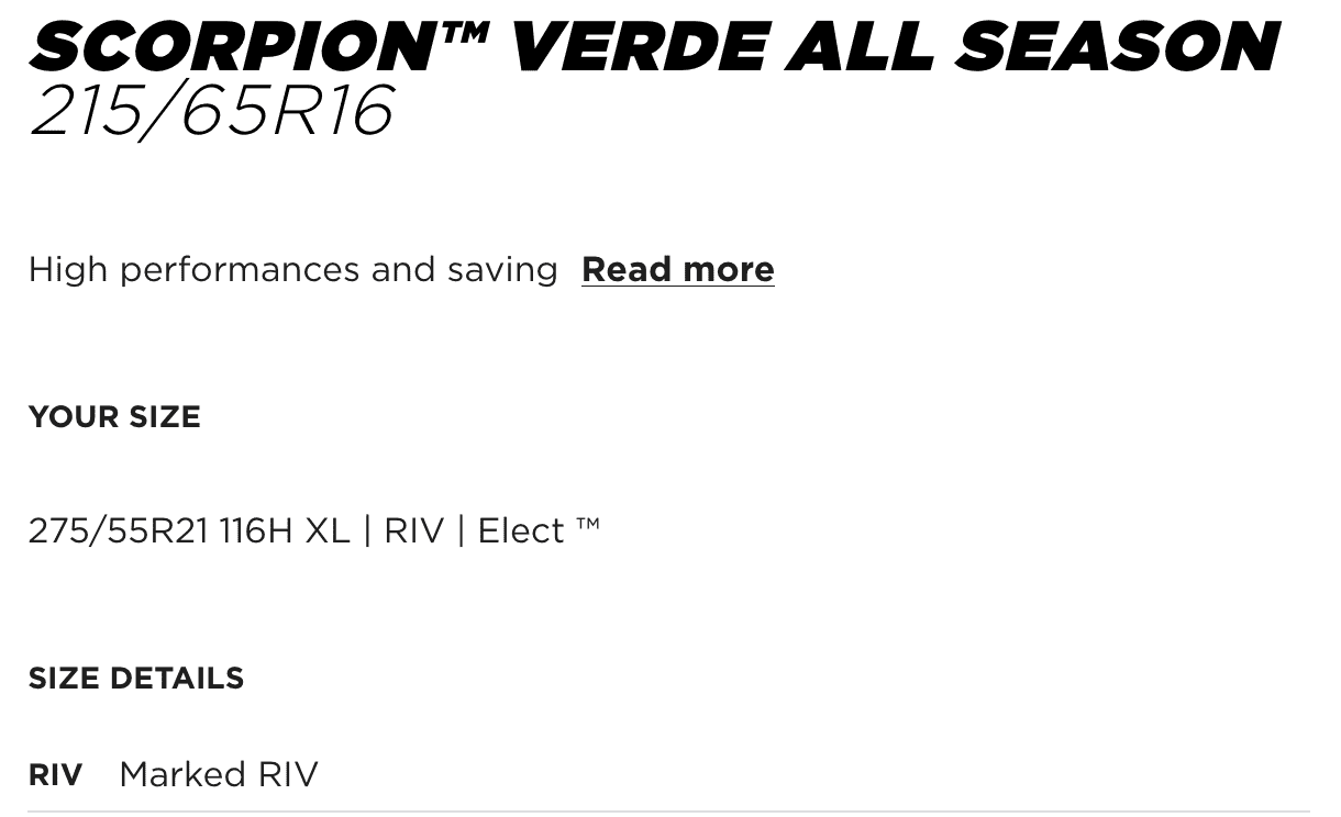

There's something everyone considering an alternate tire needs to be aware of, but I have not seen it discussed in any thread. Wait for it.....
LOAD RANGE RATING
We know the RIvian is a heavy vehicle, in excess of 6,000 pounds curb weight, and has a significant towing tongue weight (I think I saw over 1,000 lbs for the R1T). Load Range Rating matters.
As an example, the RIV rated Pirelli Scorpion Verde All Season 275/55R21 is load range 115H, accrding to the Pirelli web site. That's 2679 lbs load capacity. Conversely, if you search up a similar tire sized for the Range Rover Discovery, it's 110W which is 2337 lbs.
Why should you care? If you are loading up and towing a trailer, it makes a difference in both handling and safety. The properly rated tires will be stiffer, which improves handling when heavily loaded, as well as not overheating the tire, due to excessive sidewall flexing under the heavy load, and that is also a factor in range.
You might be able to find a load range 100 tire (1764 lbs) that would fit a Rivian wheel, but that would be really dangerous - 7000 lbs load capacity on a vehicle with a curb weight over 6000 pounds? With 4 adults in the vehicle, you are close to, or over the limit. That's a blowout waiting to happen, and your range would suck, because significant energy will be lost as heat in the tire flexing as it rotates.
LOAD RANGE RATING
Excellent point. I haven’t shopped for different tires recently but I remember that was a critical consideration when I did.

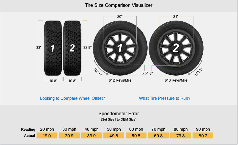

275/60R20 works out to 33" OD, which is very close to the 32.9" OD of the factory 21" option (275/55R21). It's just 1 extra revolution per mile:
Exactly. Is tire diameter/size user-configurable though? I'd likely run that size in a street tire on a 20" wheel. That's the same size I used to run on my Silverado (lowered 2wd) with performance summer tires, and handling was improved night and day over all-seasons.
I'd still like to swap to a larger off-road tire and just change settings on the main screen.
Heck, maybe they've integrated the GPS with the settings so it auto-detects and auto-corrects the speedometer.
