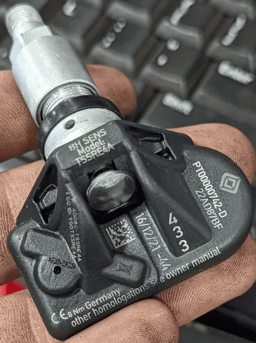

My tire guy says he thinks they are HUF sensors. He's planning to use a DILL 1096 rebuilt kit when he swaps the sensors to the new wheels. We are mounting a new set of tires and moving the original sensors to the new wheels. I'll ask him to take a pic of the sensors before installing them.

Thanks that would be super helpful.

I ended up getting 4 new sensors from Rivian with extra set of 20” wheels they sold me. They were not cheap at about $70 / each but the paired right up with the truck immediately and work with no issues
