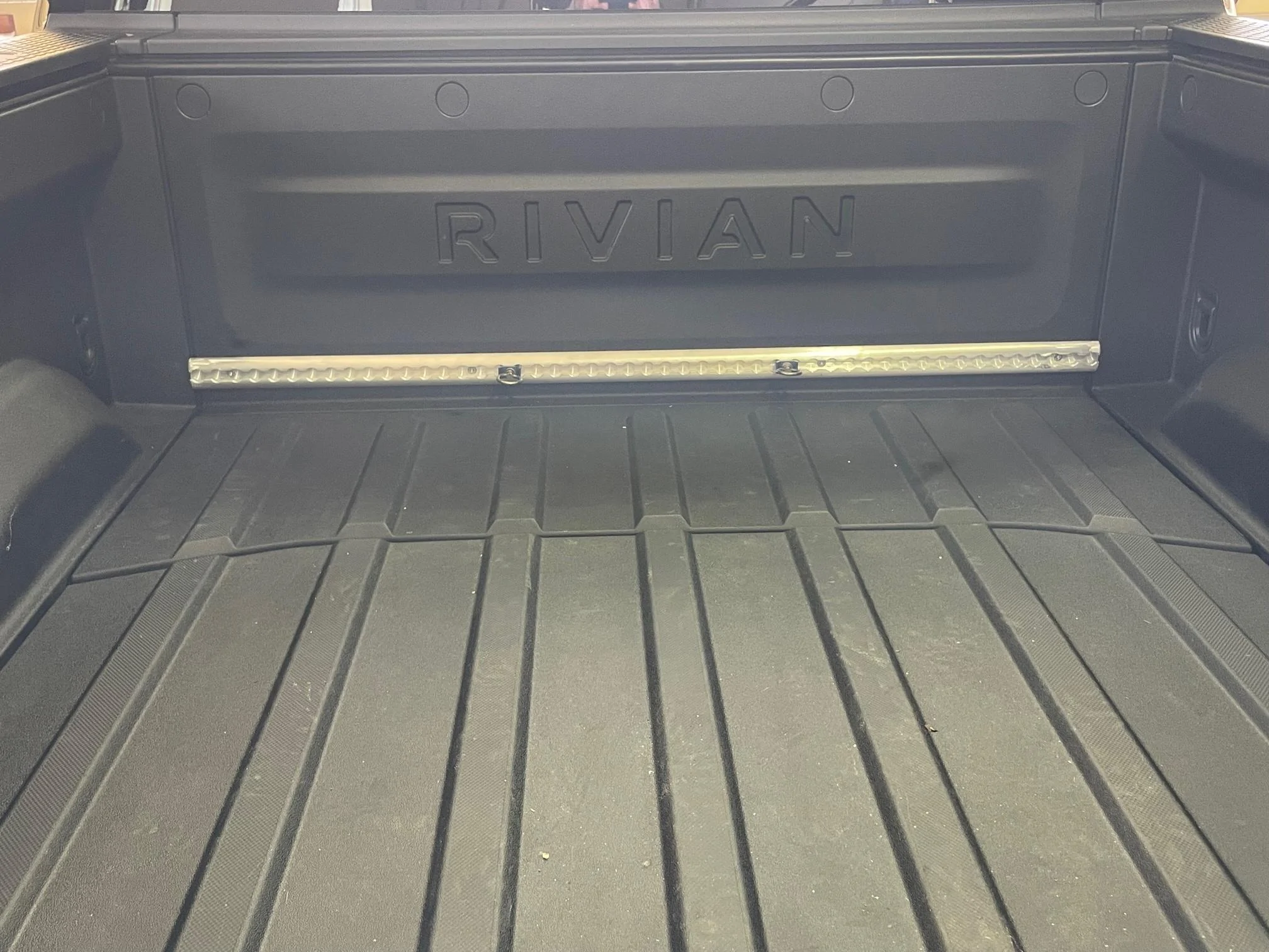

I needed additional tie-down anchor points in the bed. Haven't seen any great solutions so I came up with my own. Mounted wide contour L track to the existing bolt locations in the bed. The wide contour track is just wide enough to cover the holes in the plastic bed liner. No more threading tie down straps through the wheels of my dirt bikes and fat tire ebikes.

Nice. Got a link to the track you used?

https://www.macscustomtiedowns.com/collections/track
They make the best tie downs available. I don't work for them-just a customer. But, I've thrown out all my old tie down straps after buying several kits from Mac's.

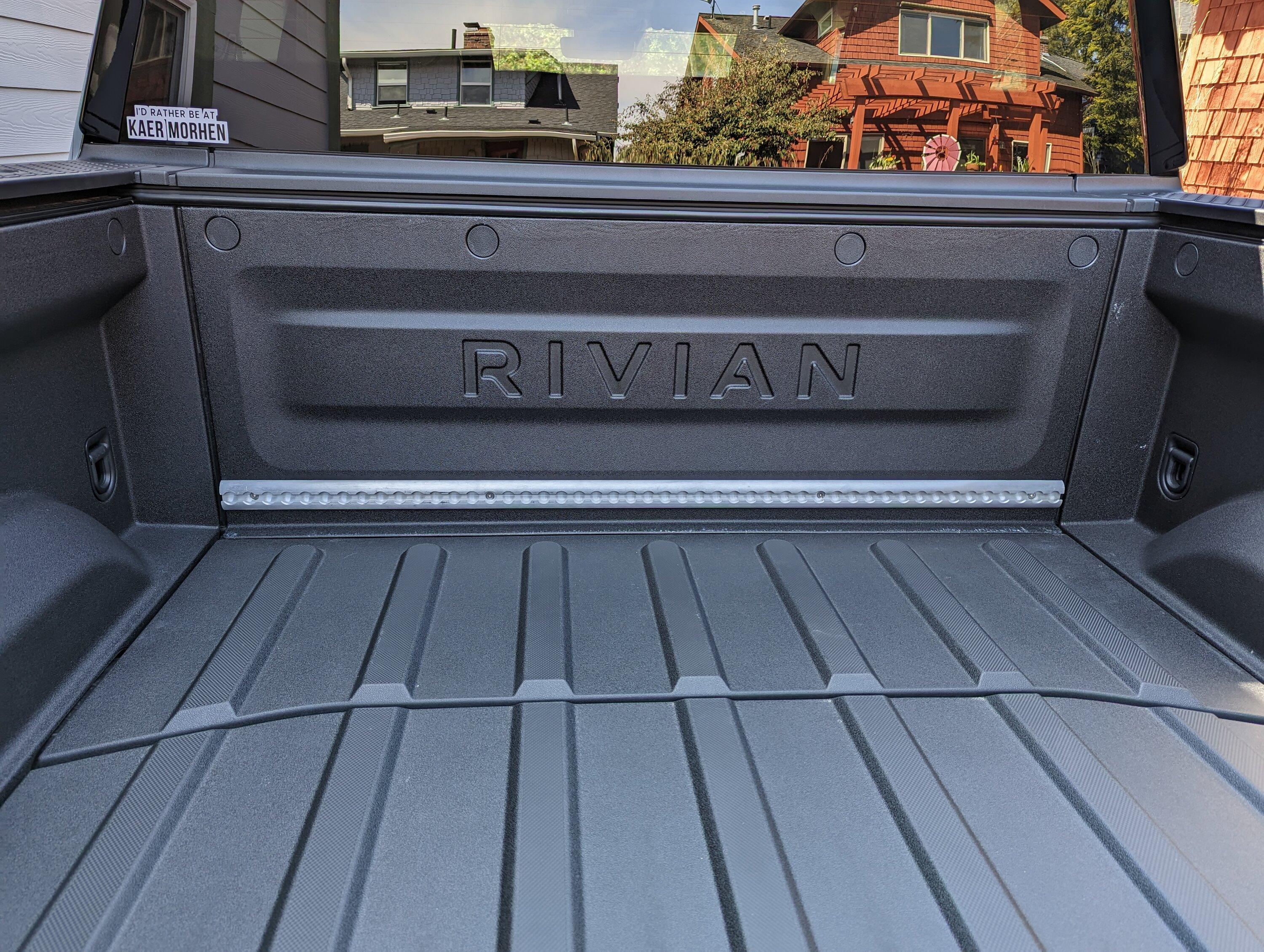

Thanks for the info on Mac's.
I did the same mod over the weekend and I love it.
