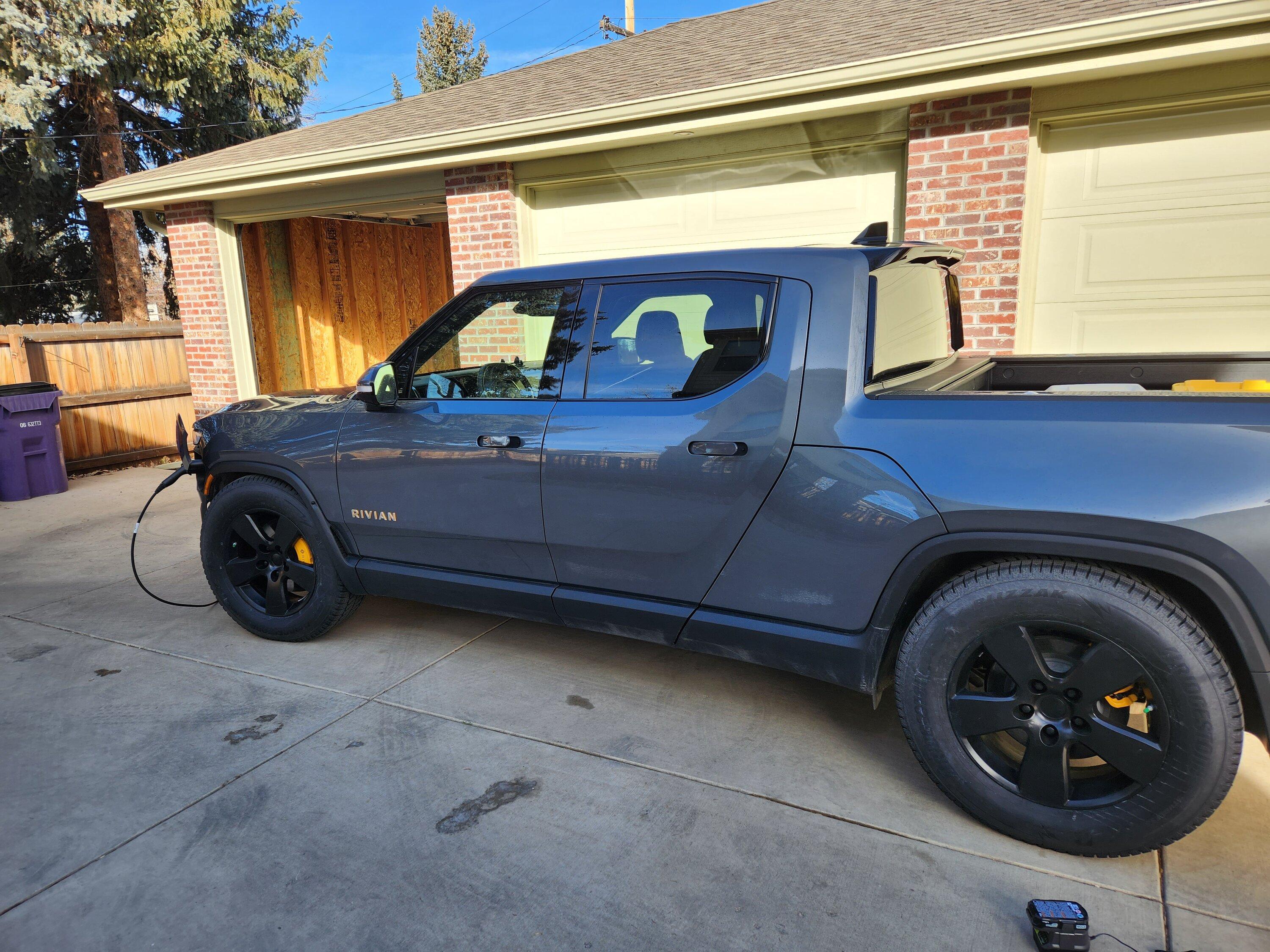

2600 miles from Denver to MI with my r1t.
I've already driven 4k miles prior to the trip, and prior to this had no material issues. My setup is 20" aftermarket ram 1500 wheels with a +18 offset that poke out an inch with blizzak winter tires. Oem setup is 21". Drove both ways entirely on conserve with cabin temp around 70 degrees
Software Version 2022.47.0
Rivian R1T R1S The good, the bad, the ugly - 2,600 mile round trip Denver to Michigan in the R1T 20221220_114008
We left during the coldest part of the week on 12/20 and stopped overnight and started again on the 21st. Temperatures were in the single digits on the way to Michigan and in the 40 to 50s on the way back. Both ways we had a head wind which also impacted range.

1) wheel/tire choice. Wheel pokes out an inch, my setup is heavier than 21" oem and winter tires

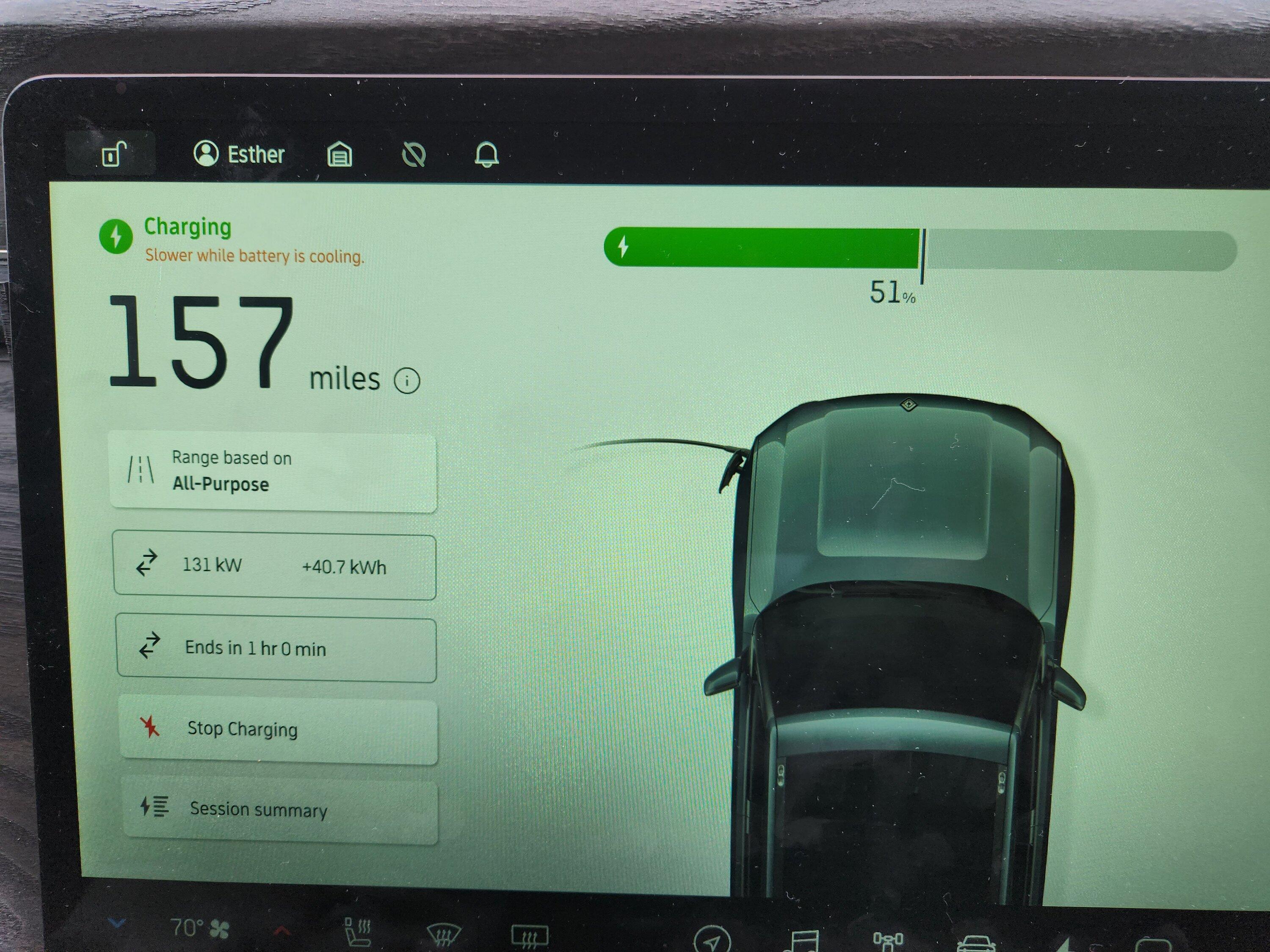

2) charger speed slow "charging slowing while battery cooling down". We got this error both when the Temps were in the single digits and also when it was 50 and sunny. We would be at 200kwh and it'd drop to 125 or even 80kwh. This would happen after 10 to 15 mins of charging and wouldn't go away when we were dcfc.
Regarding this. It is normal, the battery can only charge at >200kW for so long before it overheats and the external temp doesn't matter as much as you'd think.

The slower charging while the battery is cooling is not an error. This is a built in measure to protect the battery pack.
