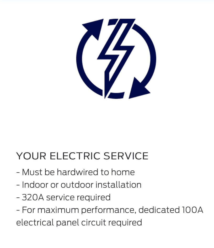

Sadly for V2H with the F-150 Lighting you'll need 400A service to your house. That kills it for me.
Curious where you saw that spec as 400 amp service in residential is not very common in most places.
My understanding is it reverse feeds back through the 80 amp charger and allows 9.6 kw power source. It would require more wiring and an auto disconnect from the grid but not sure why it would require a 400 amp service.

Wow, that will certainly reduce the number of people setting that up.
Exactly - They mean minimum or to be assumed 400A!
Very limited in my experience. I was a residential electrician for 6 years. The company I worked for did 90% new construction. I think in that time frame I worked on at most 5 houses with 400 amp services.
I don't know when that original screenshot was taken, but the website no longer says that... which is good because it made no sense. The website now only states that a 100A dedicated circuit is required which is what you'd expect. This is standard stuff. You don't a need special service entrance to have a generator panel.
There is no real & logical support for even the 320A requirement they had on their website, and it's now been removed.
You don't even need an 80A circuit to the Charge Station Pro unless you want to charge at peak speeds; it can be dialed down for smaller circuits.
The DC for V2H simply passes through the EVSE on its own wiring (separate from AC circuit coming in) & goes to into their Home Integration inverter.
