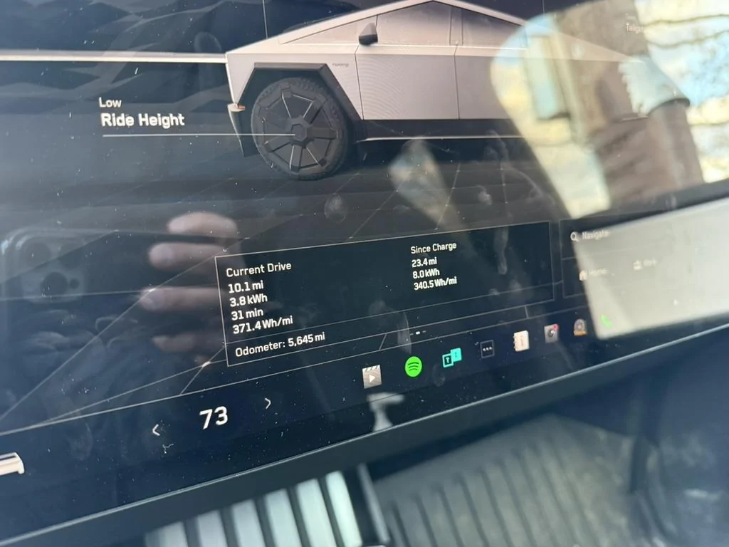

For reference, I went out and back repeating about 11+ miles of my journey with my aerodynamic triangle (Cybertruck AWD) running on 35" all terrains a few hours later, same ambient temps and NO pre-conditioning and averaged 2.93 mi/kwh. See the 'Since Charge' column.
Shouldn't the R1S Dual be more efficient with EPA range of 330 mi on a 109 kwh pack vs. 318 mi of EPA range on my Cybertruck with its 123 kwh pack?
Something is fishy...
