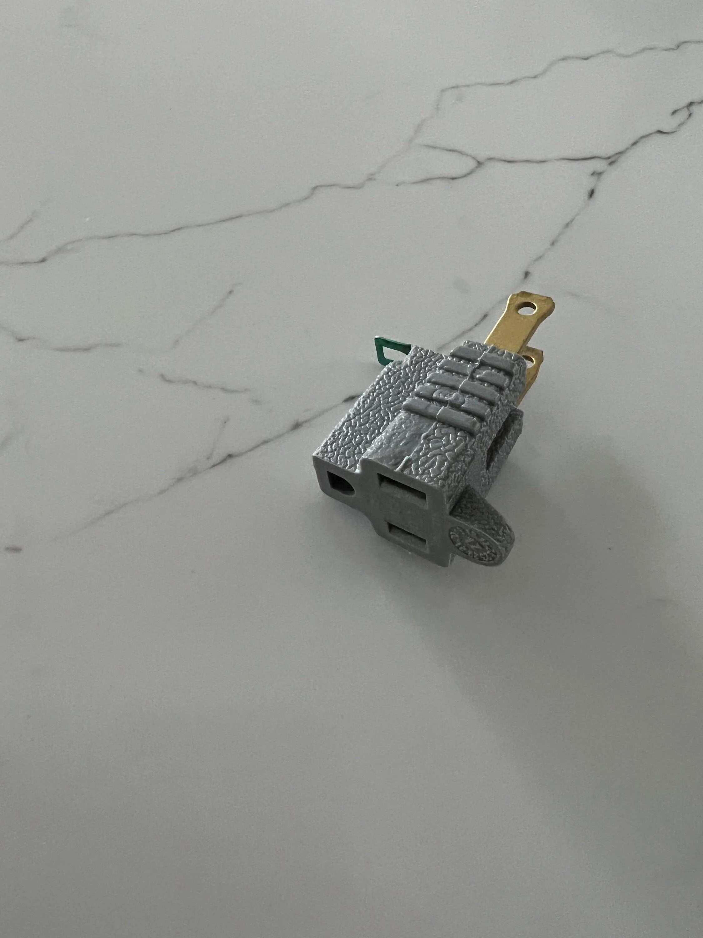

For fun this morning I wanted to try and repeat this backup power attempt. Since I sold my adventure van and and no longer have my Goal Zero Yeti power system.
I plugged one of the below pictured dongles and it indeed works to attach the Rivian to my transfer switch. I guess there may be a reason it isn’t safe but I‘m not sure what it would be since both the truck and the switch are still grounded but I’m not sure??
Anyway this also seems to confirm the issue is a ground loop with the truck.
I measured with a meter a little while back, ground measured 60V from neutral. Perfectly floating between the middle of neutral and hot. I'm not sure if there is a way to bond it to neutral in the truck, because using a bonding plug and nothing else plugged in causes mine to trip out right away.
There are seven pages on this thread and I am too lazy to read them all. I don't get power failures that often and don't mind using an extension cord directly to my fridge or router when I do (30 feet away). Can you save me some time and tell me which one of the following is true?
  • I can directly plug into R1 using extension cord?
  • I have to use what you used to isolate the ground?
  • There is no safe way to do it for the fridge or router?
Fair enough, these threads tend to drift pretty quickly.
  • You can plug an extension cord into the truck and power a fridge or a router directly plugged into a power strip then into the truck
  • In the above setup you should not need to isolate the ground in fact you wouldn't want to
  • No reason it wouldn't be safe AFAIK
The issue I had is that I have a transfer switch that connects to the ground for my house and then the Rivian has it's own ground, as I understand this creates a ground loop when I plug the extension cord into the truck then into the transfer switch
