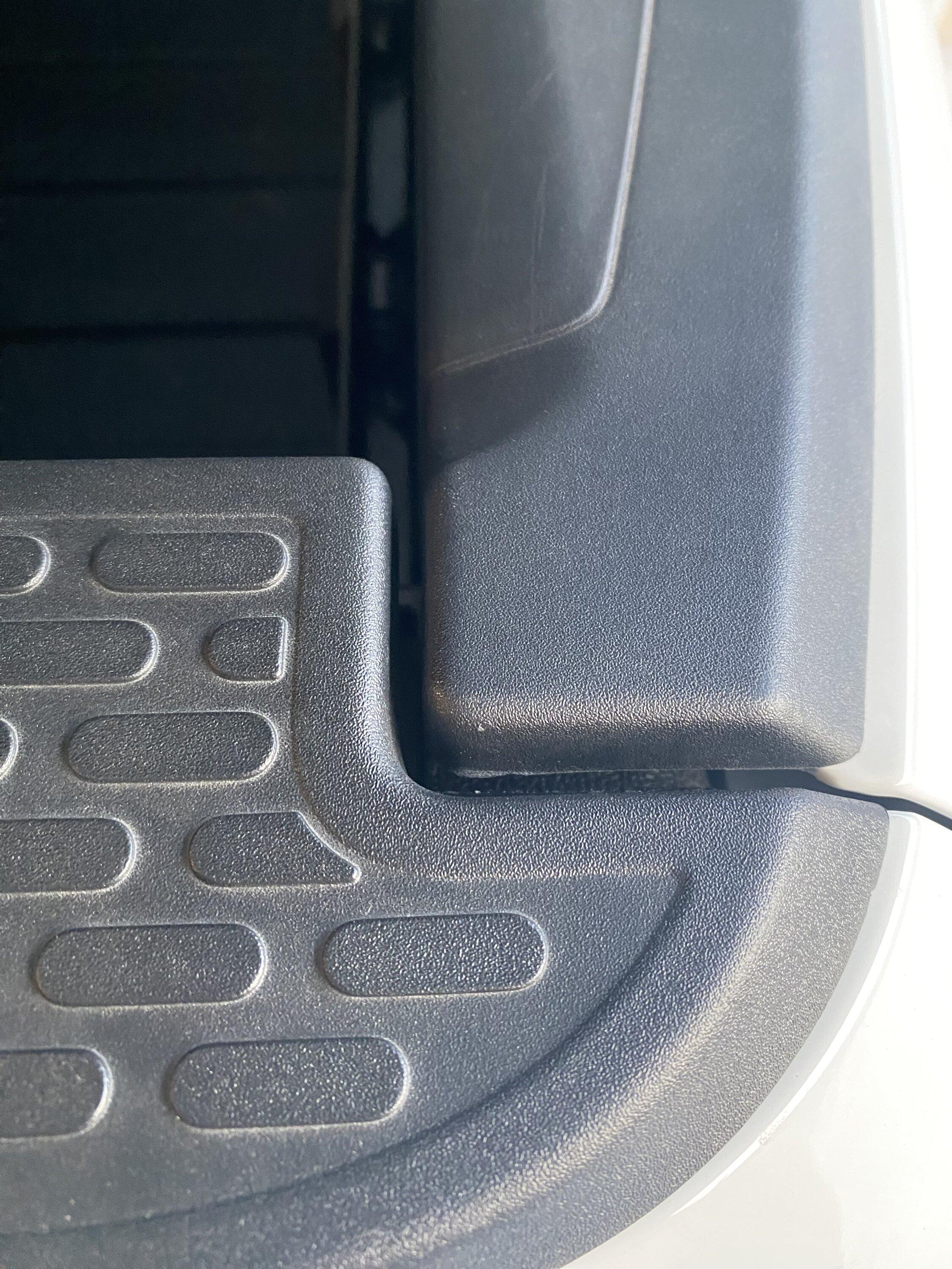

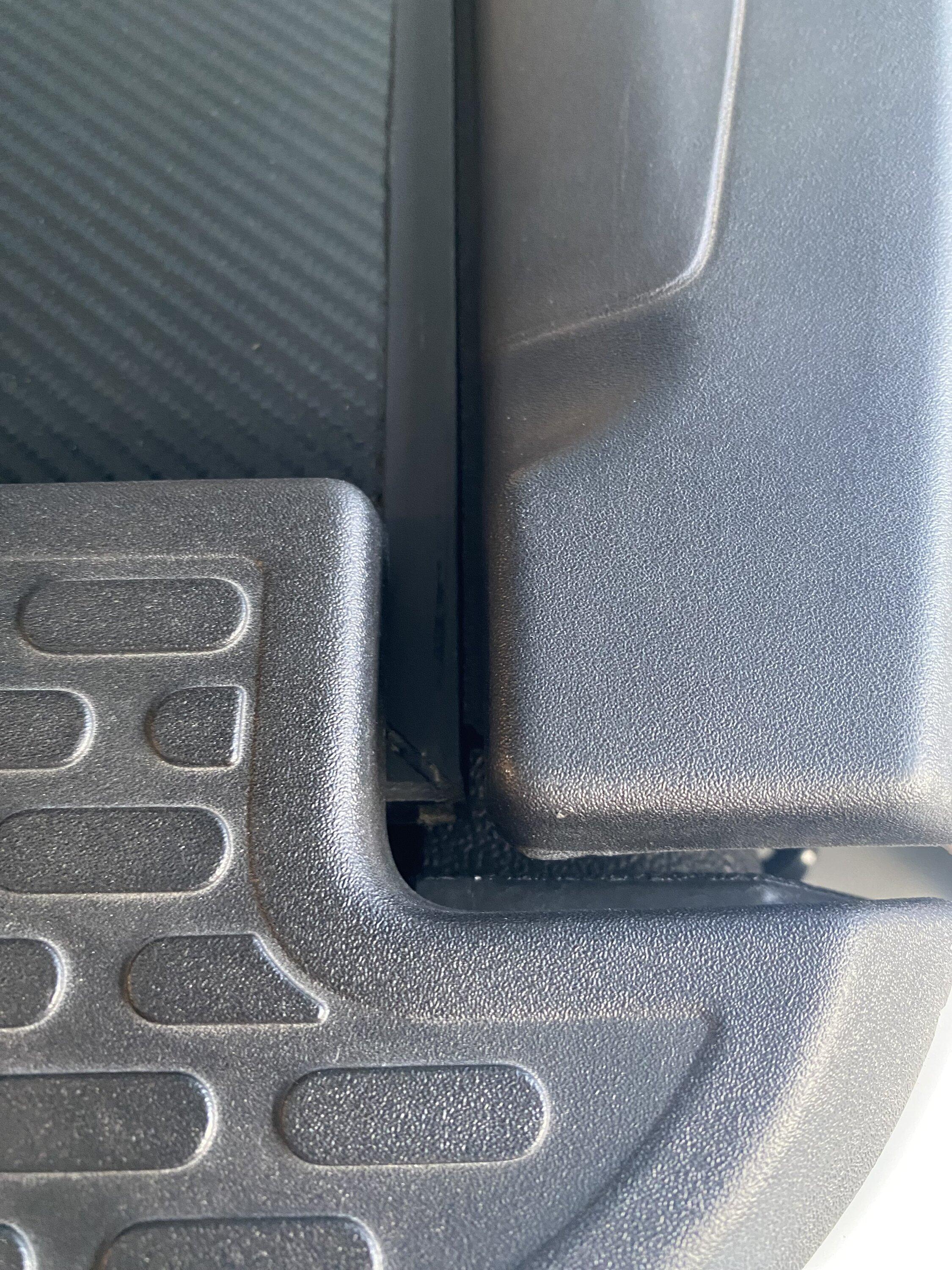

I got mine yesterday. Looks great! Super tight fit. Took some encouragement to get the pieces to slide through the channel.
only issue im
Having is they seem to be a little too big. The tail gate sensor is saying the tailgate is open and I can’t slam it hard enough to show otherwise. If I take the last piece out shuts no problem.
I reached out to the company and hoping for a quick easy fix. I’m thinking if they just ship me 1 new panel that’s a tad smaller would solve the issue.
pics attached of tailgate shut with and without the cover so you can see the gap is larger with the cover.

i had the same problem so I removed the insulation strip closest to the tailgate and now the tailgate closes with no problem and after several car washes no water intrusion.

Okay maybe I will try that. I am talking to the company now and working through some possible solutions but so far no luck.
This, if it works, sounds much easier than dealing with a new panel etc and cost savings for the company.

I tried this out and still no luck. I may have to take another foam piece off another panel. Not sure how well it will hold up without it though so nervous to remove more.

Had the Same Problem, I reached out to the company and they responded quickly saying to make sure that you close it pretty hard, and that should do it as the piece against the cab needs to push into the space between the top plate and the weather sealing where the powered tonneau would go.
It took me a couple tries and yeah you really need to give it a hard close, but once it finds its place its easy to close afterwards. Make sure to have all the weather strips facing the back of the truck too.
