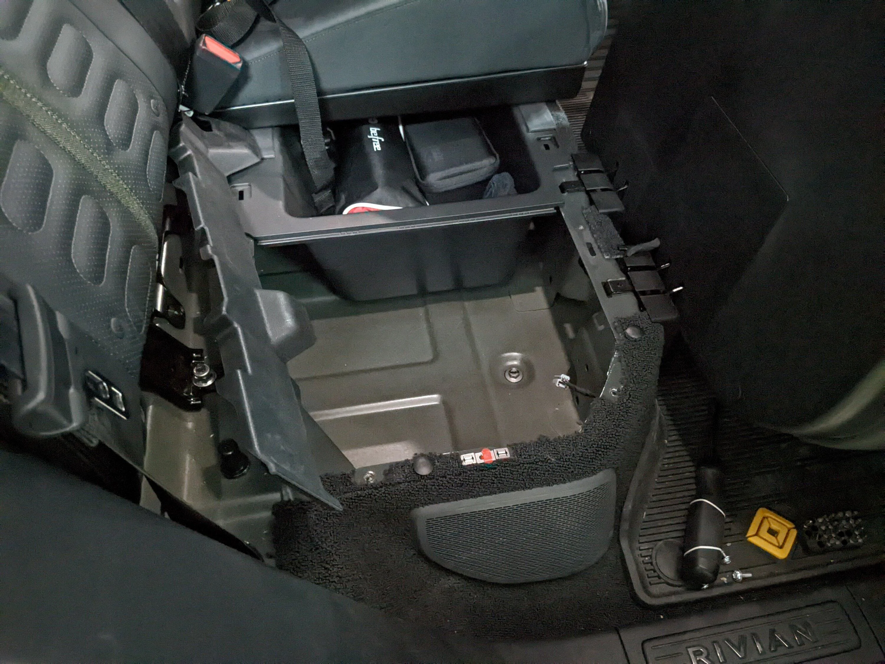

I don't have pictures of the disassembly process, but this is what it looks like with the sub out. Not shown in the picture is a trim piece that wrapped around the front. The piece in the back was the biggest pain, and I might have broken a clip, but with everything reinstalled it seems fine. Then it was just a couple screws that could be accessed from the top.

looks like the storage bin has potential to be bigger?

It does look like they could have made it a different shape that offered more space. Weird.

Yeah, if you don't mind tucking things under the back of the seat, the bottom of the storage compartment could be almost twice as wide. I personally wouldn't mind that, since what you see in that photo is a camera tripod. It would fit under there nicely.
So looks like the connector is a simple two wire plug? I was hoping that it was a self powered unit so I wouldnā€™t have to run another power cable if I used a small powered sub. I think Iā€™ll wait for a direct replacement, although I am handy and have a spare JL 8w3v3 collecting dust in my garage.
