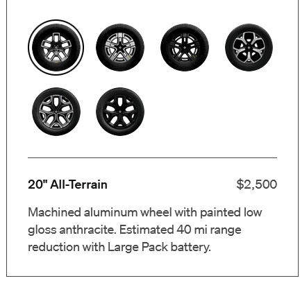

SeaGeo
Brice
Jan 12, 2021
5,261
9,698
Xc60 T8
Just to clarify, most folks are getting these 20s. No the brights, nor the darks.
