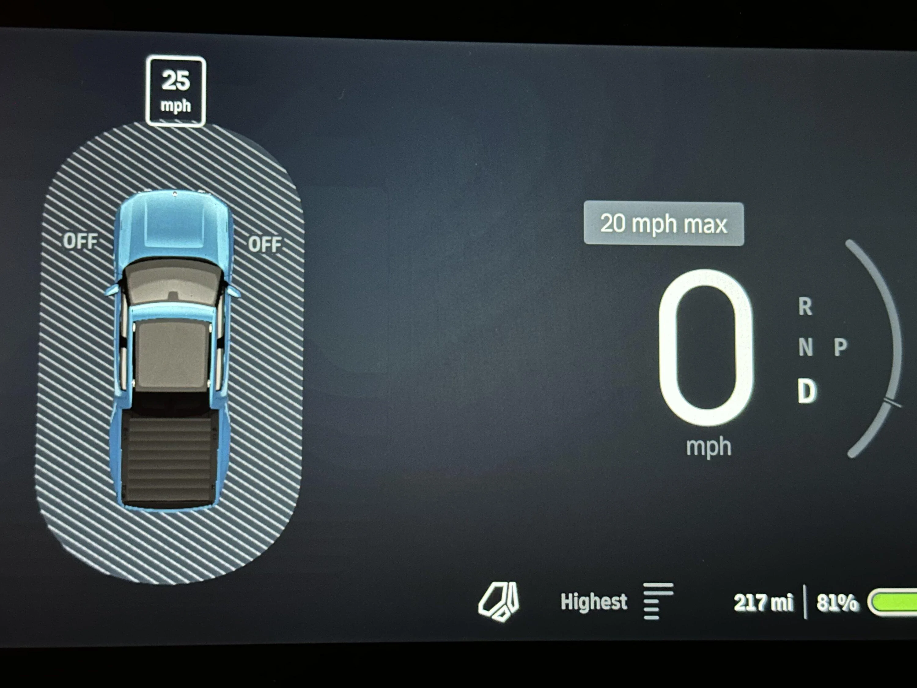

I thought rock crawl just wouldn't let you accelerate past 20 and if gravity got involved it would still go faster.
You might be right but it says max
20 mph.
