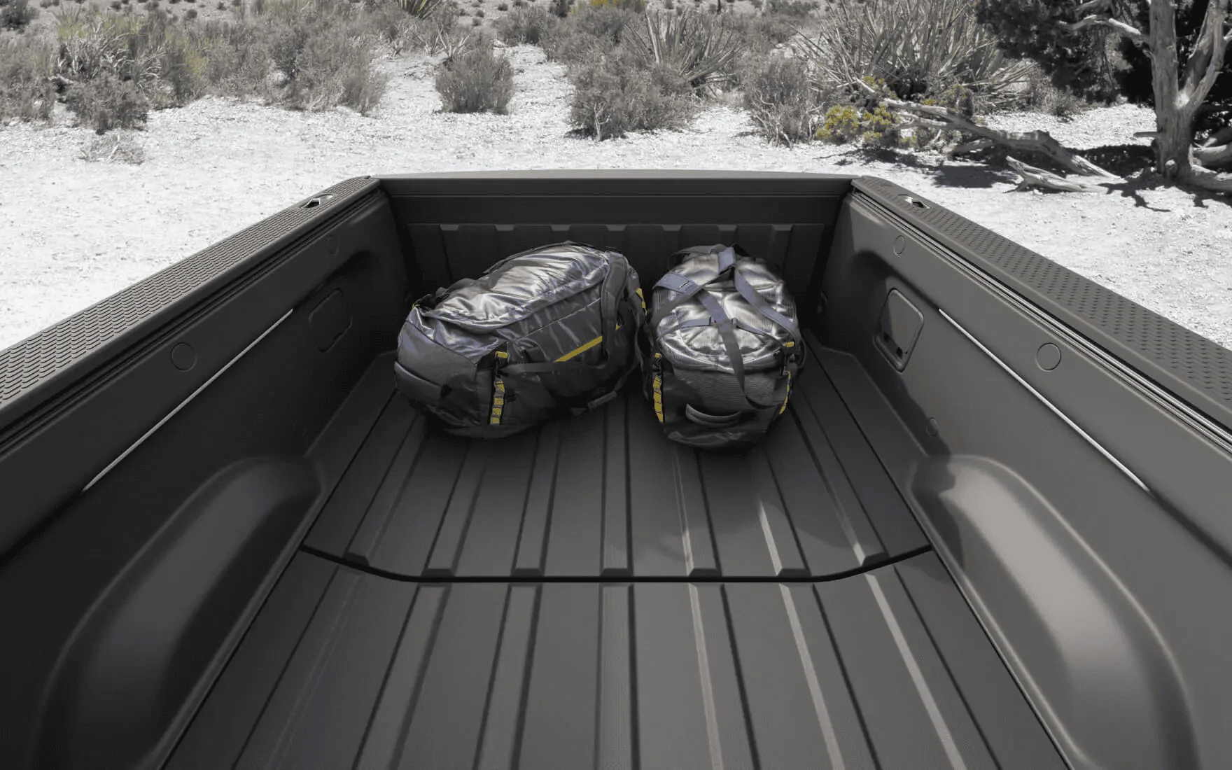

Somebody would have to get back there with a tape measure to confirm, but if it is 51" at the narrowest point of the sides, which I think is in the back by the tailgate, there certainly isn't much of a difference between the wheel wells and the side rails. I'm assuming that the line I see on the side of the floor is straight, which may not be a valid assumption.

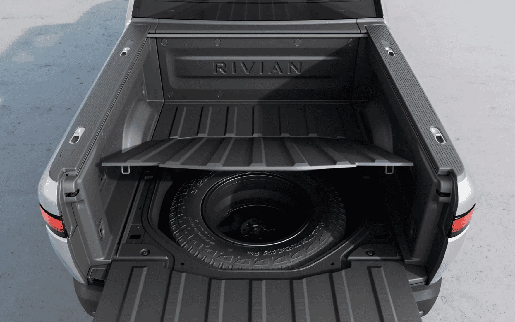

Another angle... Admittedly, this one makes it looks like the wheel wells stick out further than the they do in the first picture.
After my reply I went digging for official "production" pictures of the bed and found this same one. I totally agree it *looks like* the wheel wells roughly match up with the "narrowest point on the sides" at the gate.
Which would be incredible.

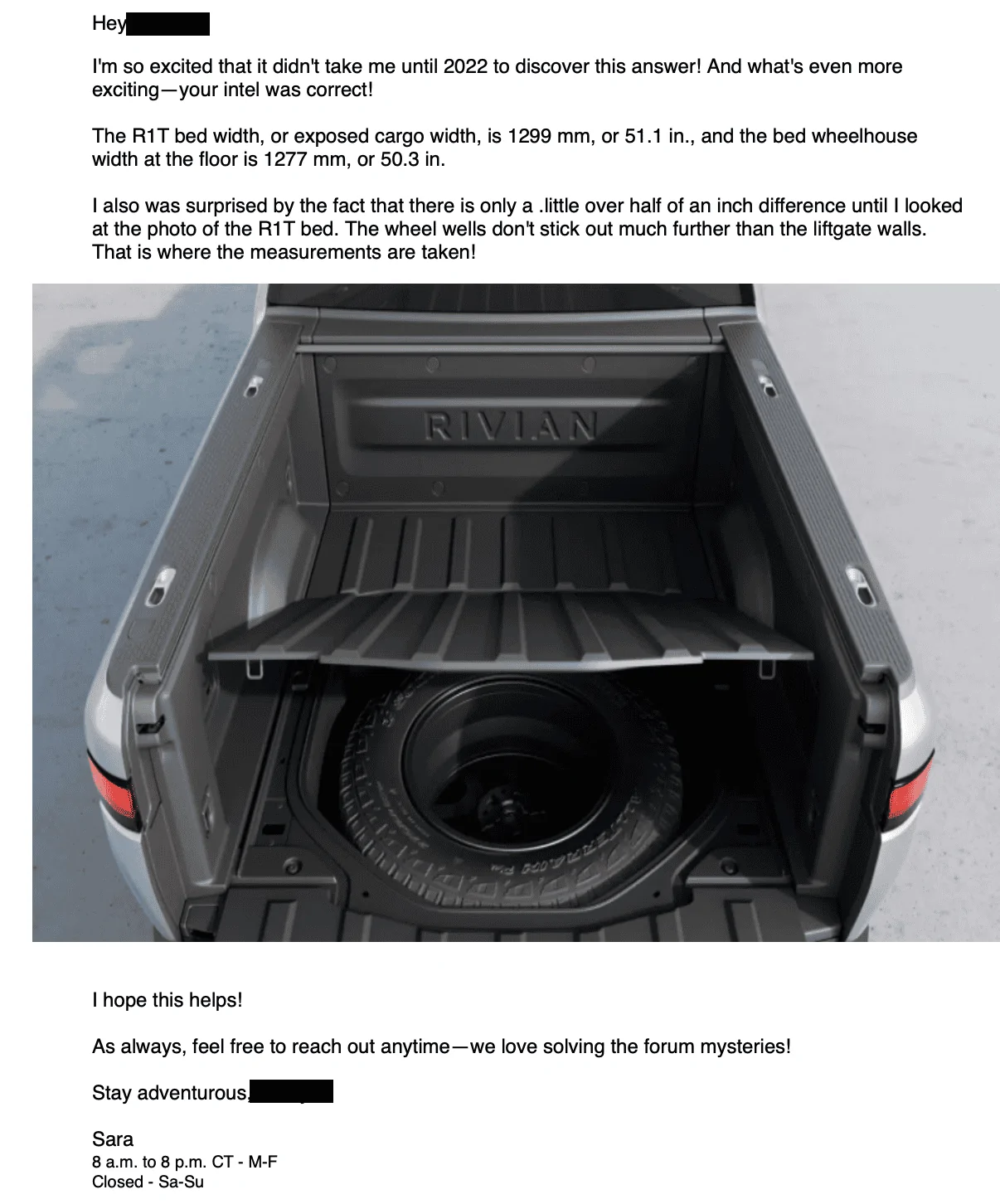

Welp, confirmed.
Total bed width - 51.1"
Width between the wheelhouses - 50.3"
This is fantastic news.
