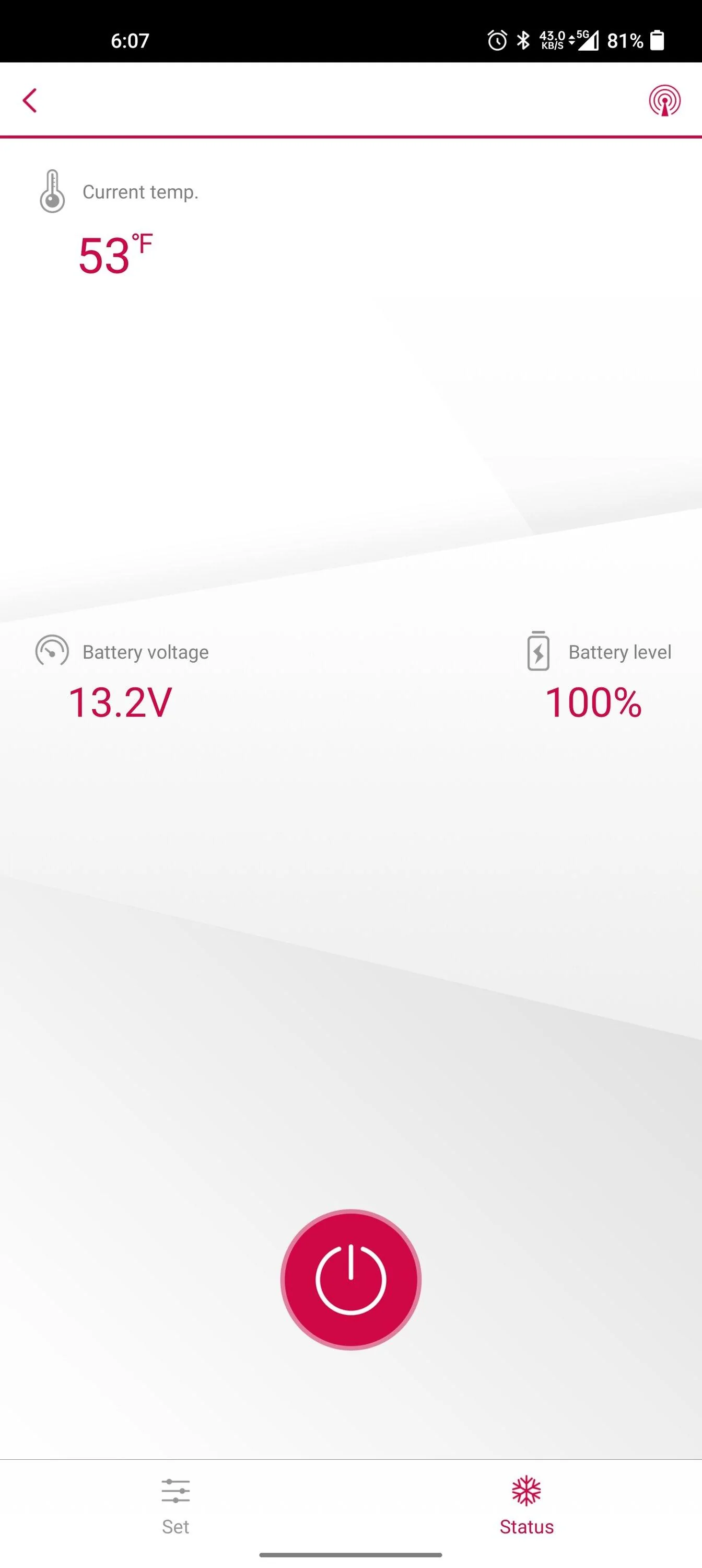

I just bought the Iceco GO20 and keep receiving e1 low voltage error. I set it to it's lowest setting for the voltage protection. Using the cigarette lighter plug, which by the way doesn't stay in place very well.
I'm wondering if the cooler is defective or the Rivian just doesn't put out enough voltage.
I plugged the vehicle in, drive about 40 minutes, then locked the vehicle and was away for about an hour. I can't imagine the voltage dropping that low in only an hour, and even if it did wouldn't the high voltage batter charge back up the 12v battery?

Unfortunately when it has the E1 error, the app cannot connect. Once the vehicle is woken up, I get the app to connect and it showed 13.2v. I'm wondering if vehicle is sleeping the voltage drops too low and there's no way to completely turn off the voltage protection.
Rivian R1T R1S Sizing it up.. my power cooler arrived.. ICECO GO20 Dual Zone Screenshot_2022-09-25-18-07-29-76_91ec5113c69b66f458120812010cb5b8

Oh. The 12V outlets turn off when the car sleeps, this is by default. You can force them on with camp mode or by turning on the 110 outlets.
