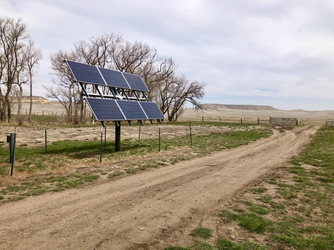

Out at the ranch, we have a smaller solar setup that was built to power a small homestead, but it doesn’t get a ton of regular use today. It was originally built in the early 1990s and only been updated a few times. There’s a couple more posts and panels than what is pictured below. I’m hoping it will be enough to “trickle charge” the R1T from the sun while out there. I don’t know if I will need to get a special inverter or make other modifications to make it work, or if I can just plug in to the house.
To create a real solar charing solution for the vehicle, I expect I would need to build out new battery storage for the solar system. That’s probably way too expensive for the occasional use while I am up there. It would just be awesome to get a couple of miles of range directly from the sun.
