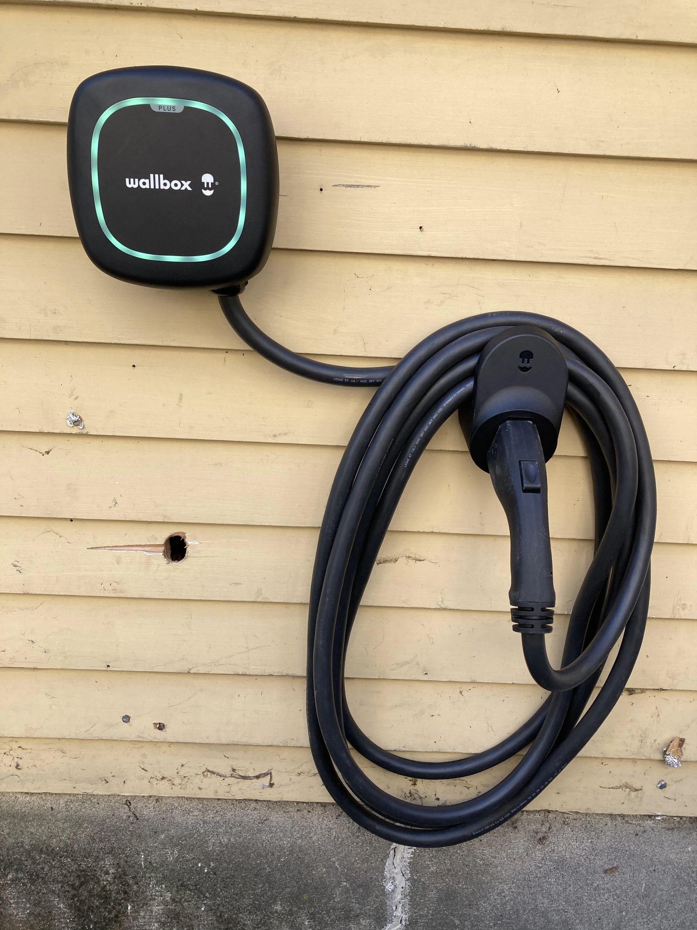

I'm still going through the 14 pages of this thread, but wanted to ask whether there's a way to dim this light or turn it off altogether while charging? I'd hate to advertise this so brightly in my suburban neighborhood.
I used this: https://a.co/d/4qcvuzf
Cuts out the vast majority of light, but definitely not perfect. I left a little window in the middle so my wife could still see at a glance if her car was charging.

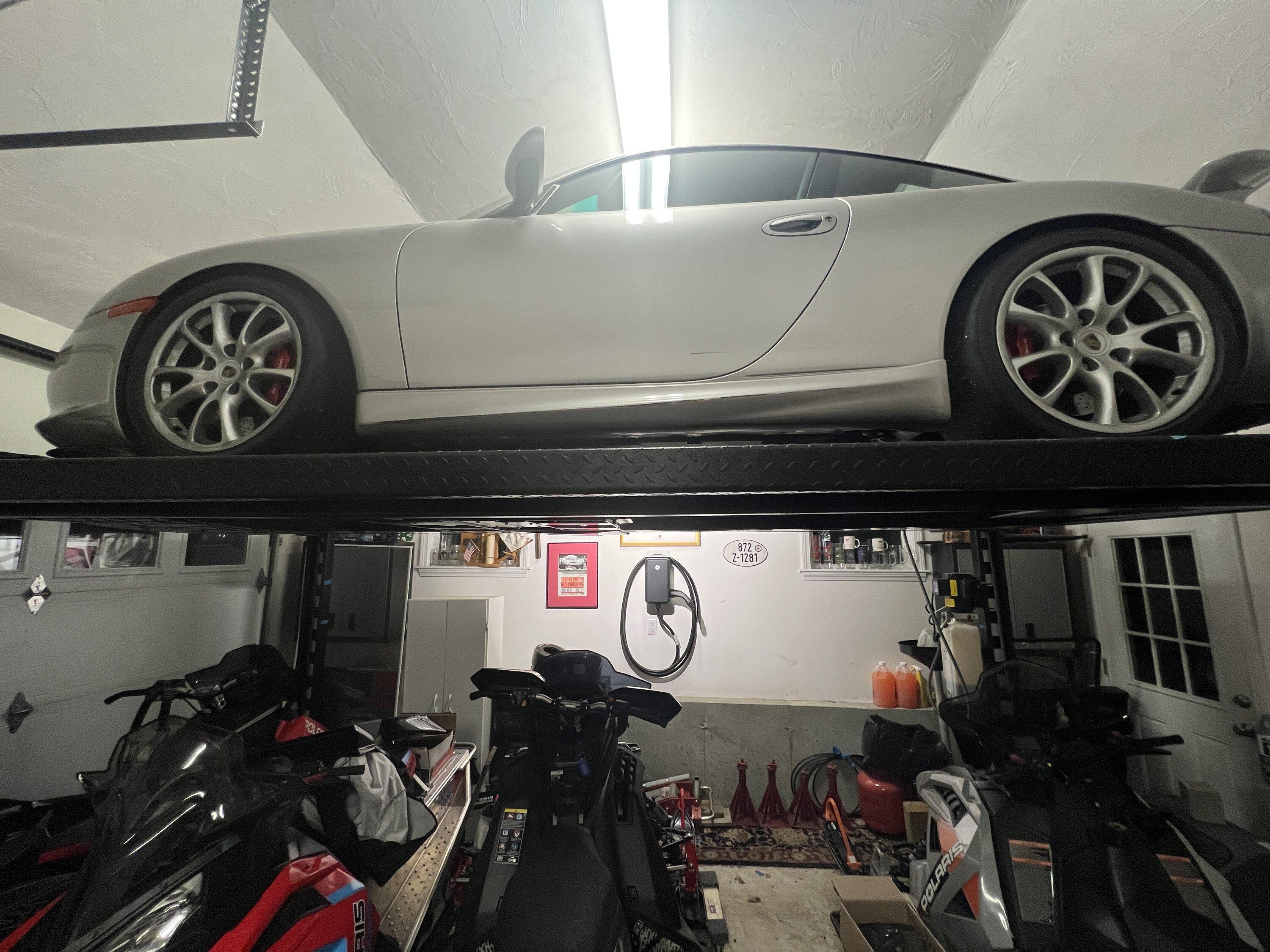

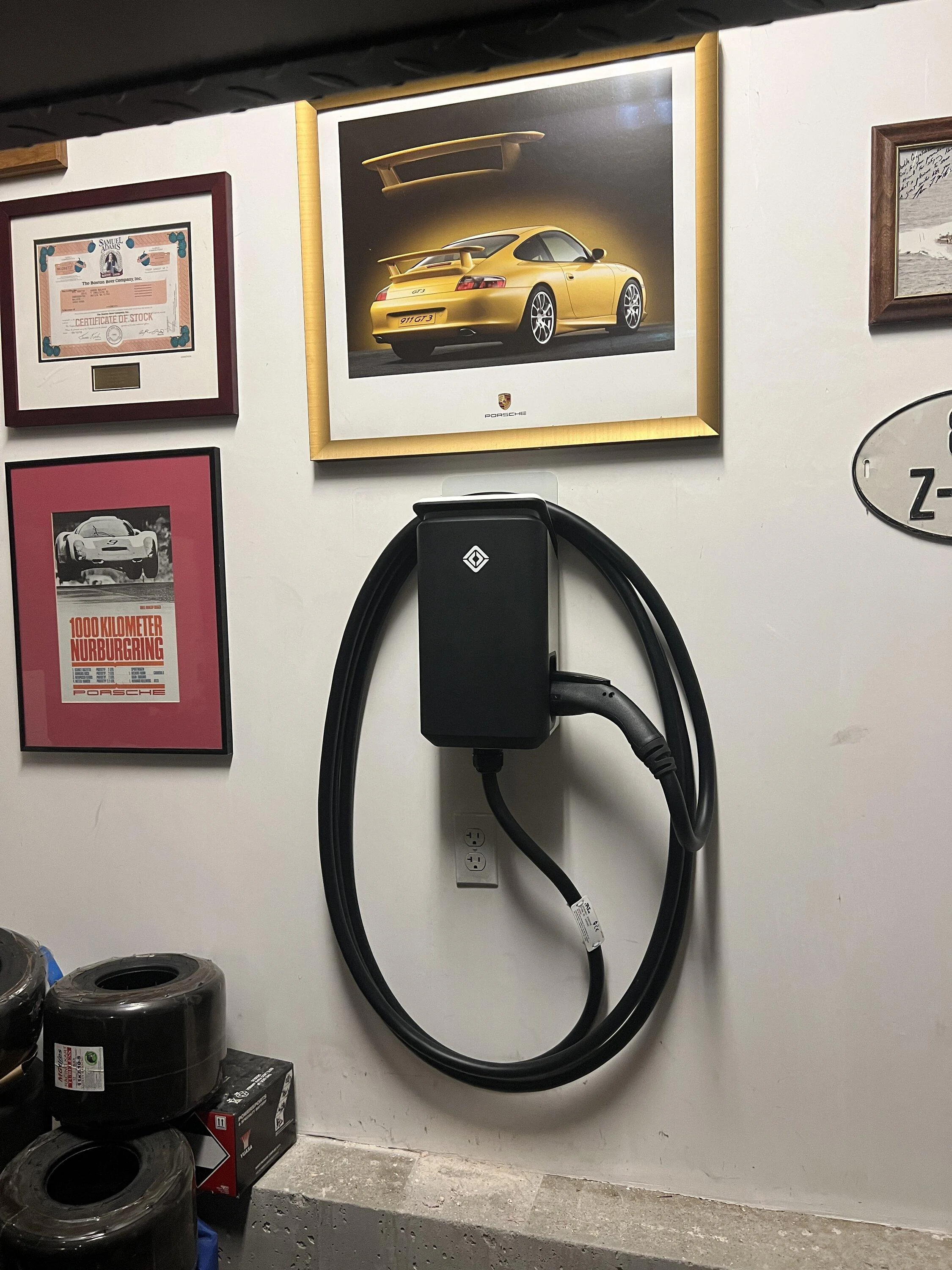

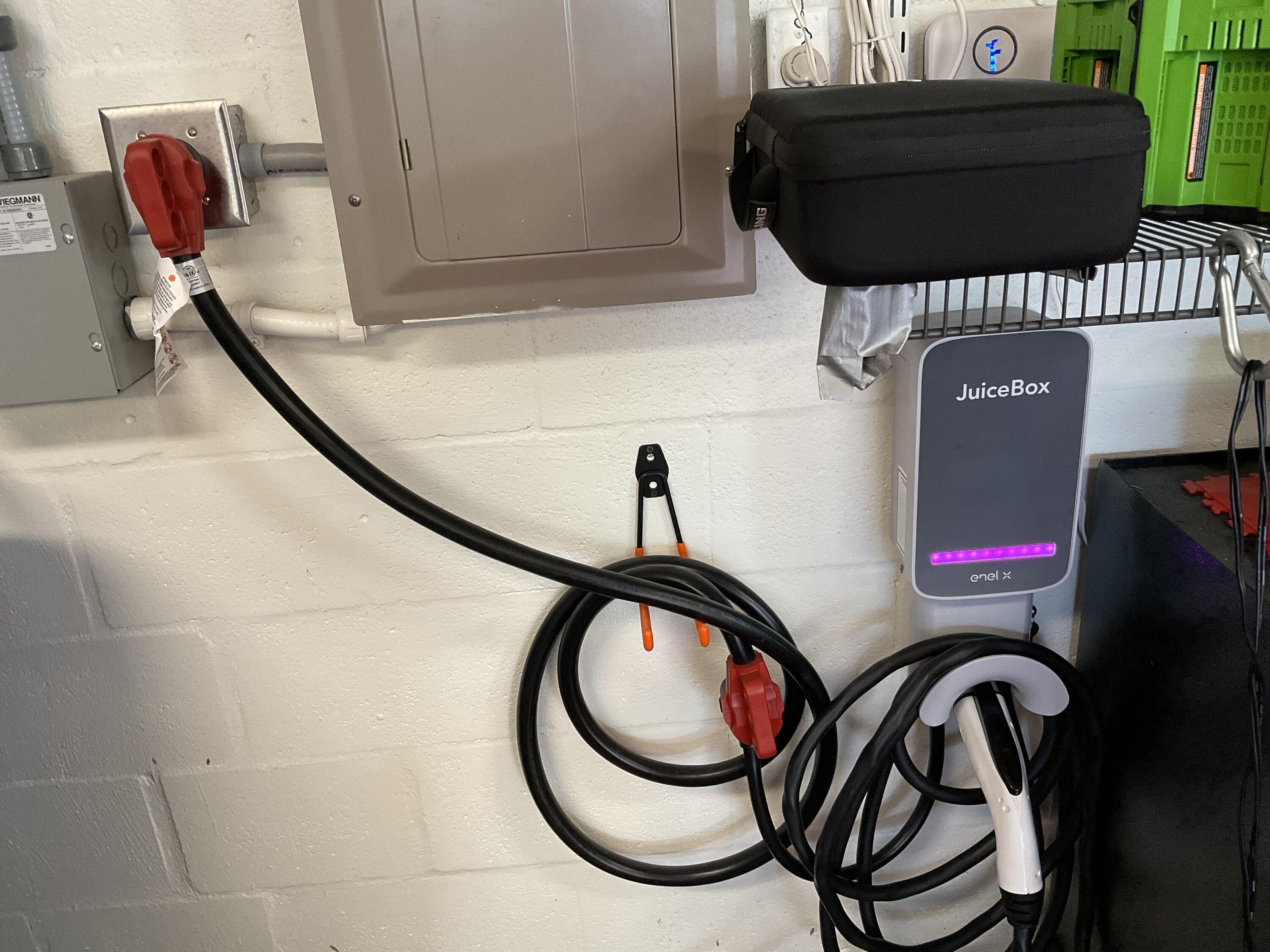

So lucky I left some speaker wires in the wall and actually remembered where they were. Was able to use them to pull a wire snake through. Ran 6/2 copper in the wall without surface mounting conduit on the wall.
Nice. You are sticking with 40amp charging then on the 6/2 right?
Not sure why you’d say that. 6/2 is rated of 65 amps at 75c per the NEC tables. 48 amps on a 60 amp breaker doesn’t exceed 80% load rating.
5,322
8,976
6/2 is usually a Romex sheathed cable and max amp is 55 on a 60 amp breaker continuous load at 80% is 44 amps but very few chargers have a 44 amp setting so max would be 40.
If you are using 75c or 90c 6 awg thhn or similar in conduit with a 60 amp breaker then you are good for 48 amps.
As a side note although Romex usually is using wire inside the that has a 90c rating, it is against code to remove the sheathing as the wires are not individually marked with their rating.
Sorry I think I read your statement above as 6/2 Romex and not 6/2 wire. Your weight is 6/2 copper you would be fine but it needs to be in conduit. How did you get conduit in the wall? Maybe the speaker wire was in conduit?
Correct, I had run grey conduit everywhere I either put or anticipated putting a TV. In my garage I never got around to installing a TV, so I used my speaker wires as a pull string for #6 individual conductors.
Wow that's great. I have put speaker wire in the wall before for future use but never bothered to put conduit in. I probably should have, but expense, time, etc. So glad it worked out, looks great. I put a 48a Autel in myself and like it is the higher amps.... Now I just need my R1S before the charger is outdated :(

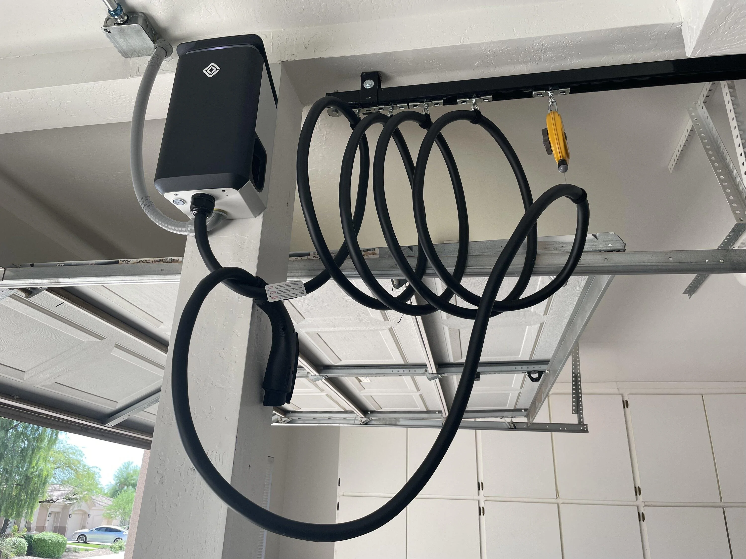

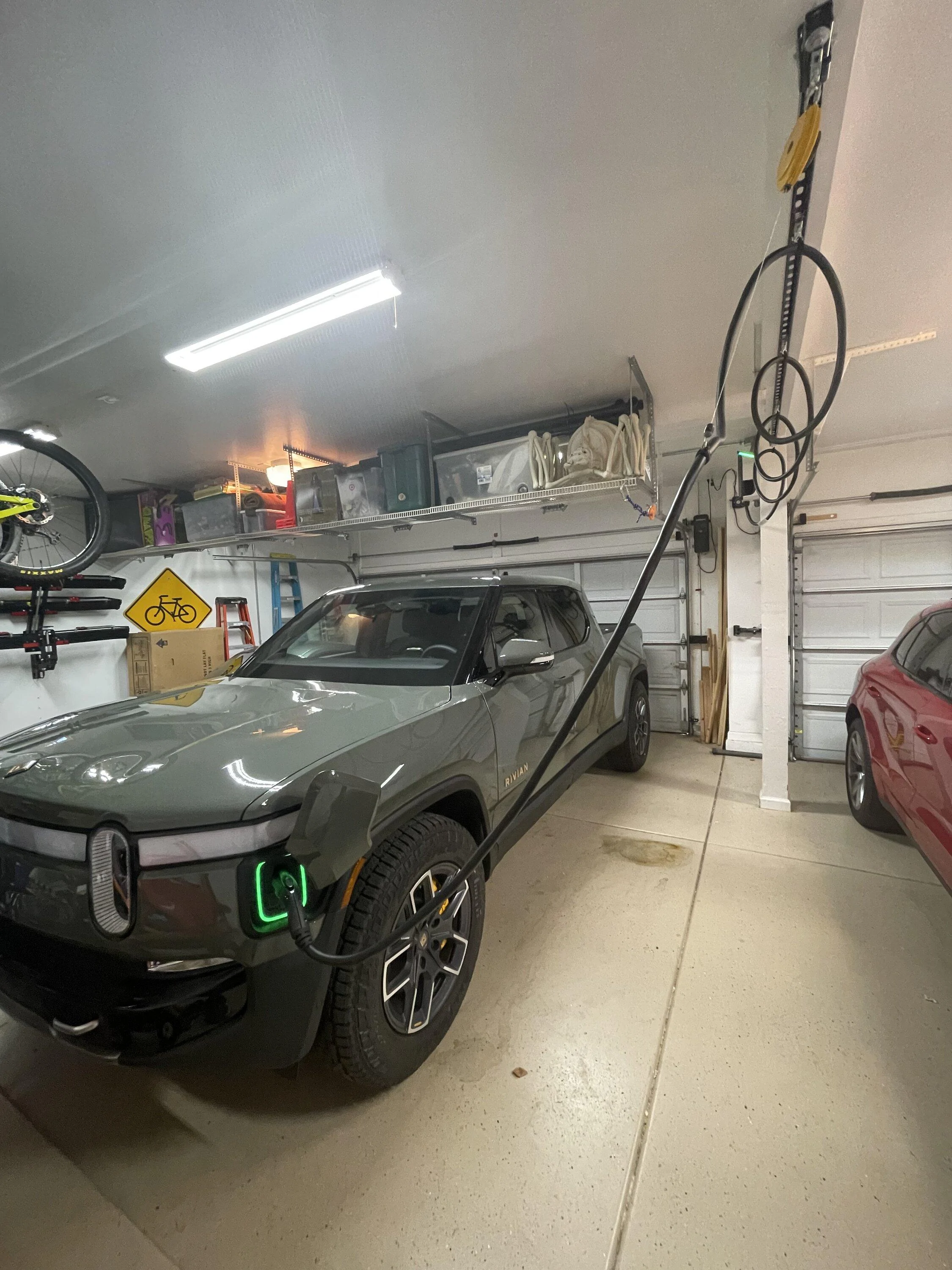

Unistrut Trolley to deliver the charge cable.
What did you use to connect the charge cable to the trolleys?
Thanks,
CB
