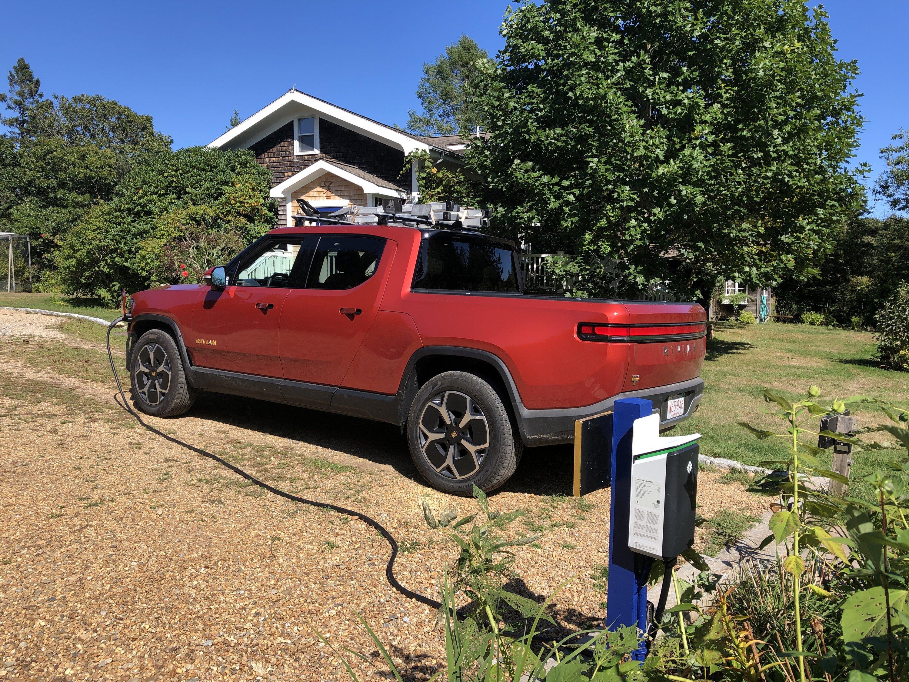

Several years ago when we redid the parking area I buried 2" conduit from under the deck to the back of the signpost. When the Rivian charger came I consulted with my electrician and installed
1 3/4 inch conduit from under the deck into the mechanical room and up through the bottom of the electric panel, a total of about 60 feet. There were 3 LBs involved to make pulling the wire possible. I blew a "mouse" and mason string through the conduit with a shop vac then pulled indexed mule tape the length of the conduit run. Reading the numbers on the tape got me the length of the wire I needed. At the post we cut off the 2" conduit underground using a Fein multi-tool with the blade installed facing towards the rear of the tool after protecting the mule tape with a smaller peice of conduit (don't forget to put the bushing on the conduit end), placed a round hand hole below grade and ran Carflex from that up the post to the charger and the outlet box. We hauled 2) pcs of #6 THHN, a ground wire and 3) 12 guage wires for the 110 V outlet on the post -all stranded copper. In the panel we installed a 60 Amp breaker (just above the solar panel input) and a 20 amp breaker for the 110v outlet. The buried conduit was properly cemented at the joints and capped yet I still vacuumed at least a gallon of water out before blowing the string. I pulled a permit for the underground and had it inspected when it was buried. I pulled a second permit for the charger install and had that inspected. The 25 ft cord just makes it to the front of the truck. I back into my space because I'm a firefighter. A friend has a Tesla model S, he plugs in (with an adapter Tesla provided) and gains 50-60 miles while we have dinner. My wife is thinking about a Minicooper EV and since I only charge every 3 or so days we don't feel the need for a second charger but the conduit would serve if we ever need one. I plan to use the 110V outlet for vacuuming cars (maybe I'll get a buffer too) and running my table and shop saws when I have milling to do for a job. Costs: Charger from Rivian $500, Materials $600 (+,-) Electrician for 3+ hours plus some #12 wire and parts? no bill yet but I did most of the work and running around. Plus the 4x4 PT post and some paint. I'd say at least a full day of work on my part maybe a little more.

Several years ago when we redid the parking area I buried 2" conduit from under the deck to the back of the signpost. when the Rivian charger came I consulted with my electrician and installed
1 3/4 inch conduit from under the deck into the mechanical room and up through the bottom of the electric panel, a total of about 60 feet. There were 3 LBs involved to make pulling the wire possible. I blew a "mouse" and mason string through the conduit with a shop vac then pulled indexed mule tape the length of the conduit run. Reading the numbers on the tape got me the length of the wire I needed. At the post we cut off the 2" conduit underground (don't forget the bushing), placed a round hand hole below grade and ran Carflex from that up the post to the charger and the outlet box. We hauled 2) pcs of #6 THHN, a ground wire and 3) 12 guage wires for the 110 V outlet on the post -all stranded copper. In the panel we installed a 60 Amp breaker (just above the solar panel input) and a 20 amp breaker for the 110v outlet. The buried conduit was properly cemented at the joints and capped yet I still vacuumed at least a gallon of water out before blowing the string. I pulled a permit for the underground and had it inspected when it was buried. I pulled a second permit for the charger install and had that inspected. The 25 ft cord just makes it to the front of the truck. I back in to my space because I'm a firefighter.
Wow, great job and a very clean install!

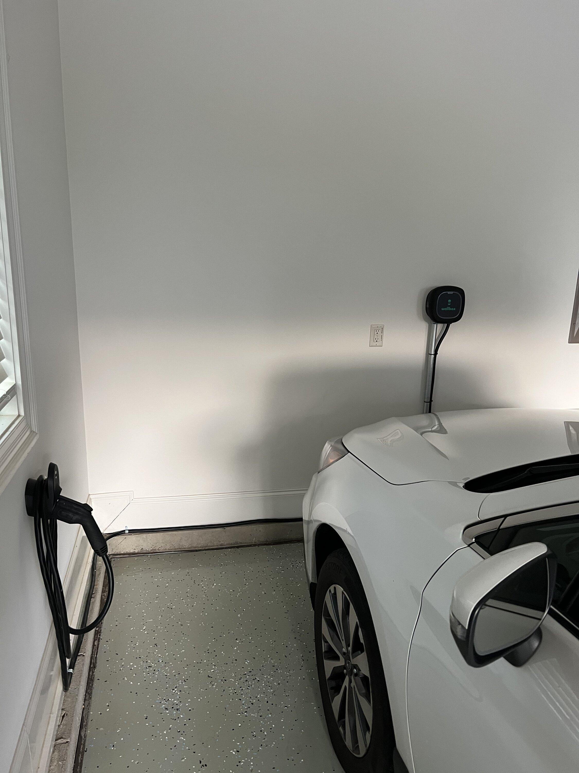

Rivian R1T R1S Show off your Level 2 Home Charger installs here 06E52DD1-CFDC-4D87-931F-85FC21927930
Installed a wallbox for me and my wife. Her x5 PHEV will be her next month and my Rivian when it decides. Probably install an outlet for her or another wallbox to make life simple.

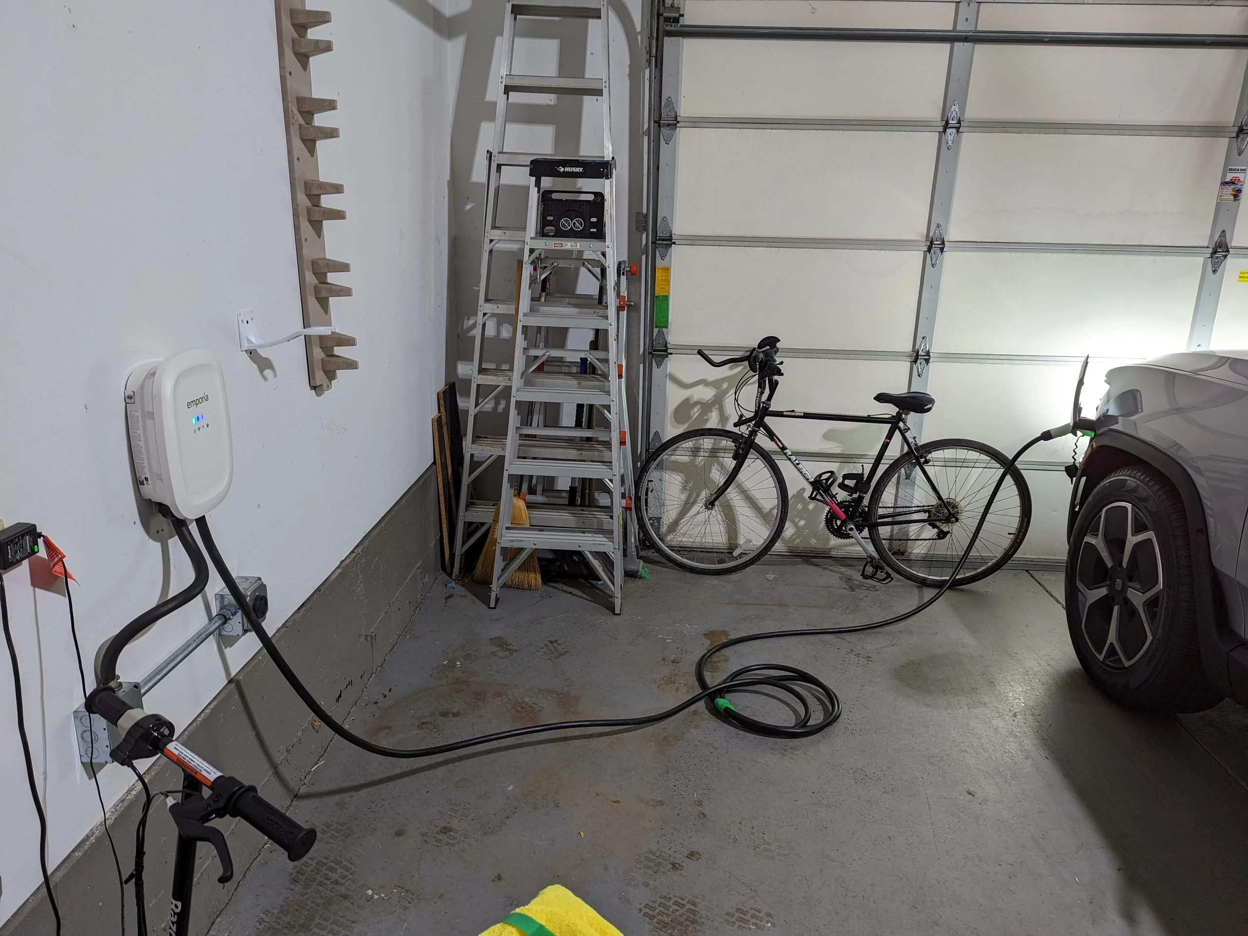

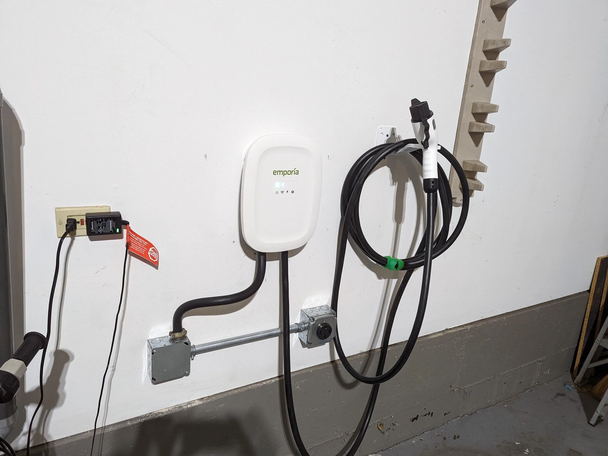

I went with Emporia 48A EVSE hardwired. 60 amp breaker. Their app is pretty intuitive. So far so good.
Hi! Quick question. We have the same Emporia charger. I can not get it to sync to Rivian inside the Emporia app. Their support department had no clue. We can still use the charger but it would be nice to have it integrated. Were you able to add your Rivian inside the Emporia app?

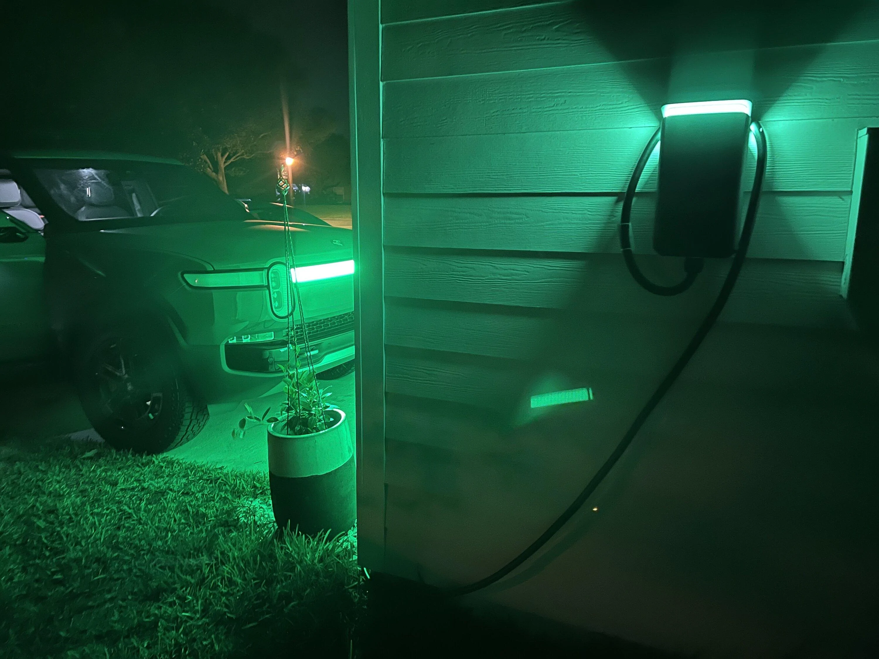

I'm still going through the 14 pages of this thread, but wanted to ask whether there's a way to dim this light or turn it off altogether while charging? I'd hate to advertise this so brightly in my suburban neighborhood.
3,320
6,267
On the truck, yes. On the charger, no.

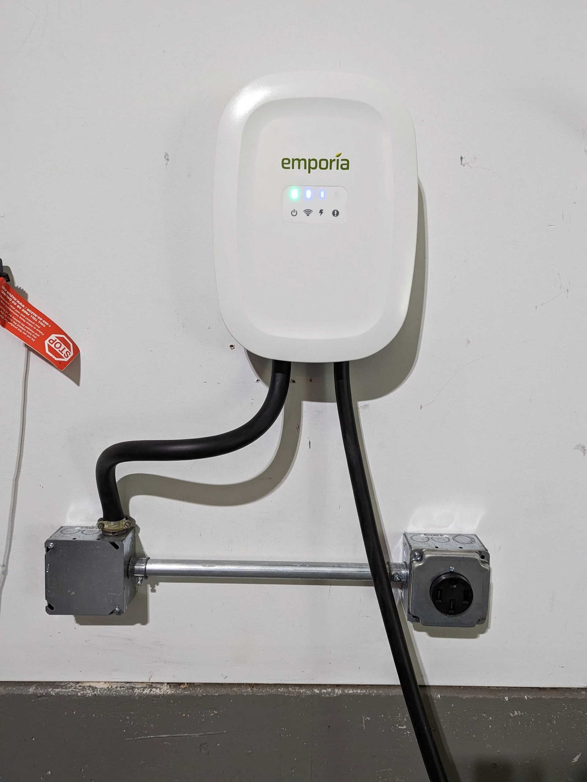

I see. Yea, I'm planning on just a 3ft run from my panel to the charger I want to install (50 amp Autel on 60am breaker) and plan to use 6 gauge THHN. I am just trying to decide if I need to use flexible or ridgid metal conduit or if I can get away with PVC conduit with heat ratings of THHN in conduit. I'll probably just use metal since it is a short run to make sure.
Looking back on this as I plan to get the same pass through. I think I'm going to go through the house though because I would be concerned about someone opening the garage door and ripping the cable out.
