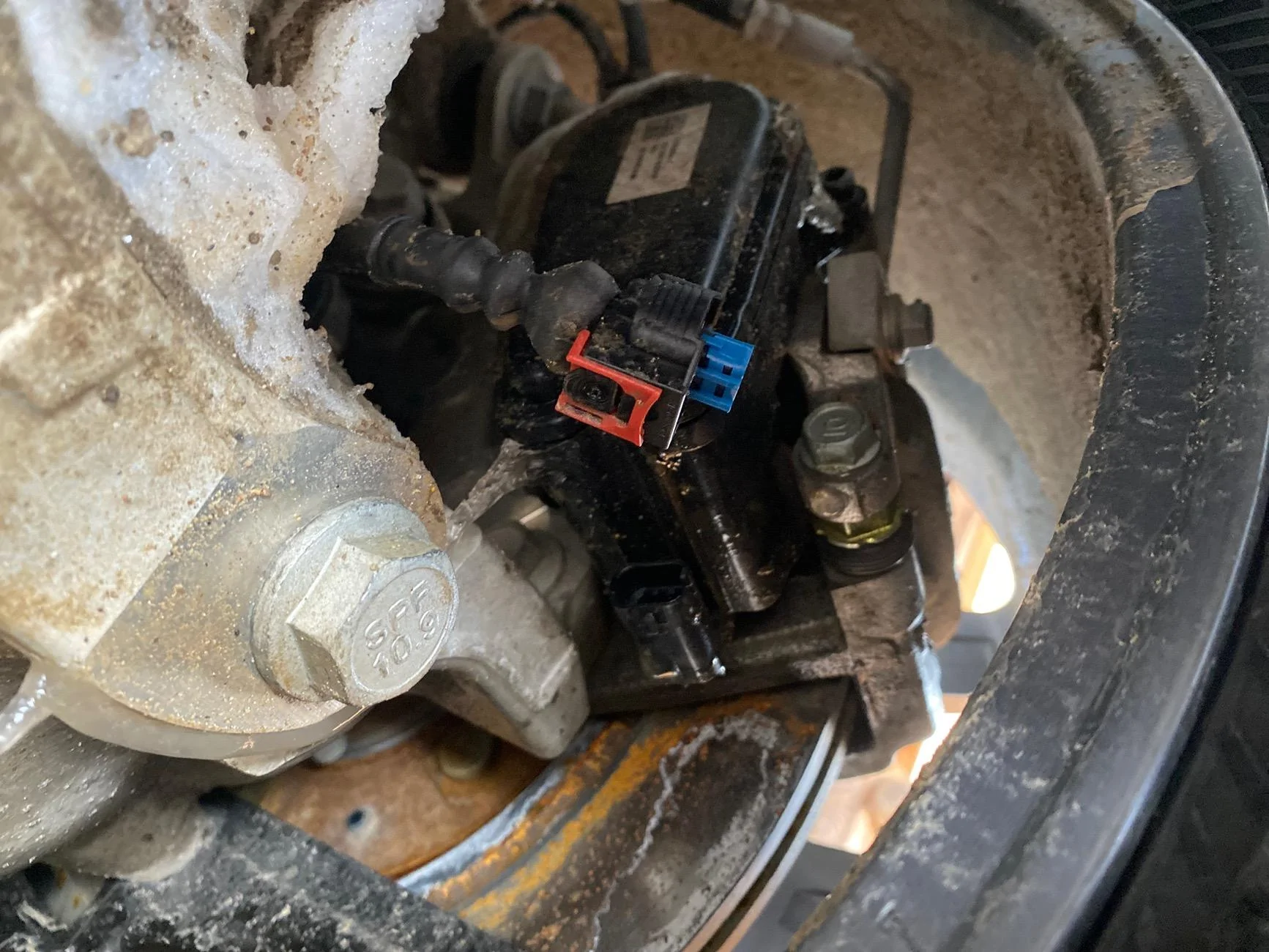

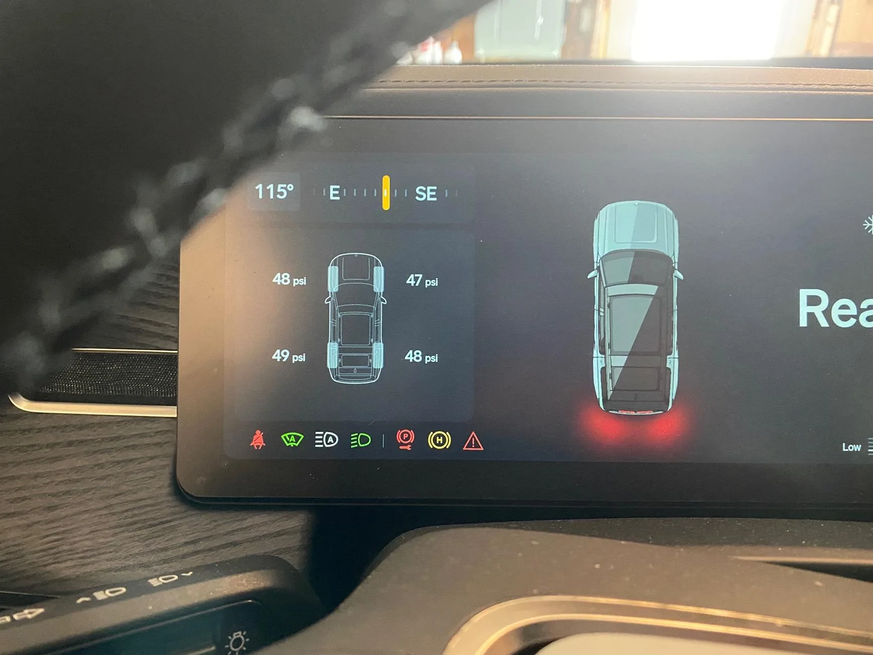

I am in Canada and have been driving through lots of deep snow combined with not having a heated garage. About 10 ft from my driveway I got warnings popping up with service parking brake and hold malfunction warning telling me regeneration is not available slow down using brakes.
Parked in garage and the vehicle would not permit me to put it into drive or reverse.
After calling Rivian and scheduling a tow I melted my wheel wells out to discover the passenger side brake calliper had an electronic connector disconnected.
Reconnecting got the system up and running. I cancelled the tow with Rivian.
Hope this helps anyone else.
