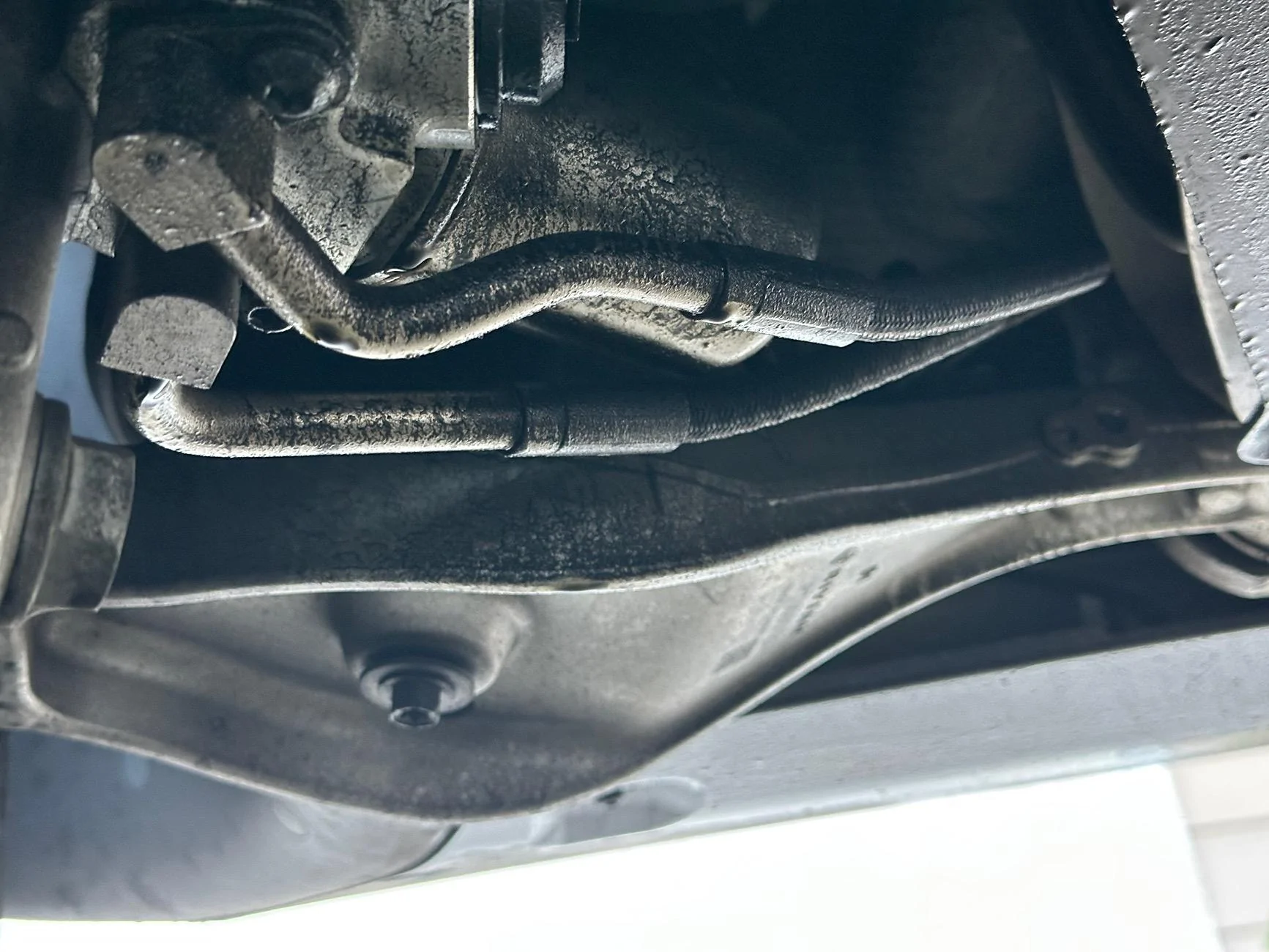

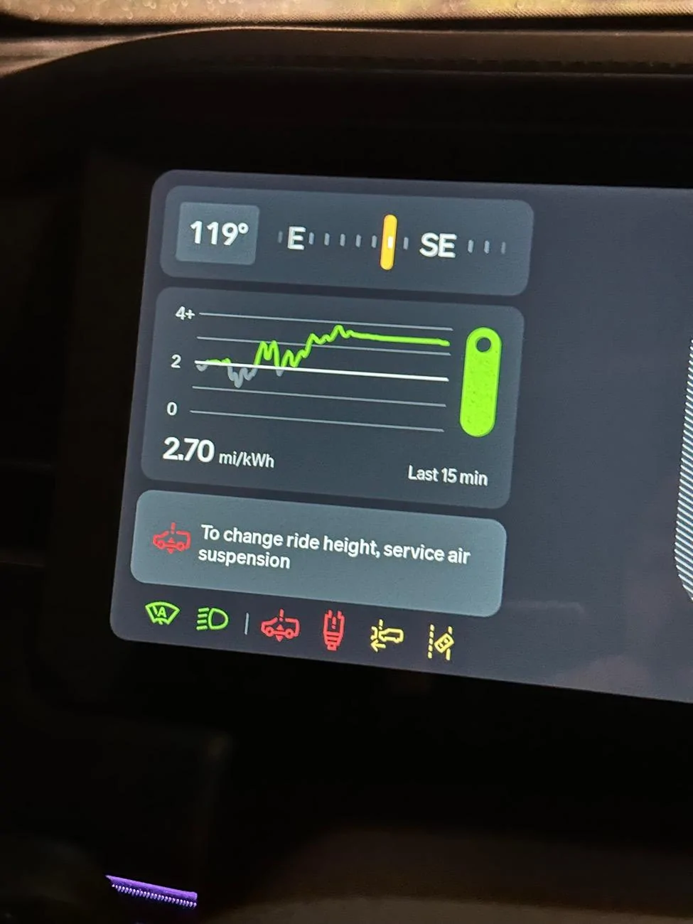

Just received this warning message on my 2024 R1S Quad with 3700 miles last night but no limp mode. Did a soft reset last night and a long sleep reset this morning and the message has been intermittent as I drove around town this morning.
(updated as this has been a draft all day…)

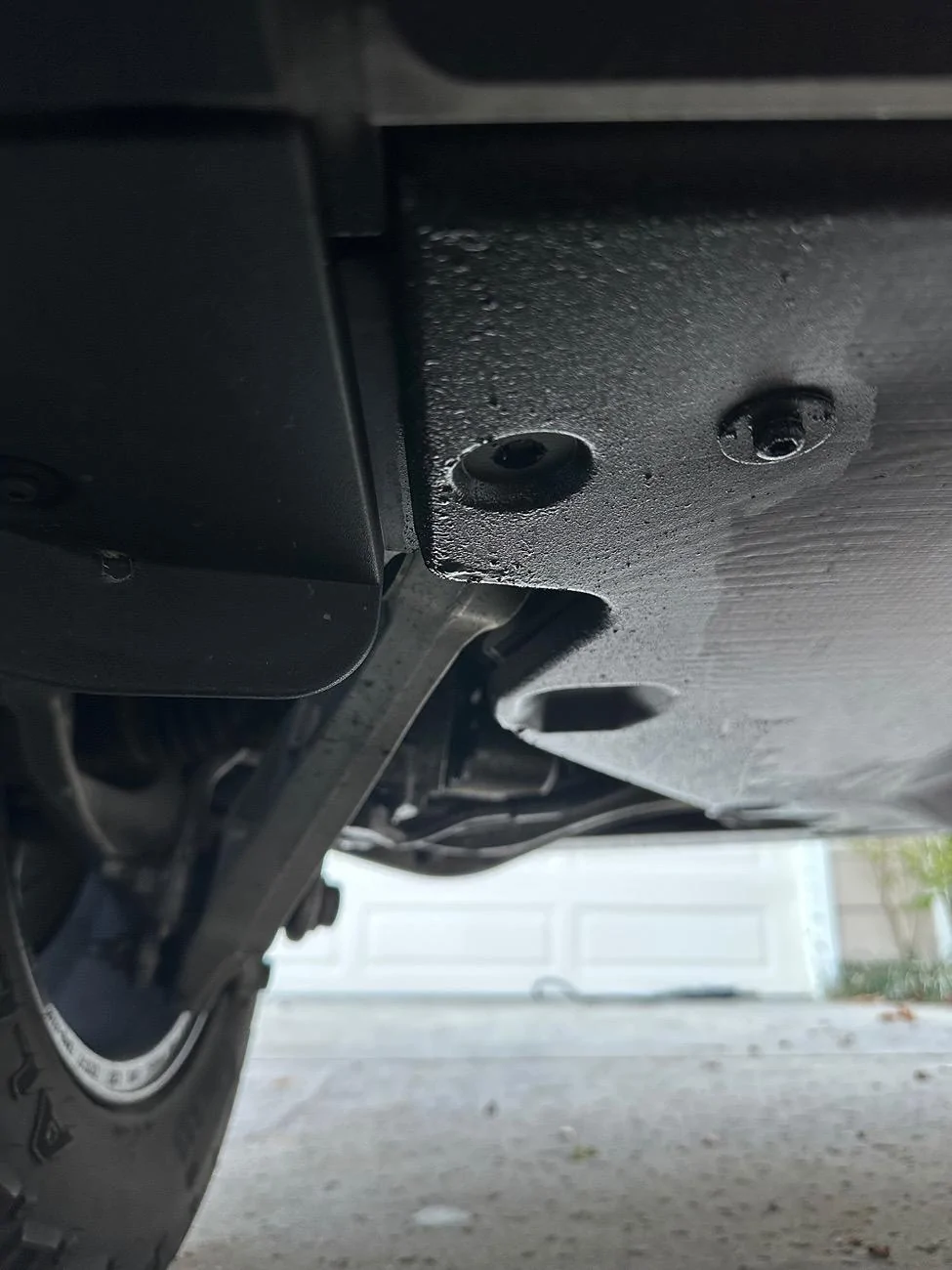

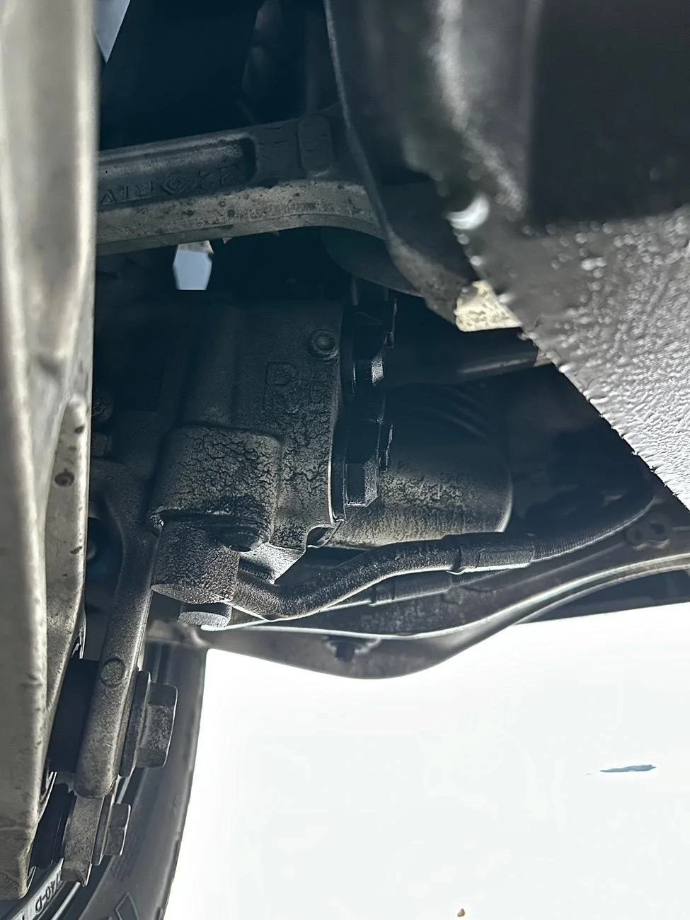

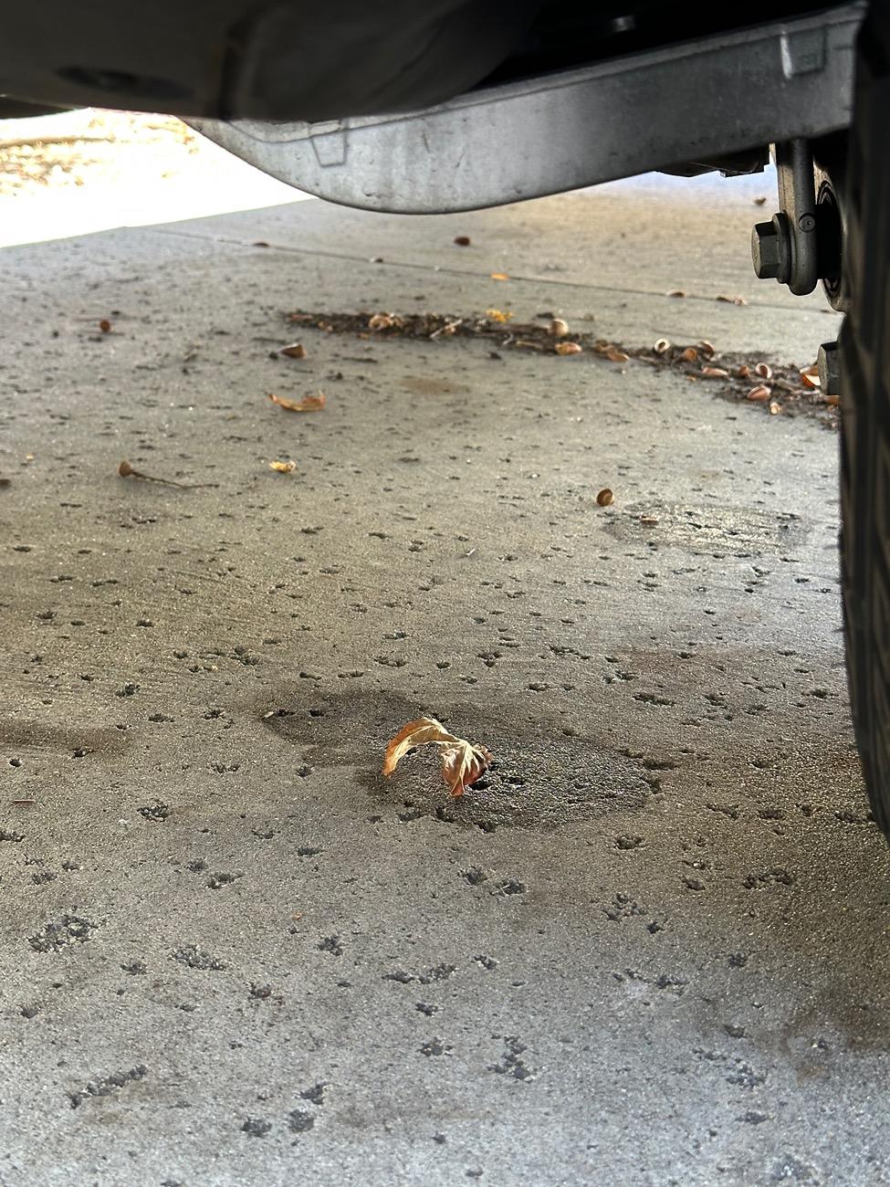

I just noticed a wet spot on my driveway and sure enough, there’s an oily drip from the lower control arm. The entire area seems to be coated in oil- the underbody shield, hydraulic lines, suspension, etc..
Has anybody else had a similar issue? I was able to get a SC appointment in Burbank within two weeks and I’m hoping for a quick turnaround.
It’s never been off road (unfortunately), I’m always in all purpose w/ Auto suspension, moderate ride, and I feel like the most abusive thing I’ve done is enable kneel mode for my kids to get in/out.

Service contacted me first thing this morning and bumped my appointment to two days from now and arrange a loaner. If it gets worse they told me to call back and escalate it so it can be towed to the SC.
I will be excited if I get a suspension hardware update, although I'm ok with the current ride quality.
Thanks everyone for your input! I’ll keep this thread updated with my experience.
4RNROFL
Matt
May 11, 2024
2024 R1S GW | Quad | Large | ORP | AT Black
I dropped it off for service yesterday morning and a tech came out for what would have been a ride-along. He popped under the vehicle and noted that the air suspension oil would be blue in color, the gold colored oil that I observed appears to be coming from the drive unit.
My guess at this point is the suspension error could be a red herring from a sensor covered in oil, but I’m waiting to hear more. Could be after Christmas though. In the meantime, I have a Ford Expedition rental from Enterprise on Rivian’s dime (except gas). Would have preferred any R1S, but I’m not sure about the fleet status at Burbank.
