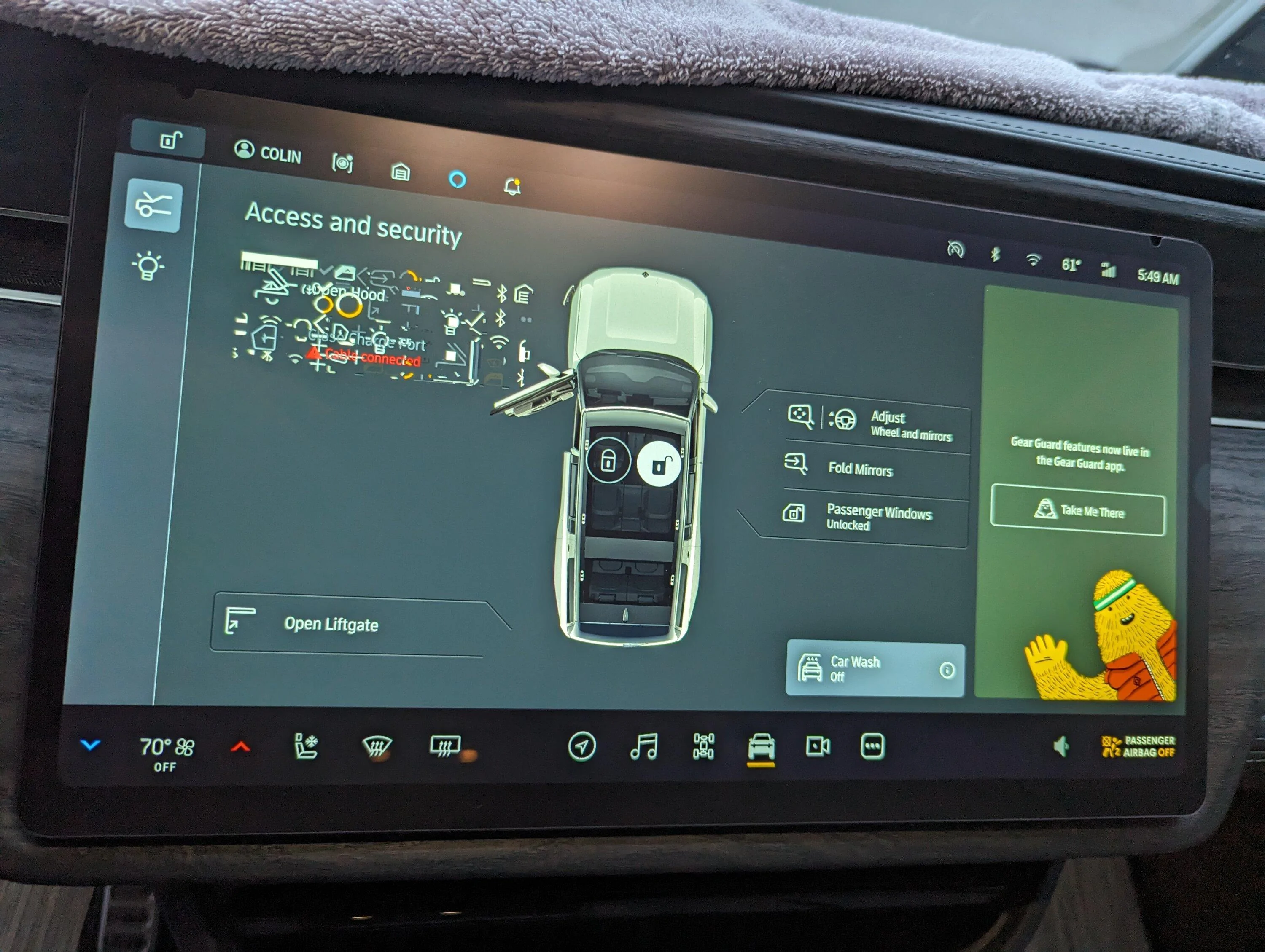

Anyone experiencing an overlay of additional text in various language formats on the upper left screen area under access and security.
Happened the other day and seems will not go away.
Do not know if there's any issues with rebooting and therefore was trying to avoid a reboot.

Haven’t seen this. Would try the infotainment reset before the hard reboot

+1 on the display reboot, not the whole truck OS reboot.

This happened to me Mother's Day weekend in-between my 2nd and 3rd charging stop (EA, not sure if that matters). Foolishly I tried to hit where the 'open charge port' button was at the third stop and it dropped the tailgate. After charging and finishing the last ~100 miles of our trip I did the infotainment soft-reboot and it fixed it, no worries. Hasn't happened since.
Edit: This was with my R1T (2022, VIN70XX)

Appreciate the comments as I will do a soft reboot to see if it clears up.
