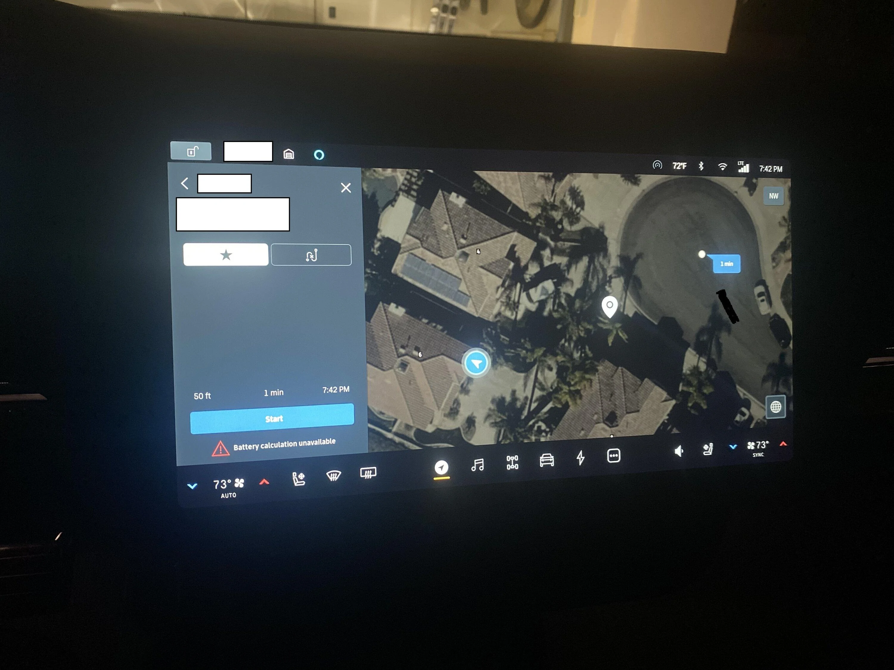

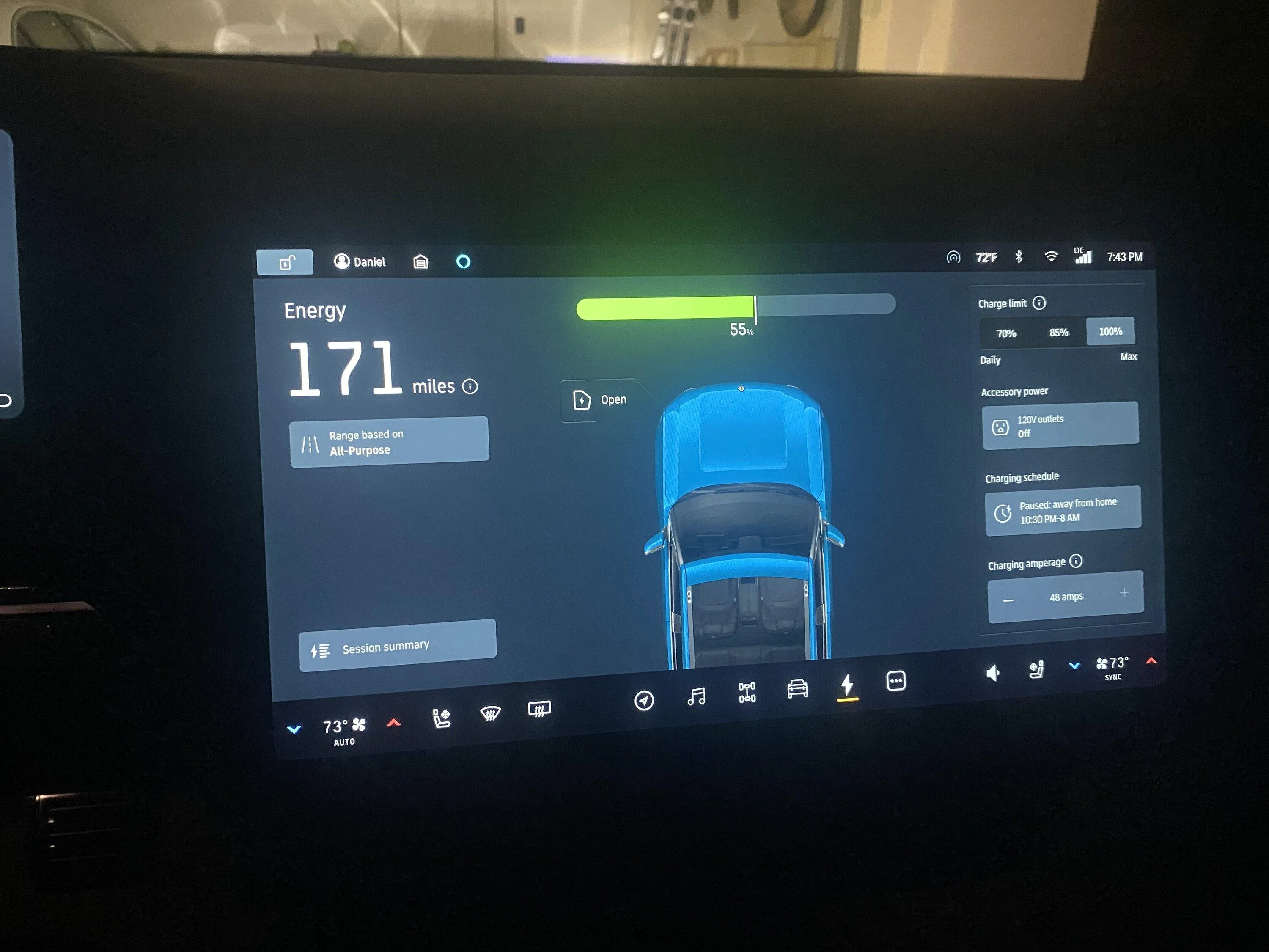

Has anyone had trouble charging the truck at home with a schedule. My GPS says that I am 50ft away from home so it will not charge per a schedule. It charges immediately when plugged in. I have a pretty long drive way so I am sure that is what is messing it up. The odd thing is the other services that are linked to my house such as gear guard and the proximity locking when home features work just fine. The white arrow is where the car thinks my house is. the blue arrow is where the car actually is and where my home charge is located.

Disable and re-enable scheduled charging while parked in your normal charging spot. That should fix it.

Hey Thanks so much. That totally worked. I have had an open support ticket for like a week now and they had no idea how to fix it.
