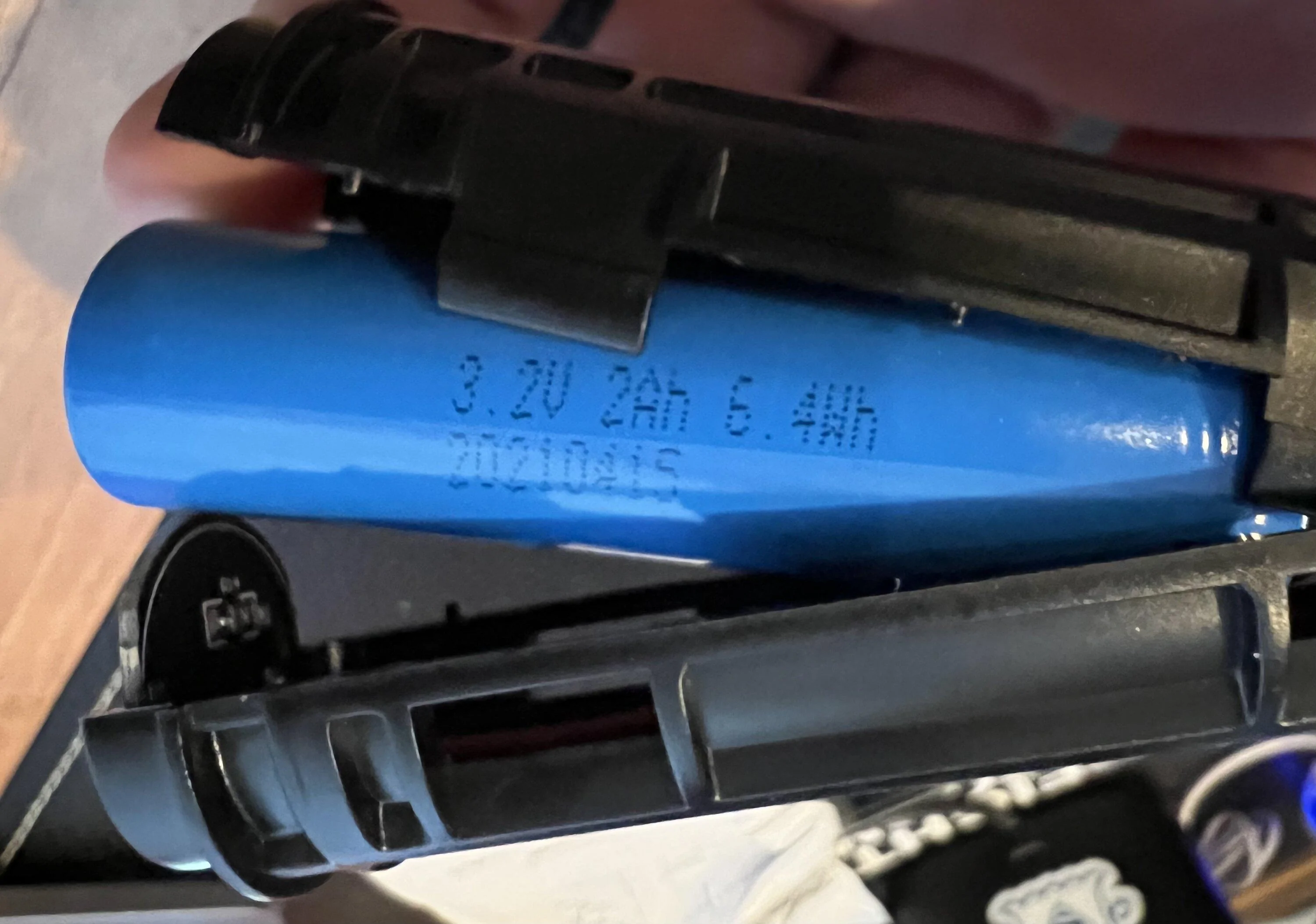

Well, that absolutely confirms that the door flashlight doesn’t contain the “7777th identical cell” - as my flashlight contains a 3.2V, 2Ah cell:
This is actually a good thing. Based on the voltage that is a LiFePO4 battery which will last much longer being constantly sitting at full charge in a hot vehicle door than the 21700s in the battery pack.
Wait, 3.2V nom ? Does it mean it's LiFePO4 cell instead? Which kinda make sense because that flash light is always charged up to 100% so LiFePO4 cell would not degrade much comparing to the cells in the truck.

A pity. The 7777th cell would have been a very cool engineering detail instead of a marketing half-truth. Presumably a well-intentioned idea diluted by the practical limits of manufacturing the flashlight itself. Which reminds me, anyone actually used that flashlight purposefully? : )
