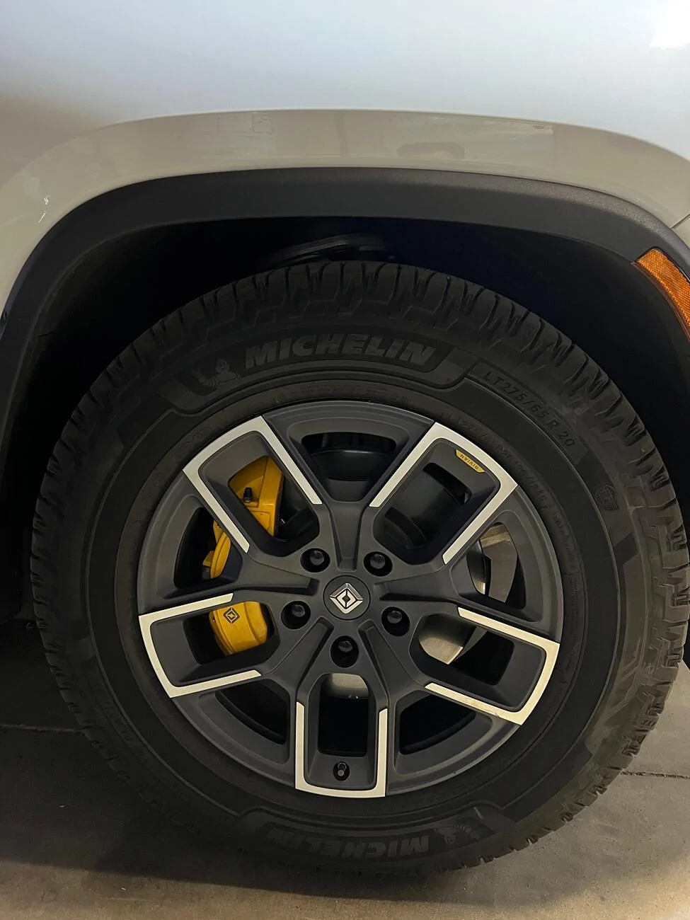

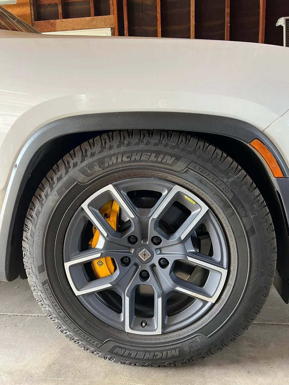

I noticed that the suspension sags, particularly after returning home from week-long trips. This time, I took pictures before I left and after I returned. The sagging is more noticeable on the front suspensions compared to the rear ones.
I'm always on the standard height.

The air suspension has a leak. My r1t had this issue. Service center will need to replace it.

Nope. Looks like a slow leak.

Not normal, open a service ticket.
My ‘23 quad R1t, 26k miles: front suspension, dampers , Jounce lines all replaced under warranty. My suspension took a dump last month, couldn’t drive the vehicle..
