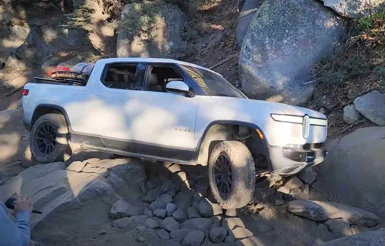

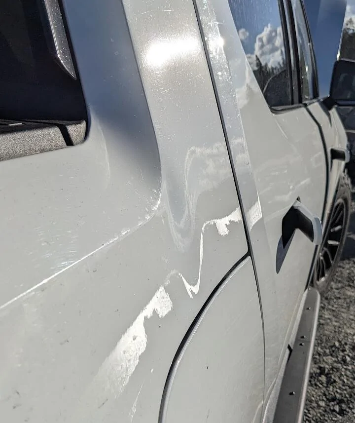

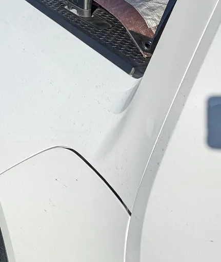

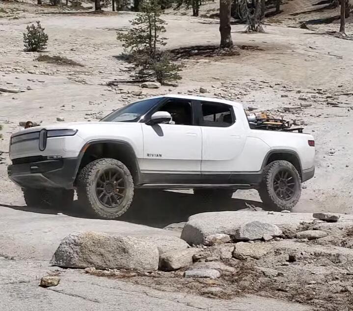

So, I learned on this trip that when you flex out a R1T, you get these neat symmetric creases on each side of the bed from the chassis flex. Just a word of warning for anyone who decides to start crawling their truck, I'm pretty sure this isn't fixable. Also, my paint needs detailing.
Rivian R1T R1S Rubicon Trail: 1, Rexbo R1T: 0 1728964557940-bv
Rivian R1T R1S Rubicon Trail: 1, Rexbo R1T: 0 1728964588465-7

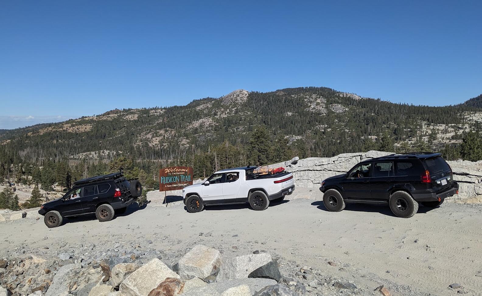

We get to the Rubicon trailhead have some breakfast while admiring the great view. Goal for the day was get to Buck Island Lake (midpoint-ish). Hopeful at best, foolhardy more likely.
Rivian R1T R1S Rubicon Trail: 1, Rexbo R1T: 0 1728965179526-ru
Rivian R1T R1S Rubicon Trail: 1, Rexbo R1T: 0 1728965369757-r9
Rivian R1T R1S Rubicon Trail: 1, Rexbo R1T: 0 1728965067710-9s
(yes he got some steak, I'm an idiot, not a monster)

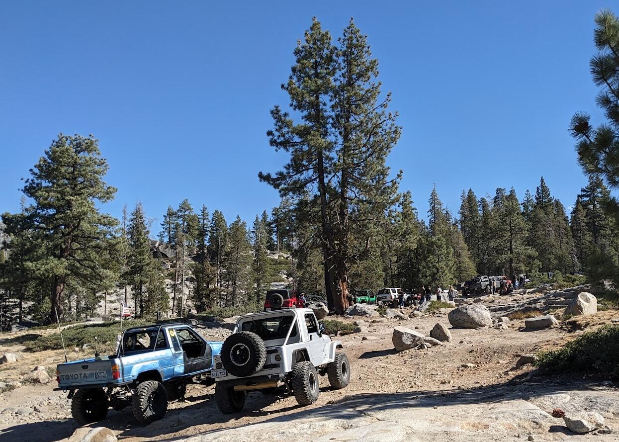

As we sit there, a line of probably 30 near-stock jeeps rolls up and onto the trail right in front of us, as part of some event or school. We head onto the first 200 yards of the trail, where we then park for an hour waiting for everyone to get through Gatekeeper. Off to a great start.

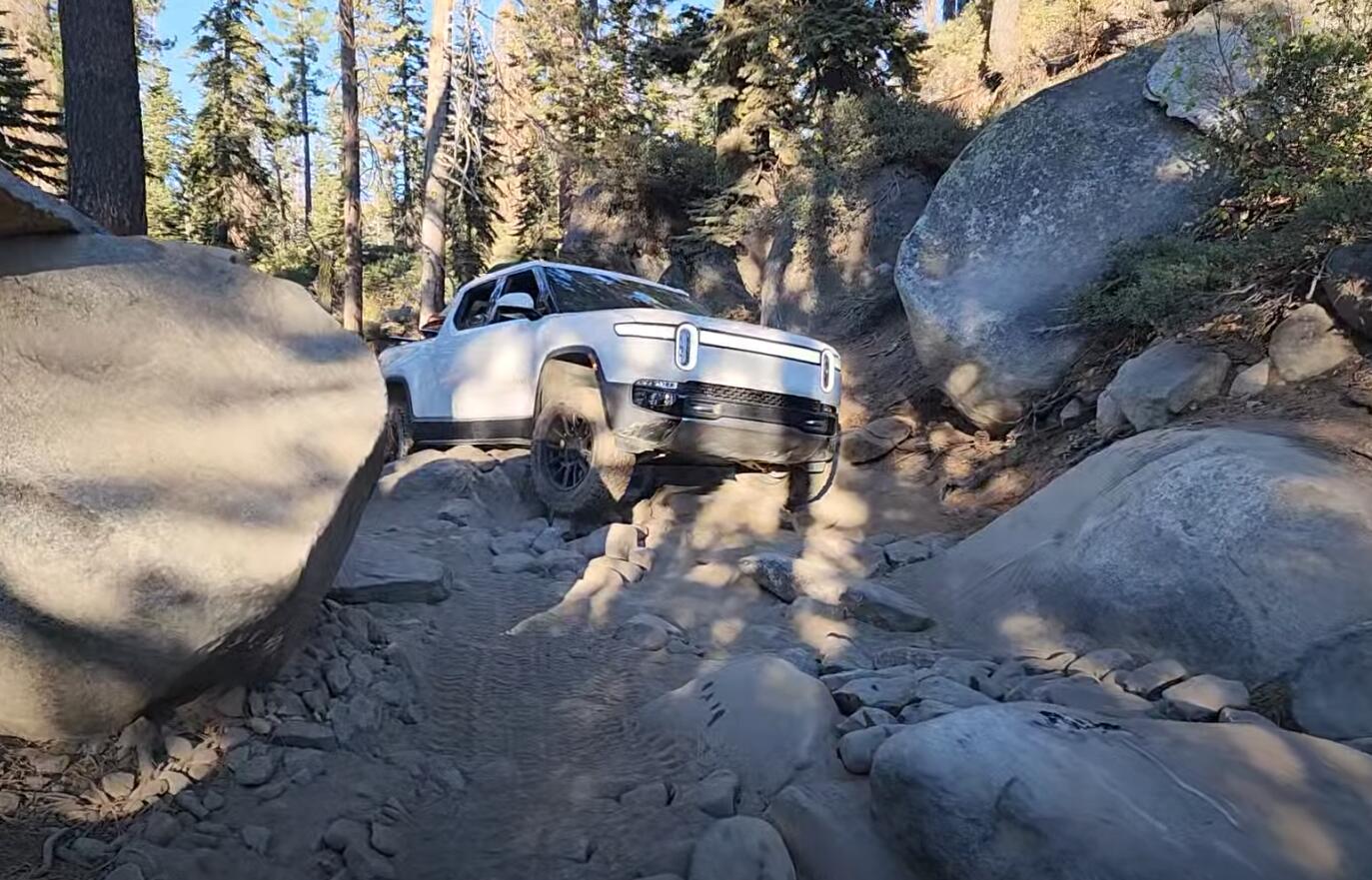

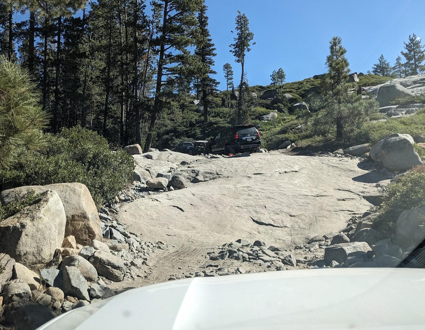

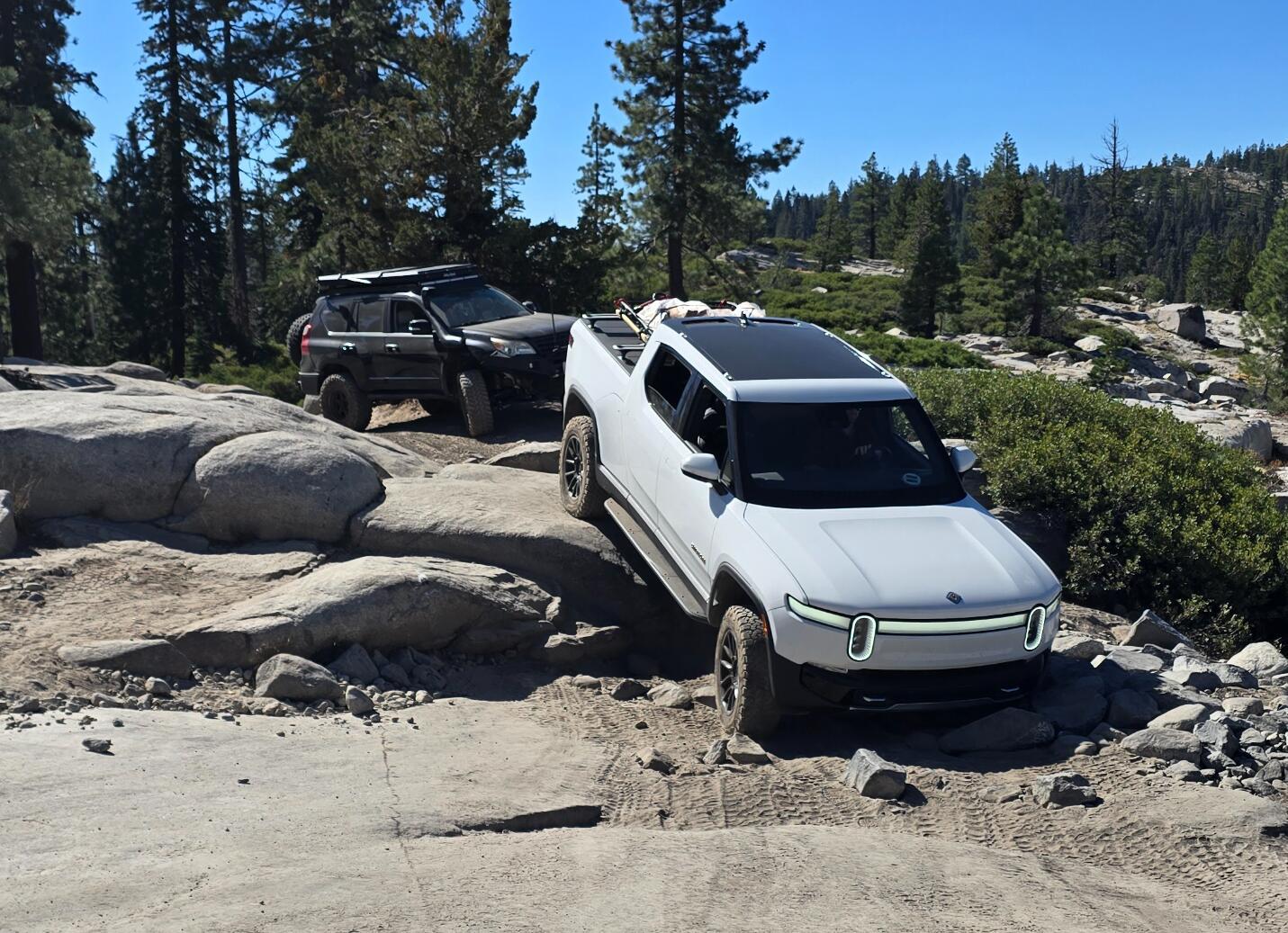

Down into the granite bowl up the ledges and over to whale bones no problem.
Rivian R1T R1S Rubicon Trail: 1, Rexbo R1T: 0 1728965879772-0n

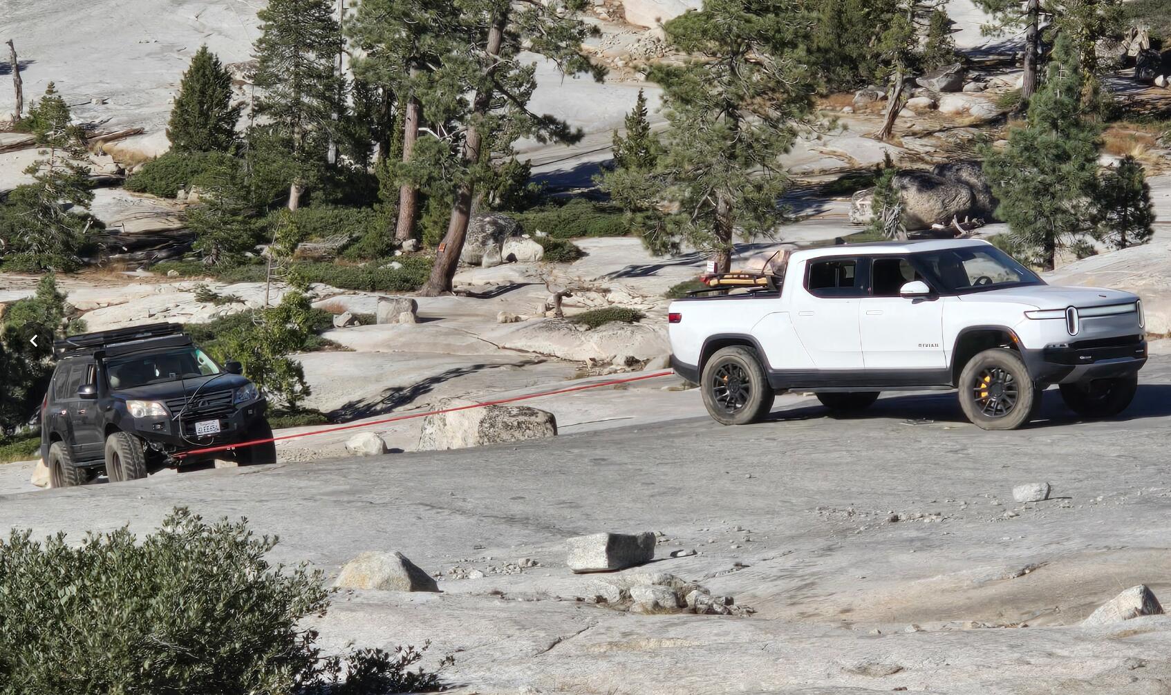

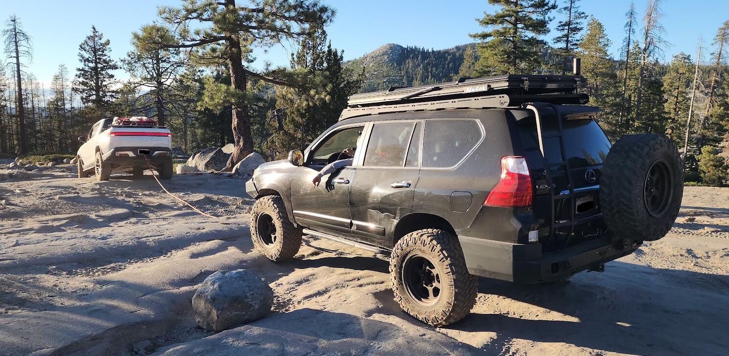

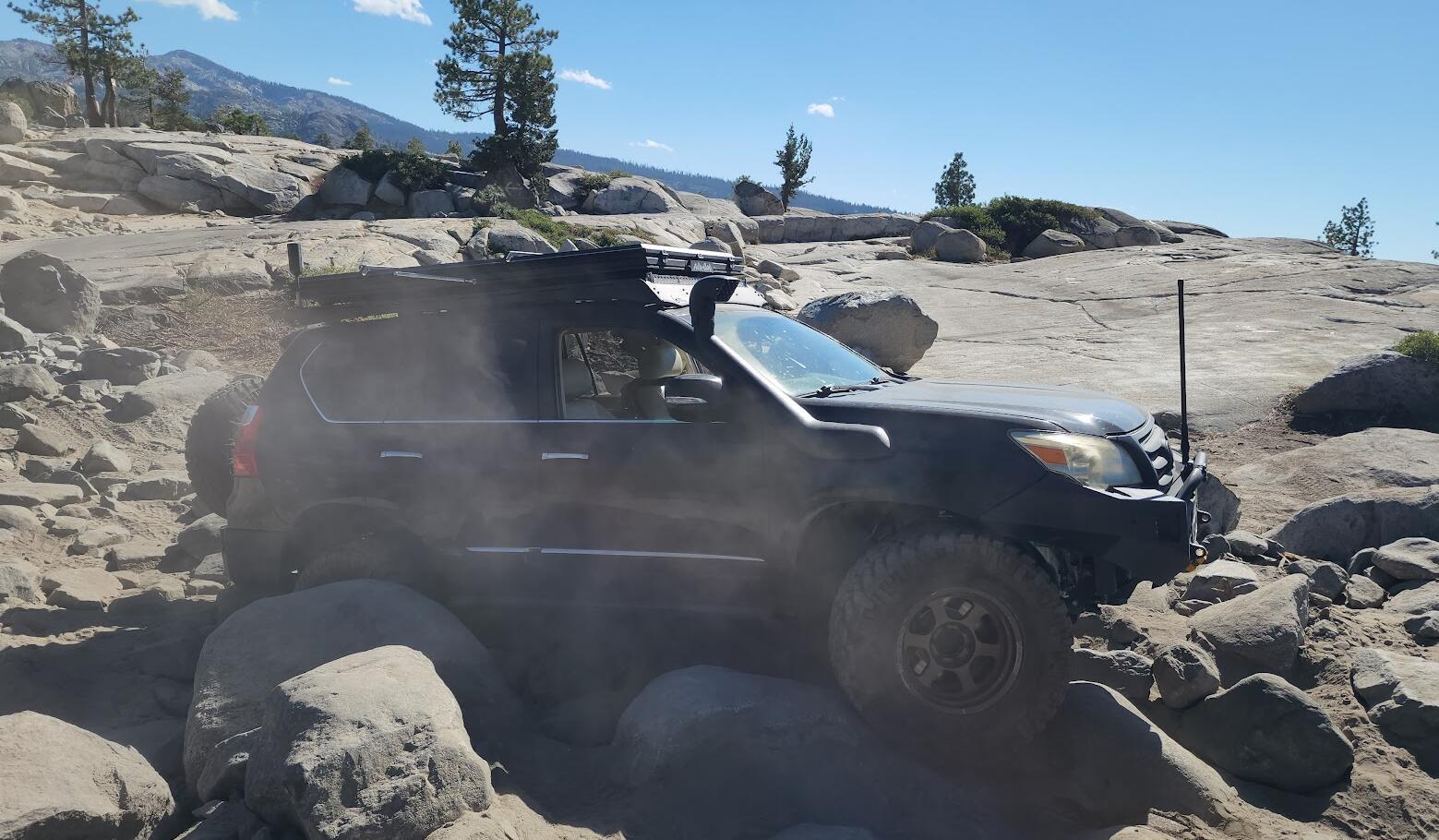

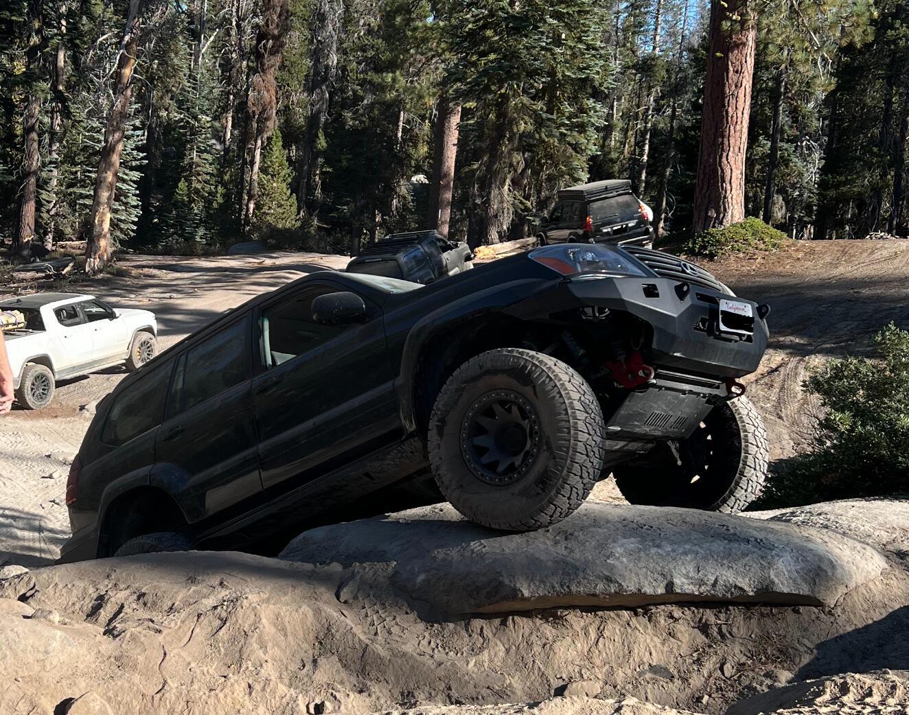

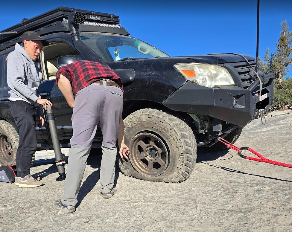

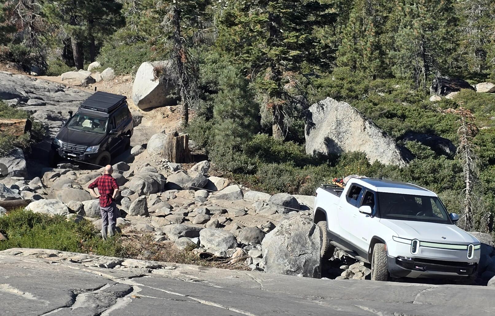

Now the fun begins. Two of us get up whale bones, and the last GX coming through the rocks donates to the rock gods a rear differential in the middle of the obstacle. It now has front wheel drive only, with the ATRAC extremely unhappy to let it use any power without seeing any movement of the rear wheels, rendering the Lexus effectively immobile under its own power. Now the plan goes from Buck Island Lake, to getting back out to Loon Lake trailhead since we haven't even made it to the first mile marker.
Scene of the crime:
Rivian R1T R1S Rubicon Trail: 1, Rexbo R1T: 0 1728966071619-7a

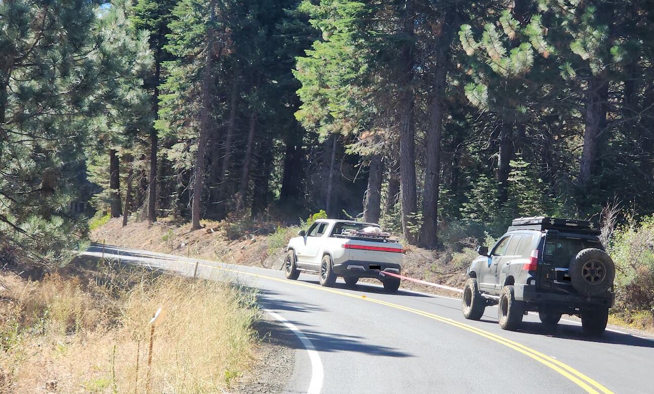

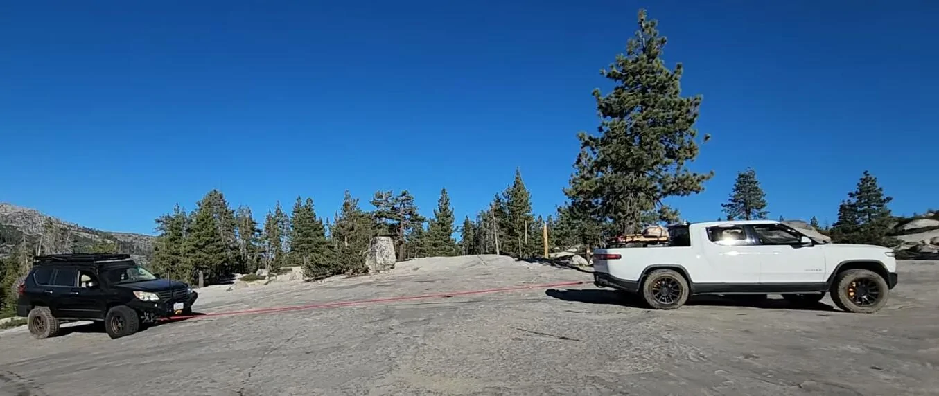

So, in our infinite wisdom, we decide that the Rivian, to make up for everyone thinking would be the one to break, and by nature of having the most torque in the group, gets to be the official tow vehicle all the way back out. I then got the honors of dragging the GX up the hill, then back down through the rock garden. As it turns out, it's a GREAT tow vehicle.
Rivian R1T R1S Rubicon Trail: 1, Rexbo R1T: 0 1728966357584-
Rivian R1T R1S Rubicon Trail: 1, Rexbo R1T: 0 1728966597931-6c
On the way, the GX's no good, very bad day, decided to take a fun turn. Complimentary ass shot:
Rivian R1T R1S Rubicon Trail: 1, Rexbo R1T: 0 1728966701955-vi
And we're on the move again with that Carolina squat:

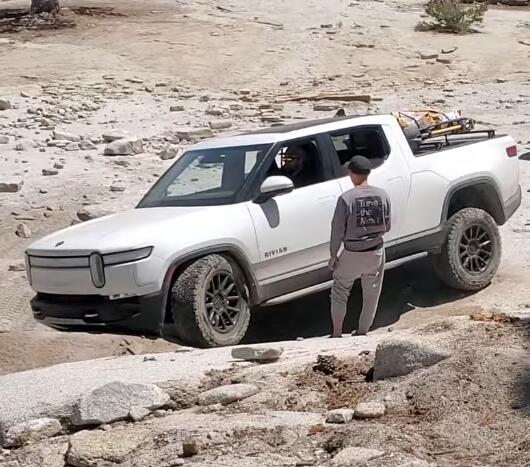

Back to gatekeeper and time to pull this 6300lb hunk of metal through the rocks. I gotta say, it was a lot easier to just do the obstacles without having a boat anchor on the back.
Rivian R1T R1S Rubicon Trail: 1, Rexbo R1T: 0 1728967057421-jc
Rivian R1T R1S Rubicon Trail: 1, Rexbo R1T: 0 1728967122469-8
Rivian R1T R1S Rubicon Trail: 1, Rexbo R1T: 0 1728967194597-j2
Rivian R1T R1S Rubicon Trail: 1, Rexbo R1T: 0 1728967448342-w4

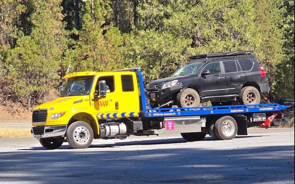

We made it! Back out the trail head 3 hours after breaking down, we decided it was time to make camp and have ourselves a consolation bbq and some tasty beverages to wash down the disappointment.
Rivian R1T R1S Rubicon Trail: 1, Rexbo R1T: 0 1728967583213-wa
The next morning, after setting up the Starlink, making a few phone calls and doing some additional diagnosis, we decided against attempting a trail repair or bodge job, and that the best thing to do is call someone with a nice Yellow flatbed truck and take it to a friendly 4x4 shop in San Jose. The new problem being, the shop was 237 miles away, the AAA limit is 200 miles, in addition to a $1000 premium to get to the trailhead. So, being the cash-strapped but fearless morons we are, decided that RiRi needed to save the day once again. Towing was a breeze, but using the GX brakes to stop effectively 13k lb of rolling mass was less fun, some fun coordination was had on the long windy drive down.
Rivian R1T R1S Rubicon Trail: 1, Rexbo R1T: 0 1728967994187-tv
Sad days indeed, but the GX will be coming back with new front and rear locker, re-gearing and hopefully beadlocks next time.

  • This truck is NOT a good rock crawler. It will do the things, but it's not going to be pretty. As noted by many others, it really struggles to get a predicable speed over obstacles, often going from no movement to wheel spin, to lurching over the obstacle. This is especially bad when a wheel is off the ground with no resistance. The best technique I could figure out was to apply light constant pressure on the brake, and attempt to modulate throttle to minimize lurch, with only slight success.
    • Feedback to Rivian: I don't know how it could be done, but I'm sure there's a way to reduce overall wheelspeed in rock crawl mode. The jerkiness is really tough to deal with.
  • Also noted by many others, the front wheel lateral walk is challenging. The computers want to send more power up front first, so it'll spin the front wheels (lower coefficient of friction) before sending more power to the back. I see now exactly how tie rods get bent, since it will often slip the spinning wheel right off a rock and into whatever catches it.
    • Feedback to Rivian: Rock crawl needs more rear power bias. Not a ton, but definitely 5-10% or so.
  • This truck just doesn't have enough ground clearance for this trail. I think it has enough tire, but there's too much stuff around it, and my front and rear bumper corners paid the price. This thing is begging for aftermarket bumpers. I might need to do this the hard way.

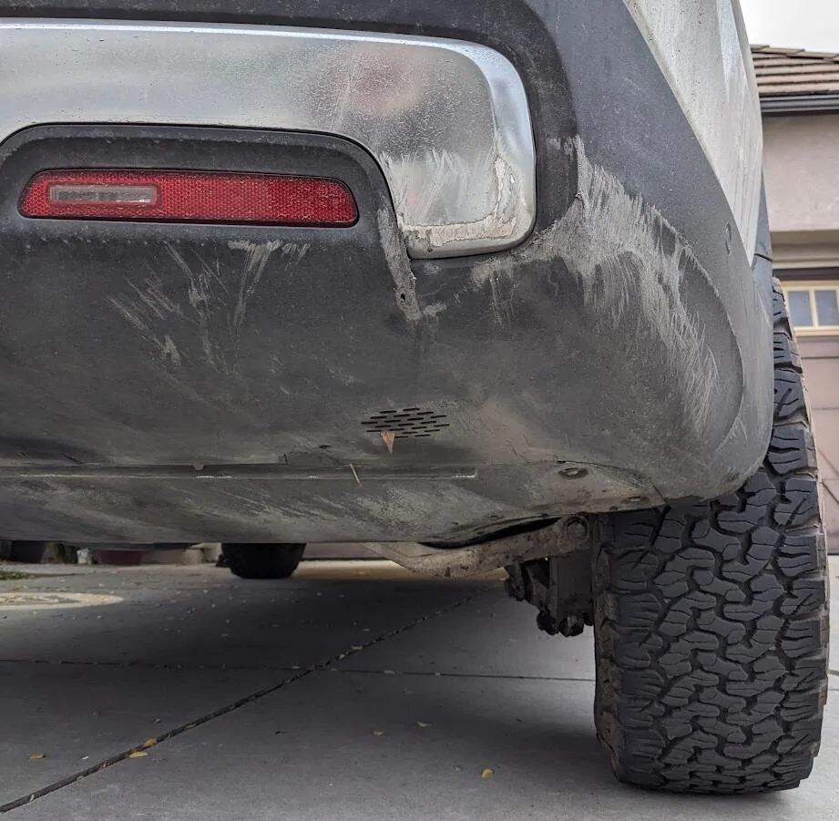

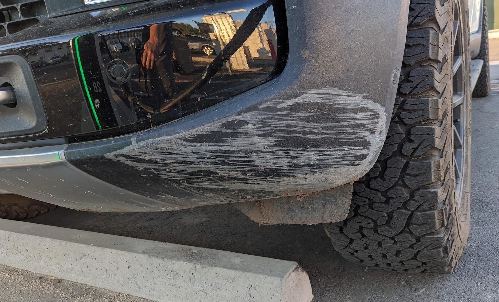

  • Also, the rear truck bed crease at full flex is a concern. I get it, but still that's a little rough, all things considered.

I'd think the wrinkles were probably caused by putting weight on the bumpers, or we'd see this a lot more than we have.
Rexbo
Rexbo
Oct 9, 2022
98
384
Had that thought as well... But none of my bumpers were scuffed before Rubicon so kinda crossed that one off the list. The only other variable were the DCE sliders bolted to the frame, but that makes less sense.
Mystery wrinkles: part of the aging process.

I'm also a bit confused by the wrinkles. Like @Dark-Fx I'm having trouble seeing it coming from just flexing out the suspension.
There's also the possibility it's from my hitch skid dragging, but again we would then probably see it on trucks that tow a lot with heavy trailers. A a total mystery!
Just guessing here but likely it's the hitch dragging/dropping on rocks as the wrinkles appear to be caused by an upward force, not sure if you had a bunch of hard landings. With towing the force would be backwards and down.
