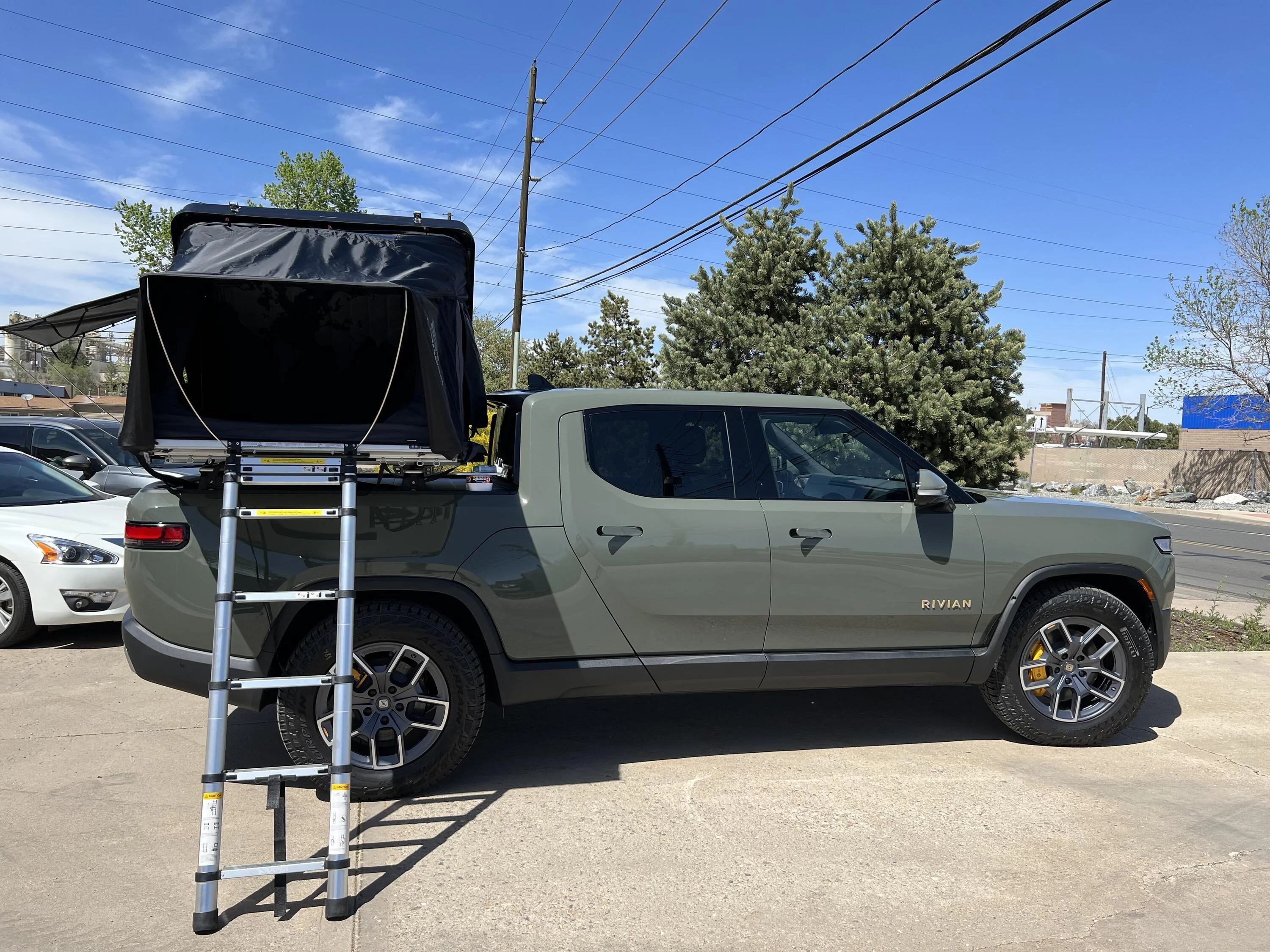

Ah that would look quite interesting. I have the regular sized condor I’m going to just put over the bed

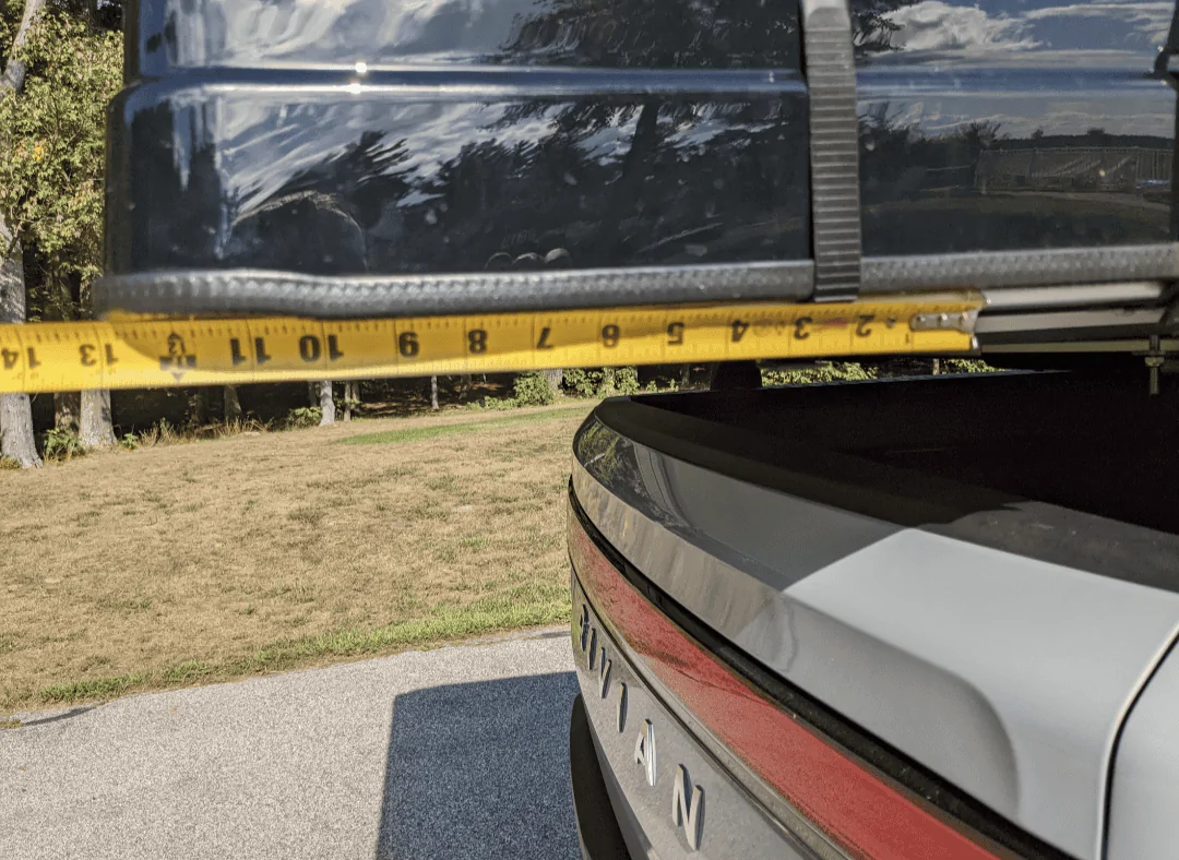

I’ve been thinking about this also. I think the perfect max length over the bed seems to be 60-65”. I believe the Condor XL is 74” long so would stick out at least 9”. Someone posted pics on Fb of an R1T with overhanging tent and it seems okay if your only mounting it for trips. I’m thinking of leaving my tent attached to cross bars so I can easily snap the whole tent on or off. Thoughts?
agame32
Aaron
Oct 19, 2021
243
237
R1T, Model Y
Rivian R1T R1S Roofnest Condor XL on an R1T Roof? gyk7xj20zry81
Here’s a perfect side shot of the 60” Condor. The Condor XL is 14” longer so I don’t think it will work.

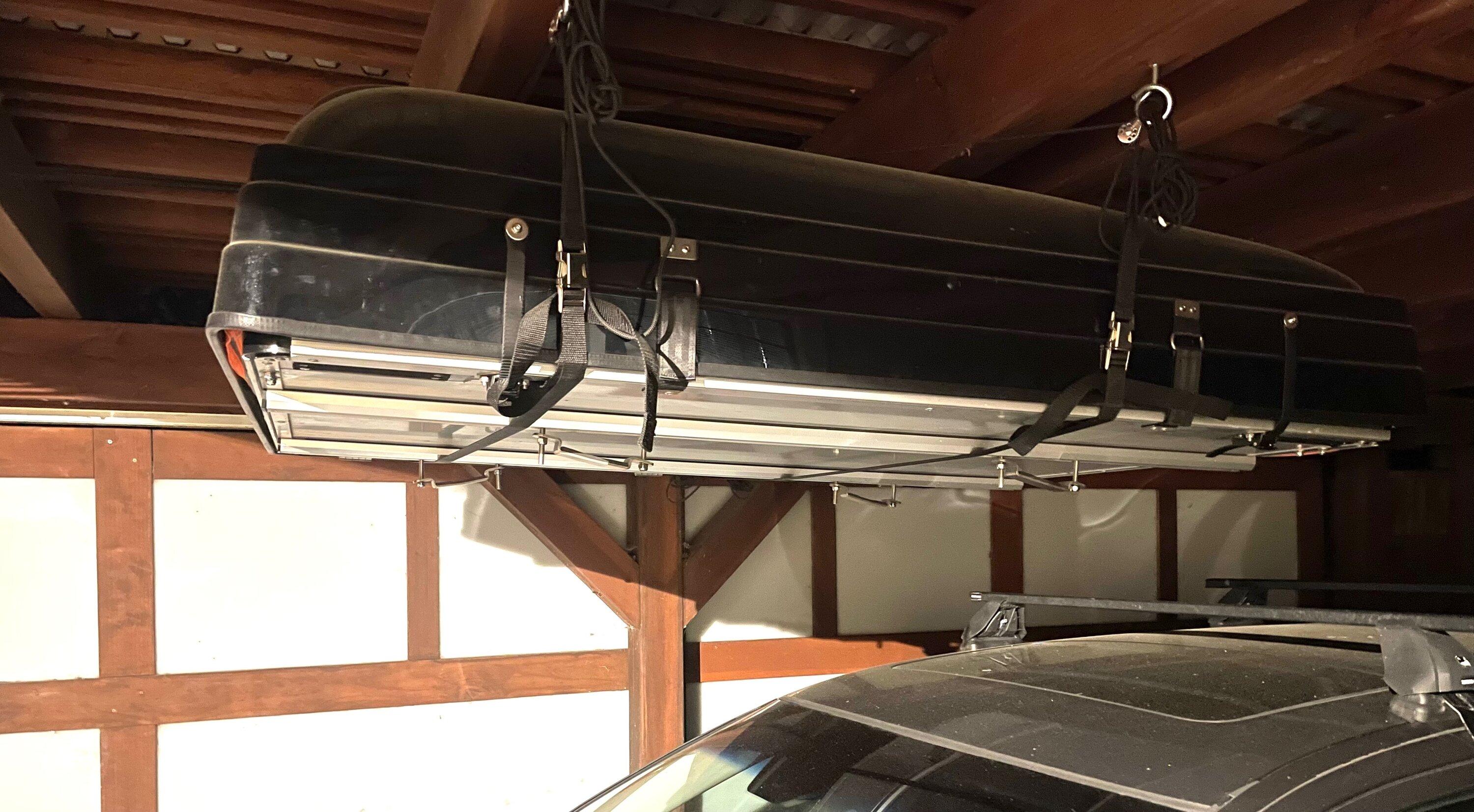

AllInev
Nov 22, 2021
1,039
1,659
Oakland, CA
Prius V, R1T
Keep in mind that the 60" Condor is 135lbs, so you'll need at least two people to get it on and off the truck. I use a pulley system for Condor.

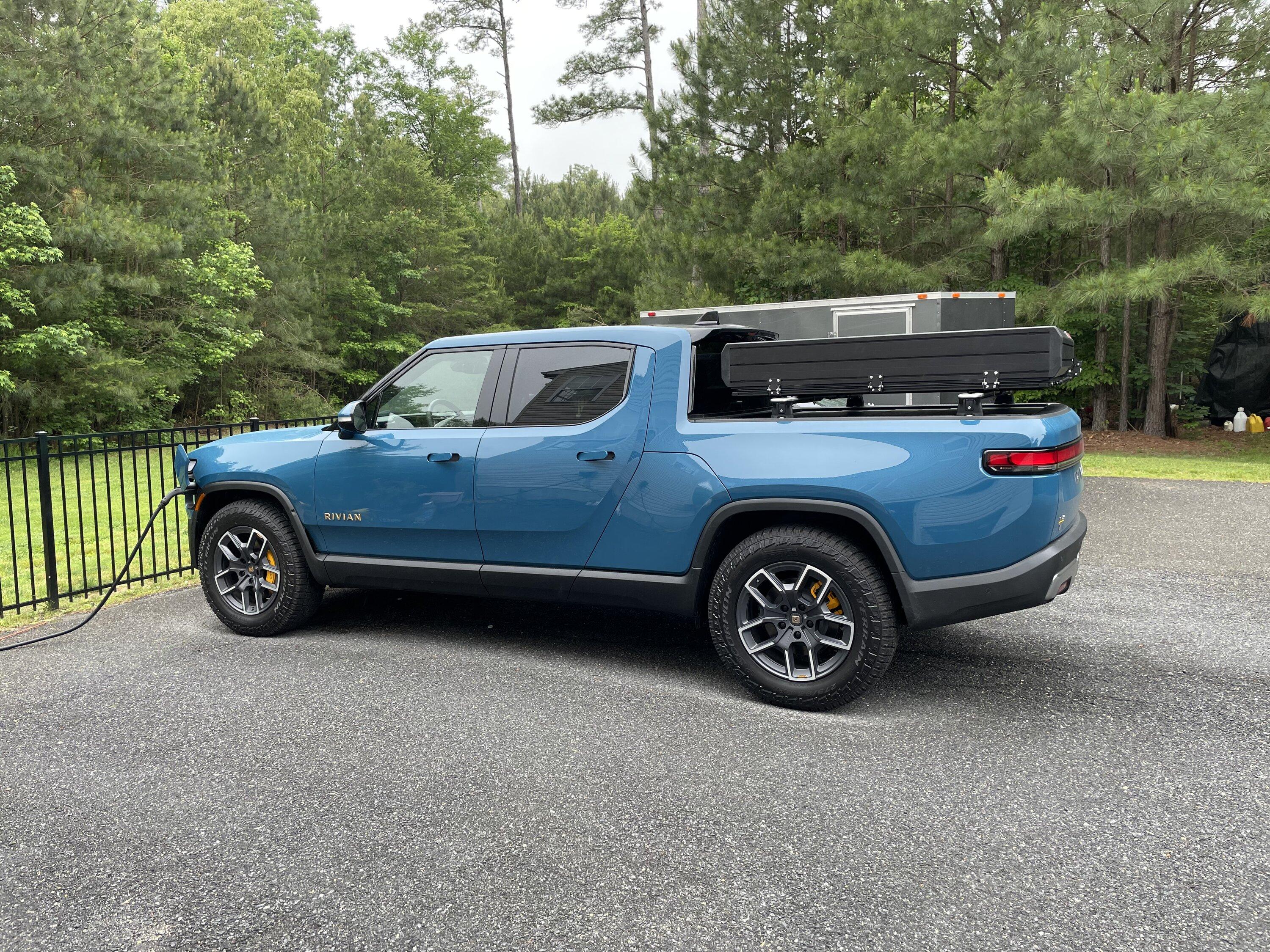

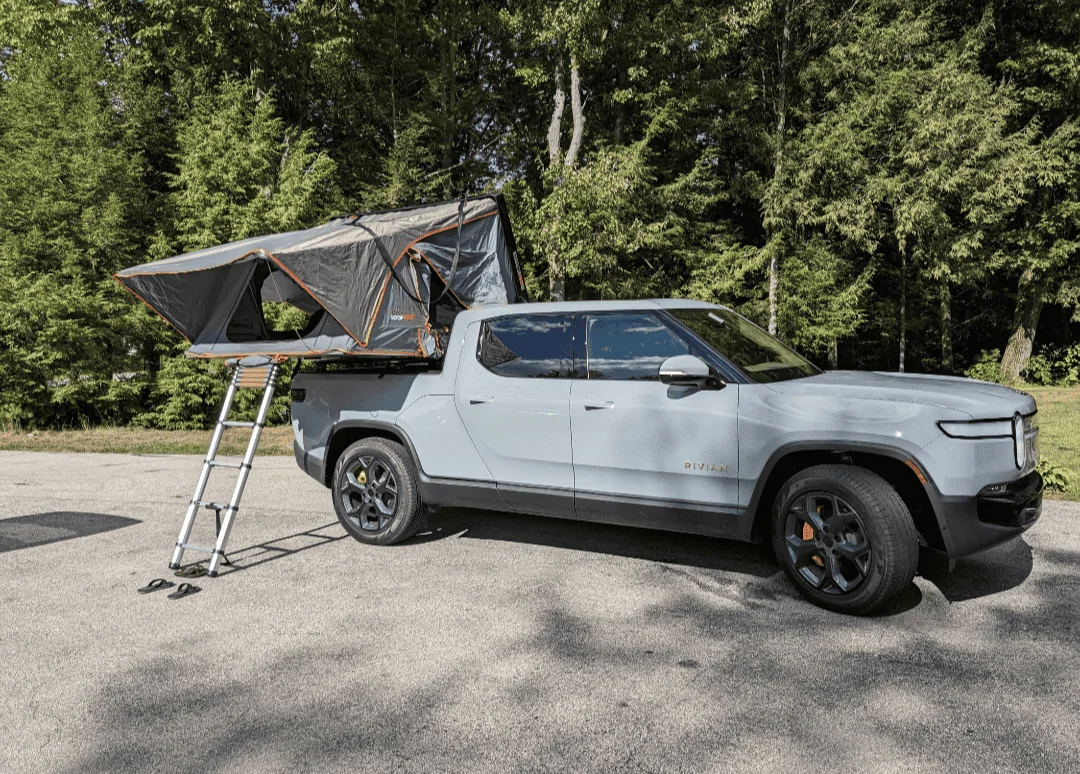

This is what the Condor Overland looks like on the back of the R1T.
Rivian R1T R1S Roofnest Condor XL on an R1T Roof? IMG_3174
Rivian R1T R1S Roofnest Condor XL on an R1T Roof? IMG_3170
How is this setup working for you? I am thinking about doing this exact setup with the Yakima roadshower on the roof.
Works great

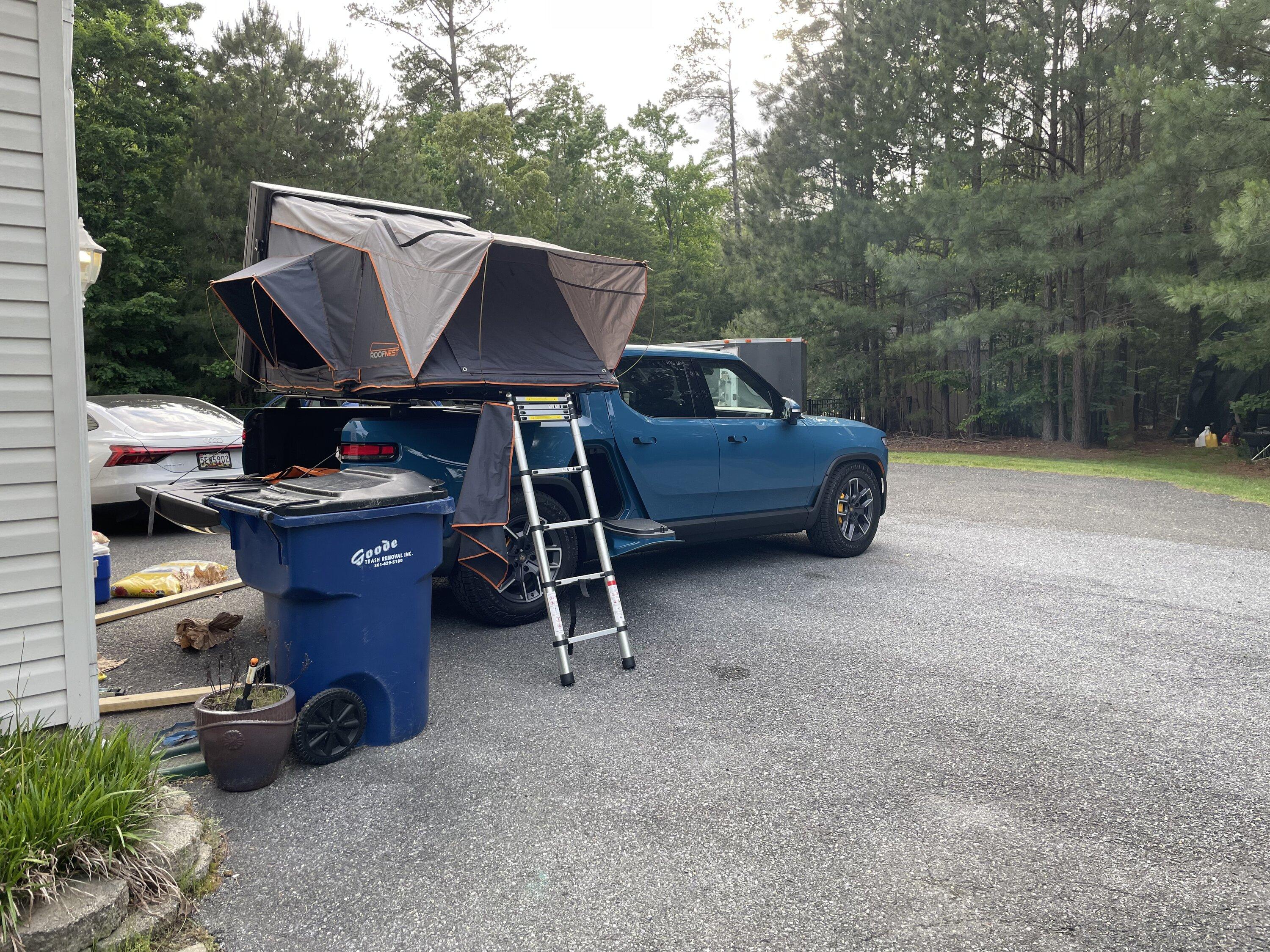

ElectrifiedOverland
Eric
Jul 28, 2022
181
NH
Rivian R1T, Porsche 911, Mercedes ML350
Pilot

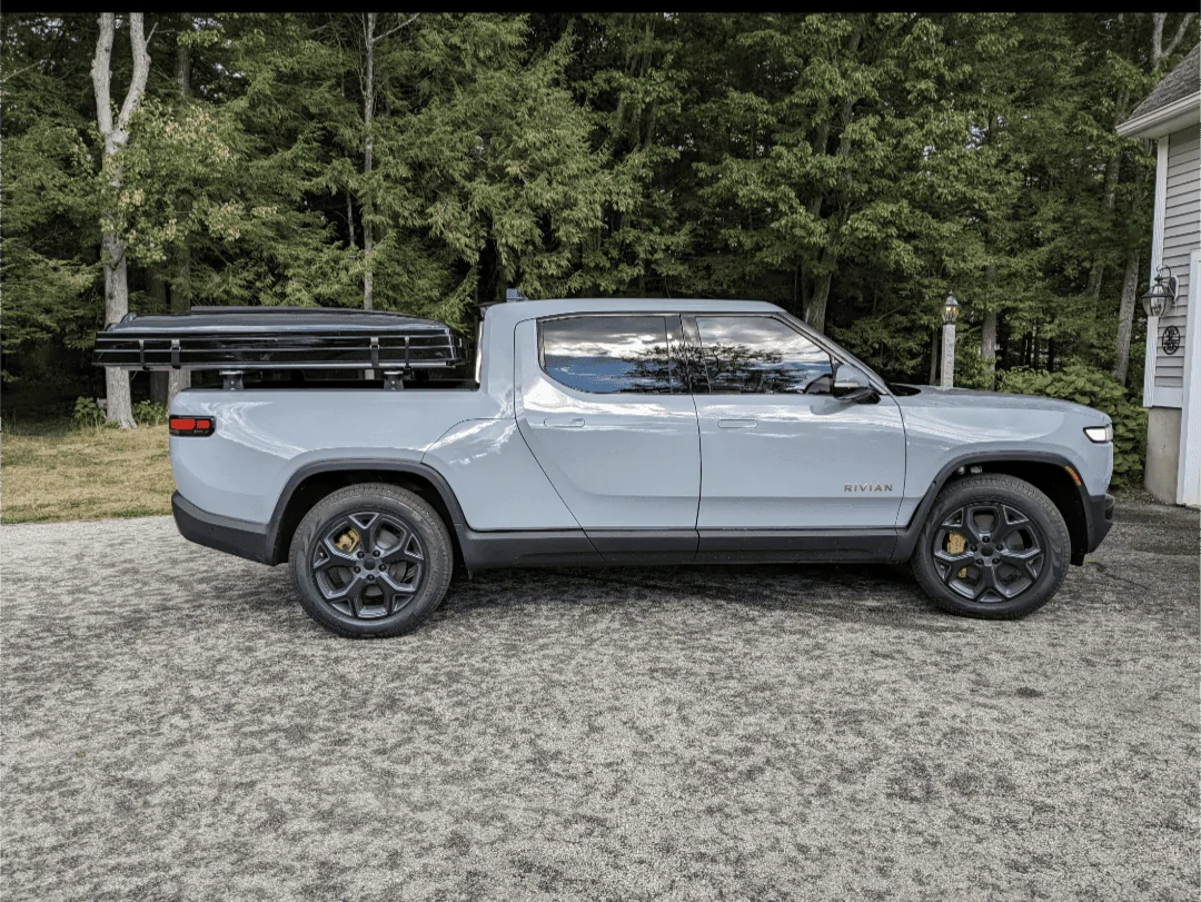

We have a Condor XL because the kids are too big to fit with us in a smaller tent but not big enough to be out in their own tent. It's not perfect and I'd prefer a more flush fit, but the floor of the tent is rigid enough that it hasn't been a problem to have the crossbars off center.

Before you consider an oversized tent, you need to find out how much of it’s length can be unsupported. I had an iKamper Xcover that extended some 30” past the rear crossbar. iKamper recommends that this be no more than 25” or the honeycomb aluminum could buckle when someone is in the tent. I suspect this could be the case with the Condor XL and the reason I sold my XCover and replaced it with a SkyCamp Mini.
Before we bought ours I contacted Roofnest about this. They said the amount of overhang (about 25") and offset on the bed mounted bars is not an issue structurally. The roof mounts are a little further apart and you could have it centered, so that would definitely not be an issue.
