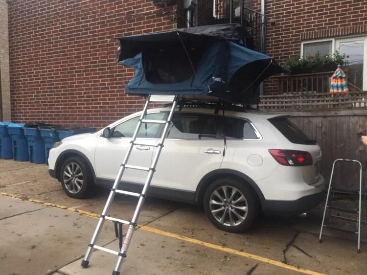

Thule Tepui Explorer Ayer 2 (cripes they need to work out some new naming conventions)
But I suspect pretty similar to the custom one they've demoed with the R1T. The one complaint in reviews was the mattress so we never gave it a fair shake and just added an extra layer that we don't have to remove when packing it up. Very comfy. Very easy to open it up into more of an all-screen dome which is awesome in the summer. Once you've done it a couple times, pitching and packing up are really easy.
Don't put it together and attach it to the top of a Mazda CX-9 by yourself if you don't have to. I think I lost 10 lbs that day. Looking forward to some lengthy road trips with it as vaccines get better-distributed but also hoping to start camping in IL again soon.
