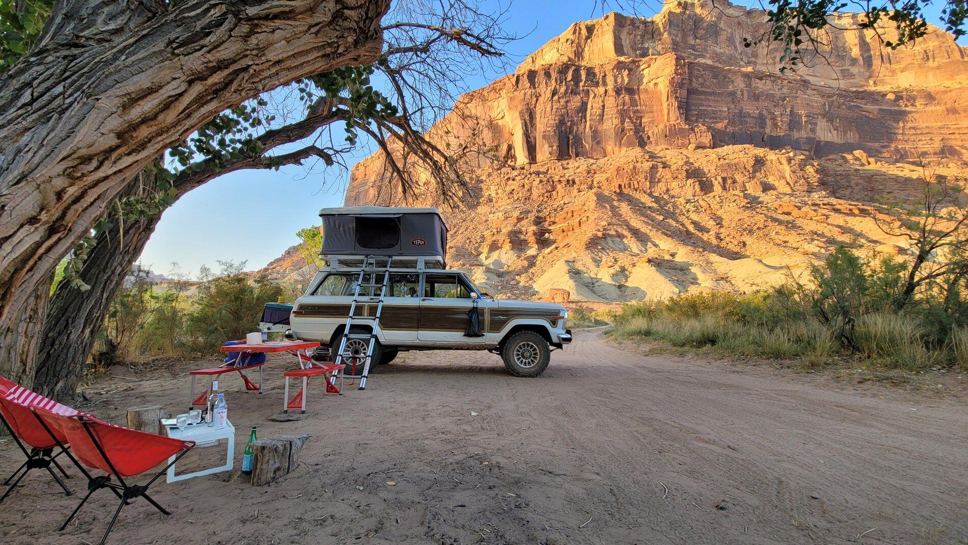

Highly recommend the Tepui Hardshell, automatic opening, nice ladder,, very comfortable mattress, and above all trail proven for many off road miles on my Grand Wagoneer. Heavy though, 170 lbs. I think white as seen in photo is no longer an option.
