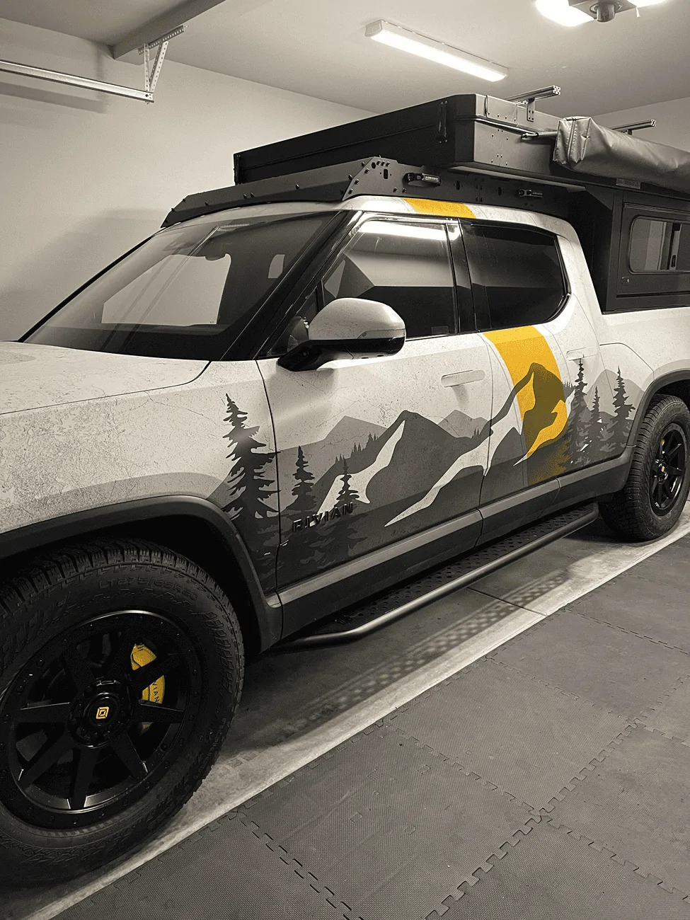

For my use I have definitely hit my sliders many times from the side and the bottom (rocks, tree branches, etc) that would have done damage without them. They have been great. Regarding weight, not going to make a difference in range at all more of a payload concern for me.
People will talk about plates underneath to replace the plastic ones. IMO opinion they offer no protection that is needed and may make a cleaner look but that's it. If anything they will just collect debris.
Rivian R1T R1S Rock Slider Comparison? 1724081967967-xw
