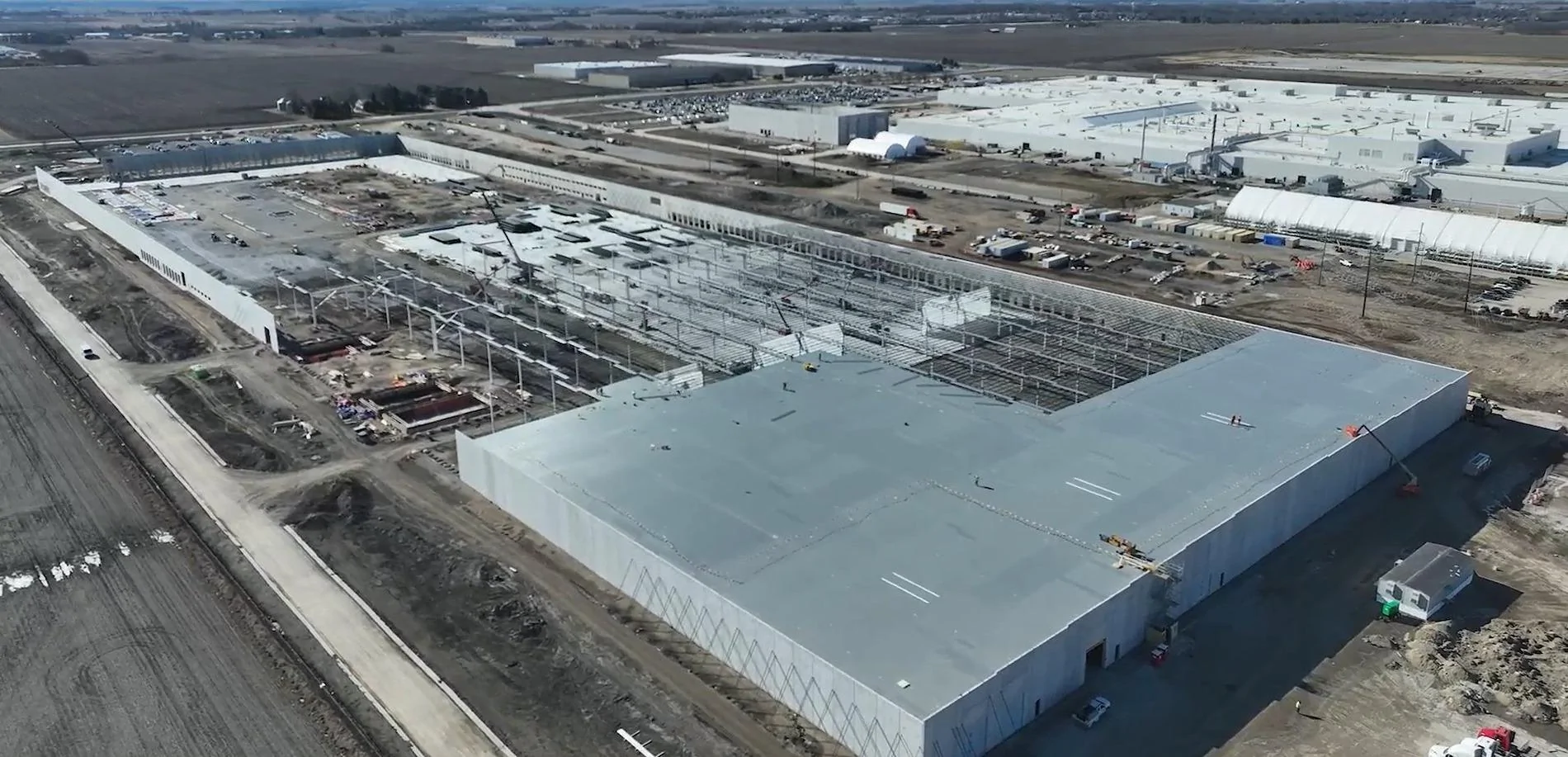

Looking good, but based on that photo, shipping a customer ordered vehicle in 2Q26 is going to be a challenge, let alone 1Q26.
6,126
12,120
Looks are deceiving. By that stage with that type warehouse the construction is almost done. All the work is in the grading and in the slab. There's only roof drains, HVAC and electrical hookups of equipment. All the feeder wires are already ran in the slab. It goes quick from this point. Having it completed and operational by 2026 isn't a pipe dream from what I can see there.
This is what our engineering company does - we design, build (subcontracting the building envelope) and then we fit out electrical, process piping, communications, controls and process equipment using our crews and subcontractors for various types of food and beverage facilities, as well as a few other non-F&B one-offs. We program the automation PLCs and HMIs, commission and start up production. I've lived this for 100 years over the past 30+ years, lol.
As I said, it will be a challenge, I didn't say it wasn't possible. Everything has to execute exactly as planned. If a customer vehicle (I specifically stated that meaning not test/demo/employee vehicles) is going to ship around March/April 26, that means EVERYTHING has to be completely built out and ready for line integration testing by November or December 2025. Test vehicles coming off the line starting in January. Production lines of this complexity typically take 2 to 4 months or more to commission, startup and produce sellable end user product that passes QC - Rivian has already shown us that they are challenged by this to this day.
That's fair. My experience comes from the building envelope side. From that respect, the project is almost done. I have no experience setting up these sorts of lines, though, so I'll defer to your expertise in that regard.

I am wondering if they are making this structure “PV Ready”. That is, are roof loading, electrical infrastructure, etc. being taken into consideration for this taking place in the future.

Considering when the expansion was announced, construction is much further along than I anticipated. With that, I most definitely believe that R2 deliveries will commence in 2026. Q1 might be a stretch, however spring/summer is not an unreasonable expectation.
