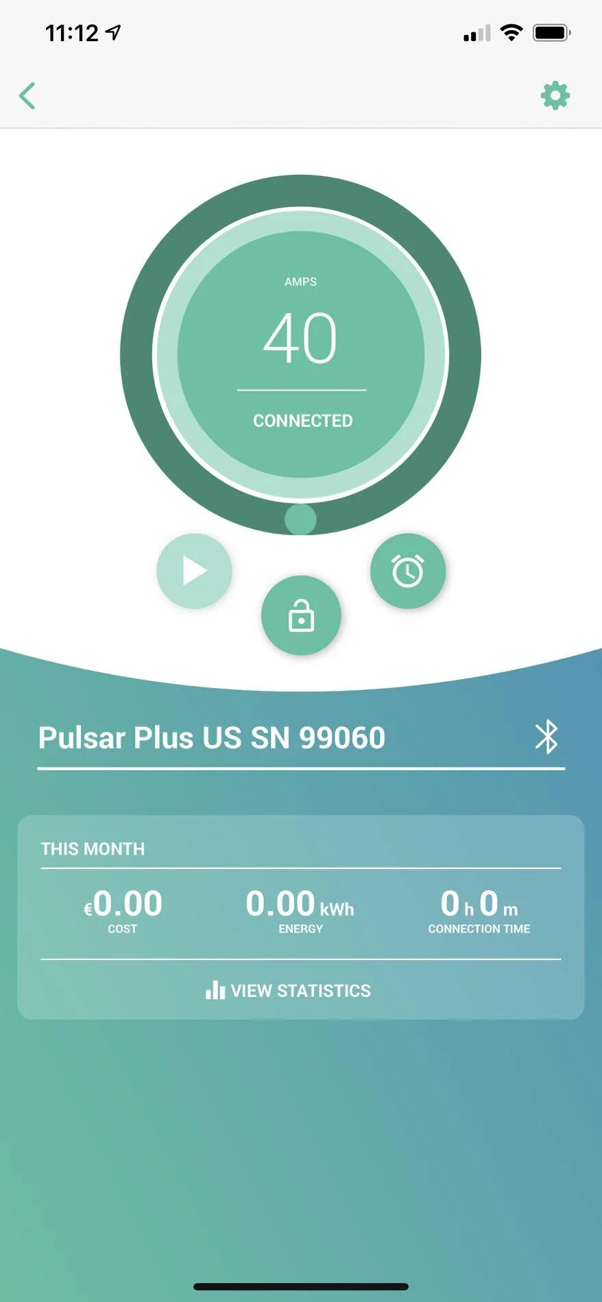

Yes, the Pulsar Plus does seem like a good unit. There is one caveat that goes with it, however. There is an exception in the NEC which allows a NEMA 14-50R to be installed on a 40 amp or 50 amp circuit. If installed on a 40 A circuit the maximum allowable charging rate is 32 A. This is why the later generation Tesla UMC with the 14-50R adapter only delivers (or, to be precise, allows the car to take) 32A (earlier versions allowed 40). As you can see from the screen shot below the app allows one to dial in 40 A as the maximum charging rate even though he might be plugged into NEMA 14-50R wired to a 40 A circuit.
Thus it becomes the responsibility of the consumer to check the circuit into which he wants to plug the Pulsar. I guess if he plugs it into a 40A circuit he is in violation of NEC.

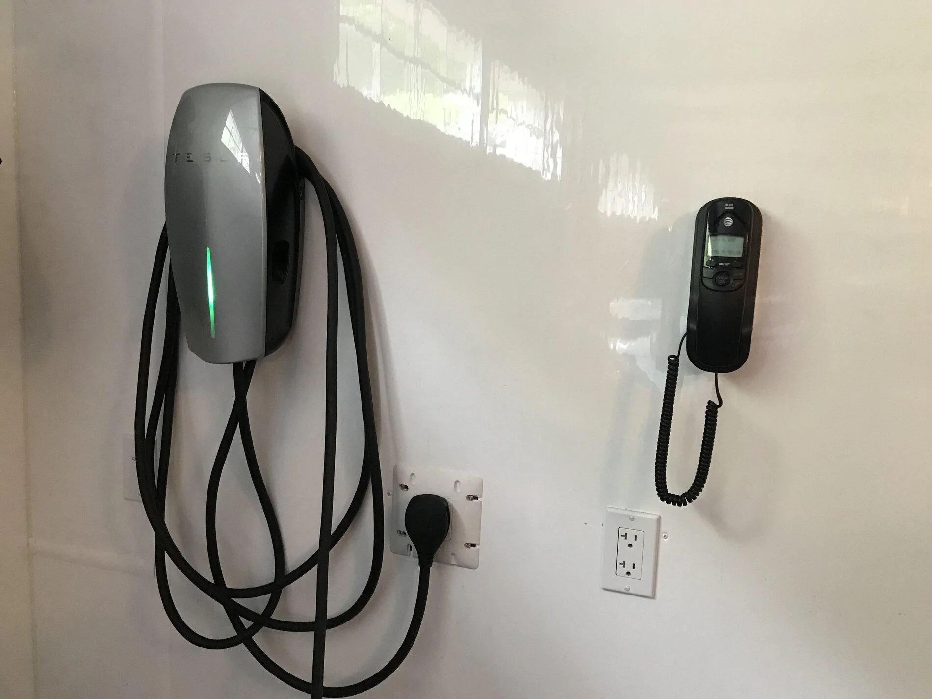

This all suggest that the Rivian unit may not be made by WallBox as it is capable of 48 A charging and the Pulsar Plus, the only thing Wallbox is selling in the States that I know of, is plug in and thus only capable of 40 A. In choosing the Pulsar I limited myself to less than the maximum the Rivian (or Tesla) could take but decided to go that route as I thought the WallBox capable and reasonably priced. I installed it hard wired as I think that makes for a slightly neater looking set up. Not that plug in units aren't neat too. Here's a pic of a plug-in Tesla HPWC (they no longer offer a plug in version)
What is that other funny looking device on the right side of the wall????

EE Retired
