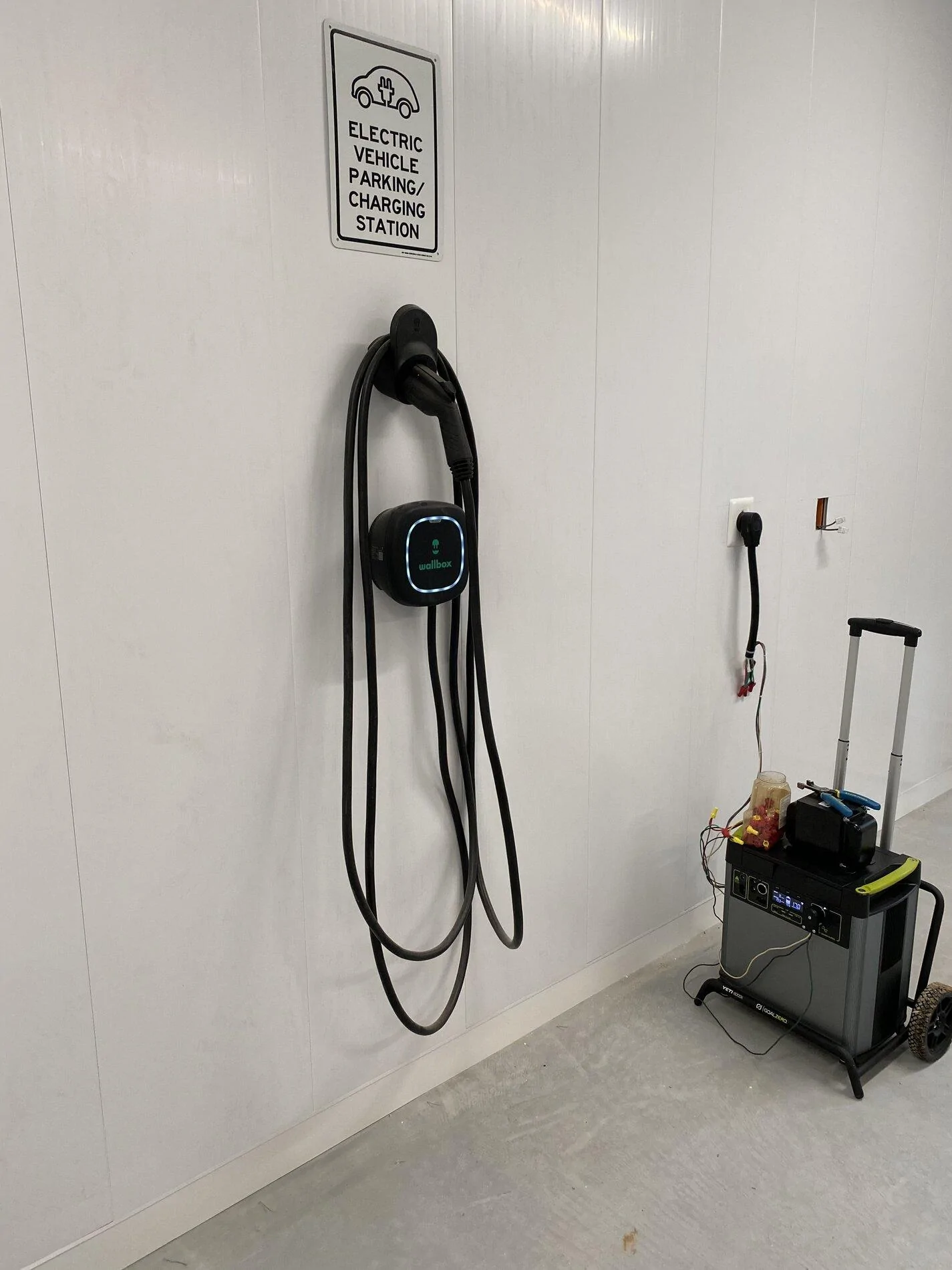

When I got my first Tesla I would not have wanted to venture out on a road trip without the UMC (Universal Mobile Connector) and my vast collection of adapters and extension cords on board. While I am now much more secure and the SC network has been enlarged substantially I still go places where the SC network has not yet reached and so I still carry that stuff and I still think the UMC belongs in the car. So I have wall chargers. They can, in new, or even old construction, make for
a really neat installation and it's hard to beat the convenience. The unit in the photo is a WallBox Pulsar Plus which is what they are selling in the US now. Certainly the Rivian unit is not a Plus in a case with the Rivian logo on it and the pistol seems to be a different shape but that does not mean that Rivian has not contracted with WallBox. WallBox seems a good candidate. But of course the Rivian offering could be made by any of numerous manyfacturers, Note that I also have a 14-50R. There are several "chargers" (technically they are EVSE) on the market that can plug into a 14-50R and deliver 40 A charging. Some of these can be affixed to the wall and others are portable. Also note that the 14-50R is being used here to "back feed" the building so I can have some lights in there while I'm working and, of course, test and commission the EVSE. This building is NOT connected to the grid. DO NOT DO THIS IN A GRID CONNECTED BUILDING. Better yet DON"T DO THIS.

Yes, the Pulsar Plus does seem like a good unit. There is one caveat that goes with it, however. There is an exception in the NEC which allows a NEMA 14-50R to be installed on a 40 amp or 50 amp circuit. If installed on a 40 A circuit the maximum allowable charging rate is 32 A. This is why the later generation Tesla UMC with the 14-50R adapter only delivers (or, to be precise, allows the car to take) 32A (earlier versions allowed 40). As you can see from the screen shot below the app allows one to dial in 40 A as the maximum charging rate even though he might be plugged into NEMA 14-50R wired to a 40 A circuit.
Thus it becomes the responsibility of the consumer to check the circuit into which he wants to plug the Pulsar. I guess if he plugs it into a 40A circuit he is in violation of NEC.
This all suggest that the Rivian unit may not be made by WallBox as it is capable of 48 A charging and the Pulsar Plus, the only thing Wallbox is selling in the States that I know of, is plug in and thus only capable of 40 A. In choosing the Pulsar I limited myself to less than the maximum the Rivian (or Tesla) could take but decided to go that route as I thought the WallBox capable and reasonably priced. I installed it hard wired as I think that makes for a slightly neater looking set up. Not that plug in units aren't neat too. Here's a pic of a plug-in Tesla HPWC (they no longer offer a plug in version)
