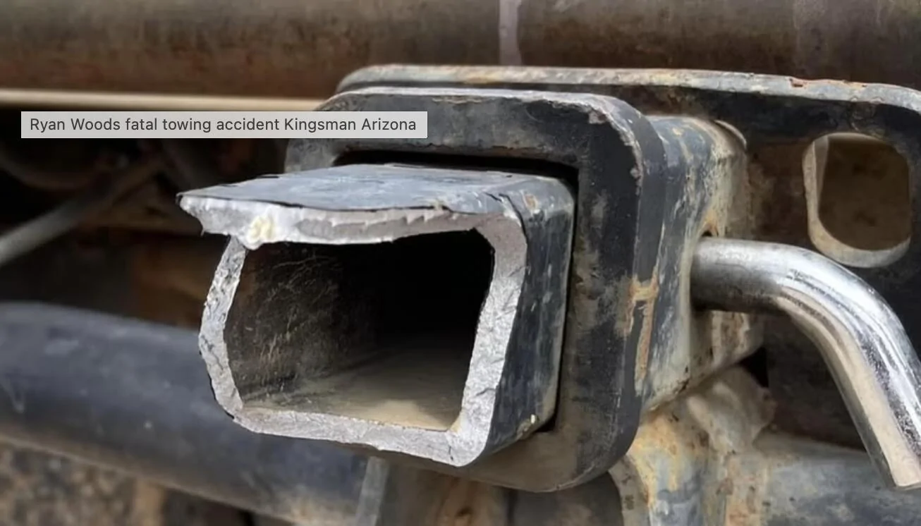

PSA - As others mentioned, get proper shackles, hitch adapter, etc. for this gear. NEVER EVER put a recovery strap on a standard trailer hitch (the tube/ball assembly that goes into the receiver). While it may seem safe, they are not made for the stresses of vehicle recovery and in a few cases have snapped, become a flying object and injured or killed someone.
