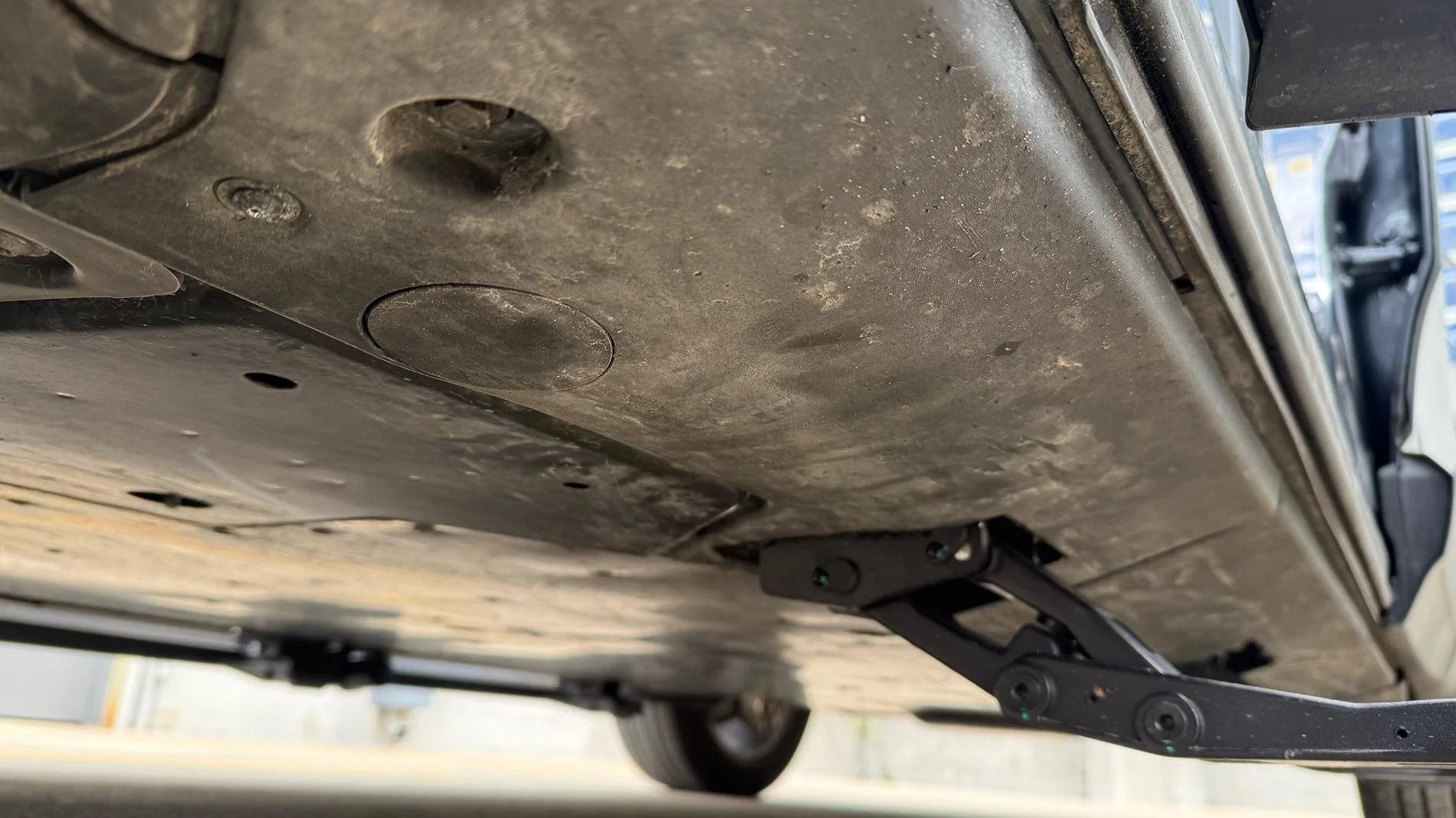

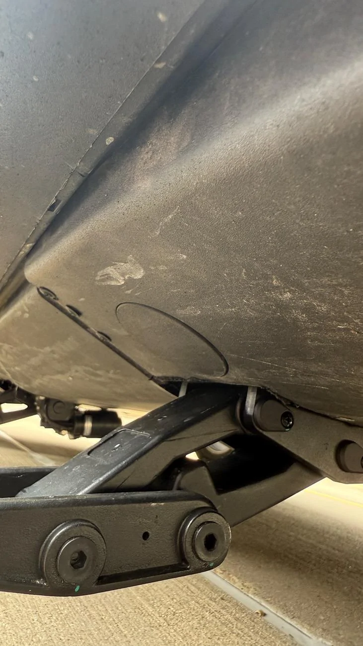

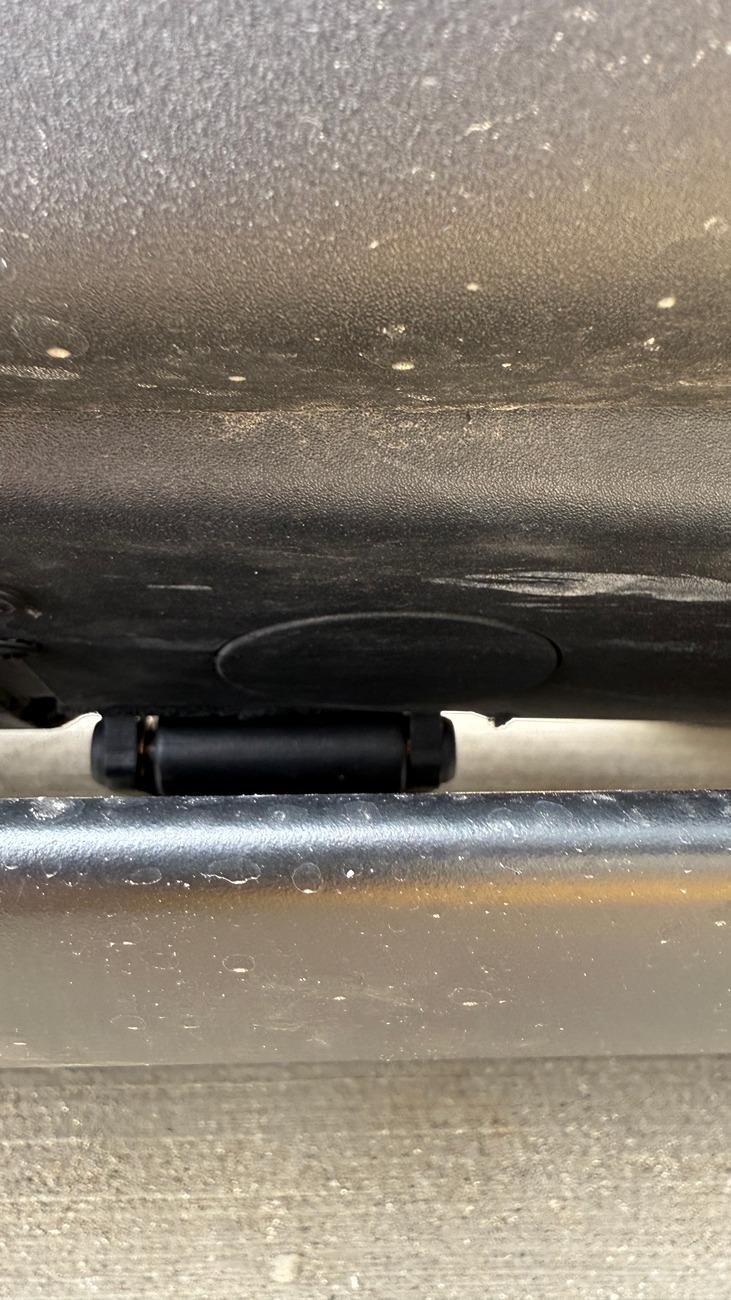

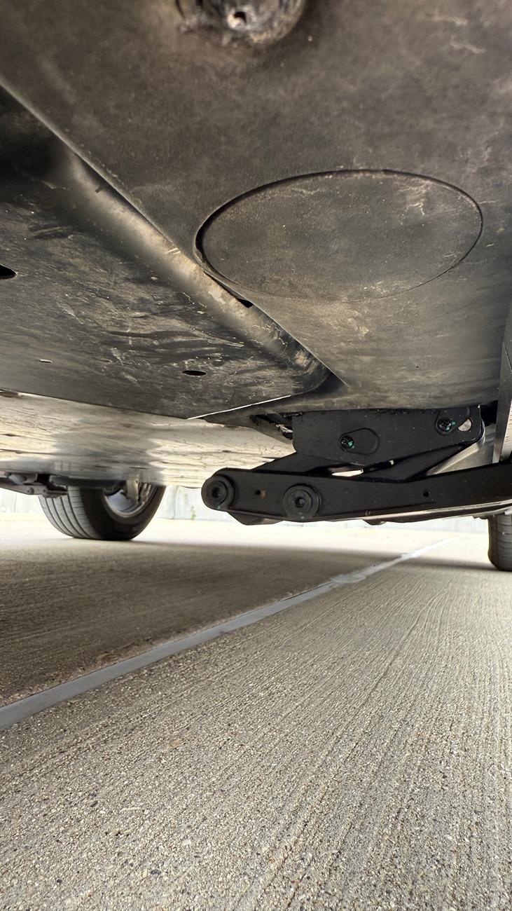

How does the installation of the boards affect access to the jackpuck points?
ChicagoYeti
Clarke
Jan 15, 2025
Chicago, IL
2023 R1S

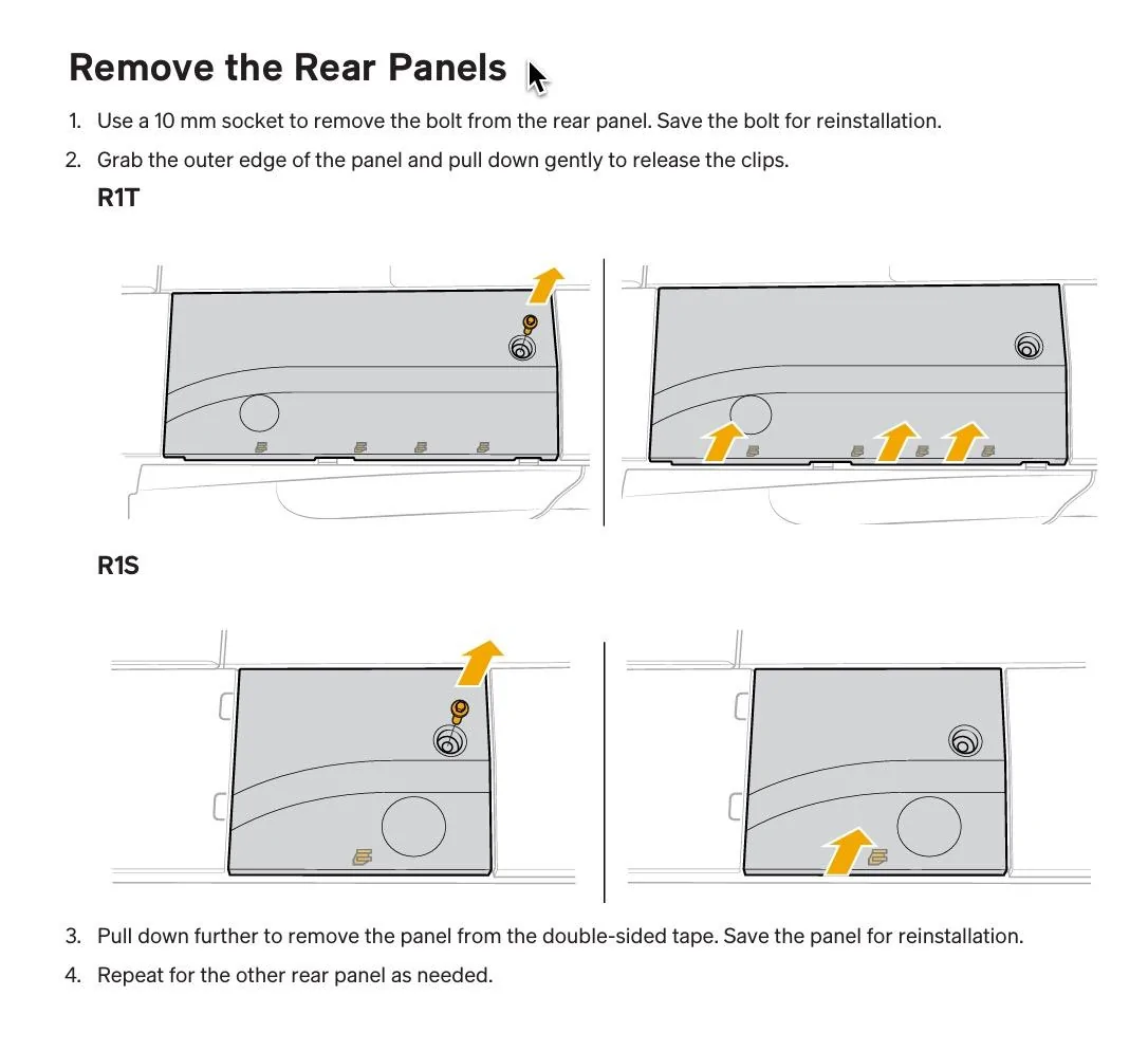

The Forward jack points are not affected, but the rear points are completely blocked (whether the boards are extended or retracted). Not a huge deal, as the frame rail cover comes off with a few screws ... can be easily jacked there.
