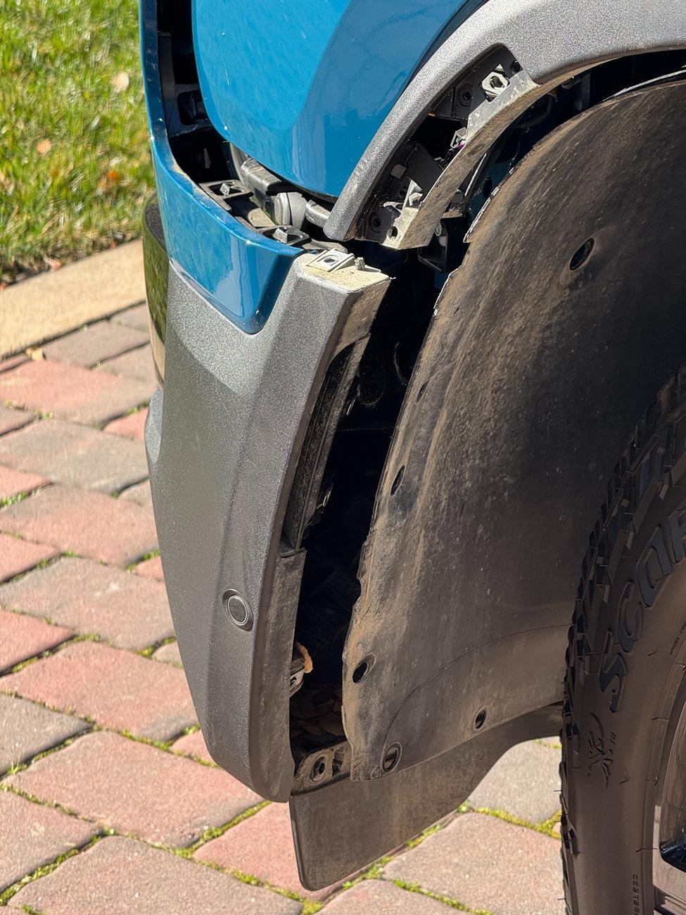

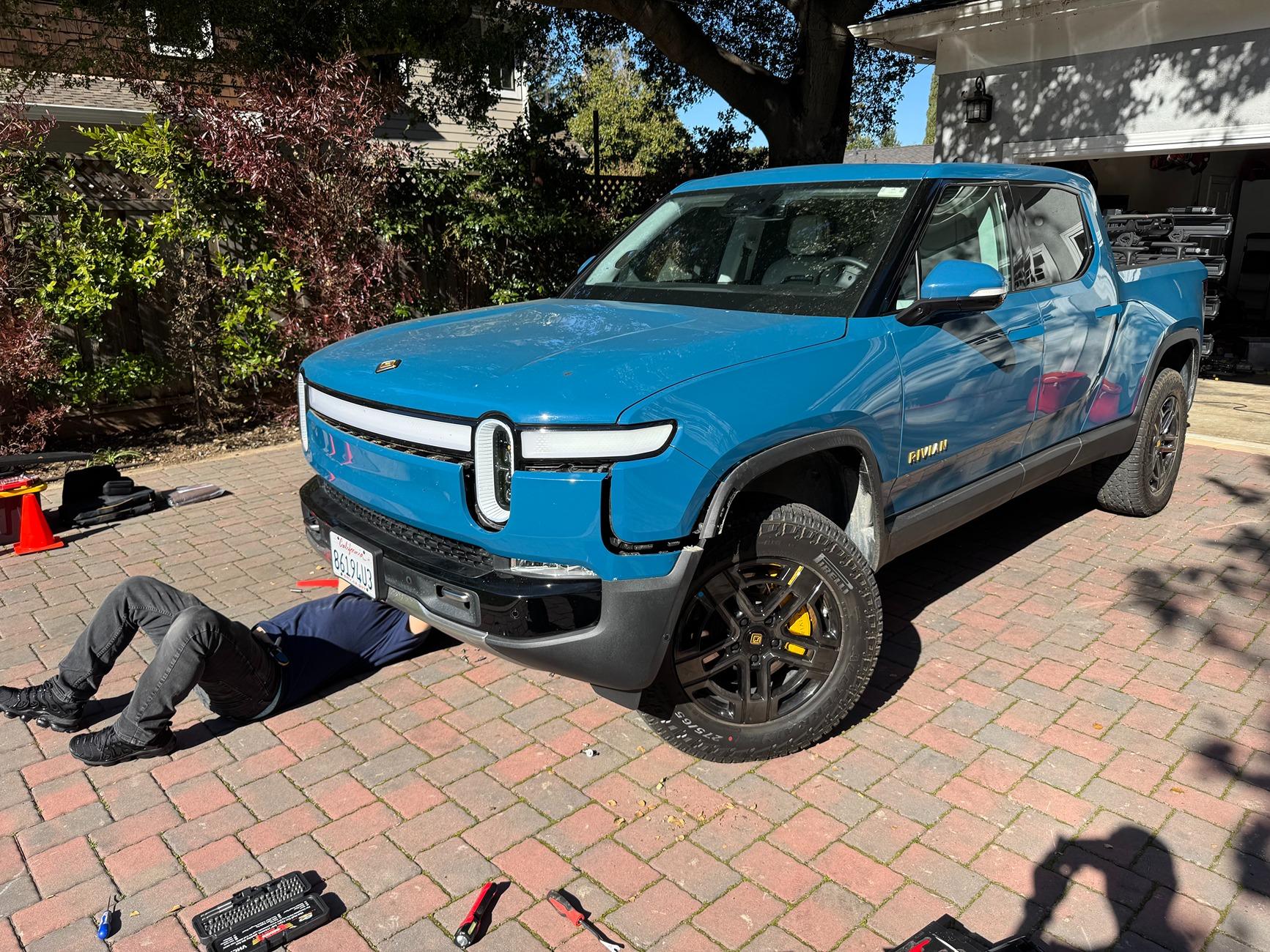

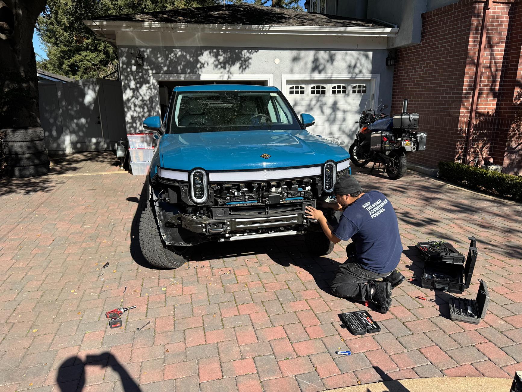

Got to experience the Mobile Service team visit me today in NorCal. My stock horn (I know, I know, ...) started to sound broken and had to be replaced.
Rivian R1T R1S Rivian R1T Quad Gen1 2023 Horn Repair - Mobile Service IMG_0357

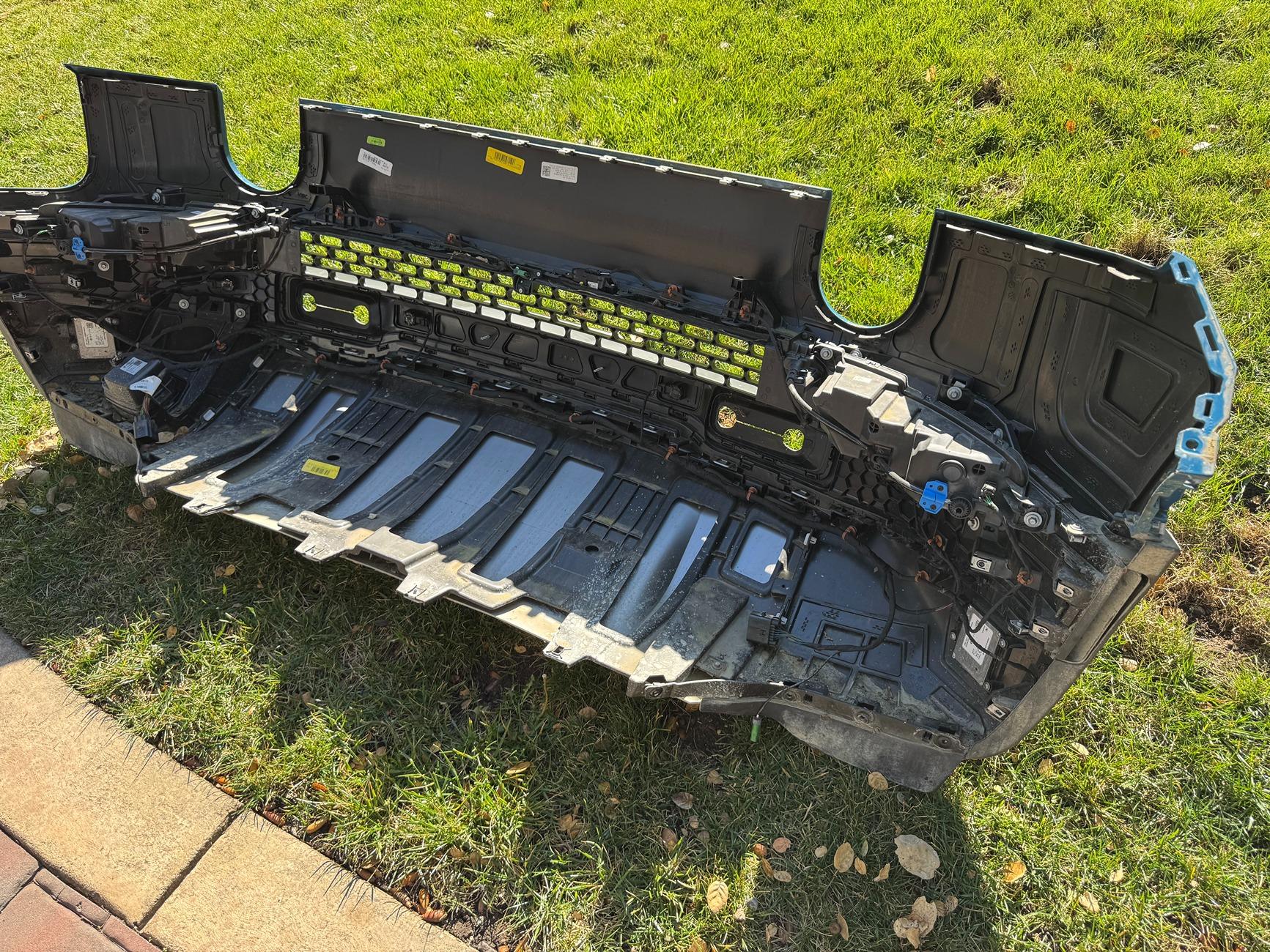

Excellent experience and the perfect weather to watch and learn. Whole front bumper had to come off, something I would have never attempted myself, but having seen how it is done, it's definitely in the realm of possibilities if this ever had to be done. took about an hour to come off. Steady work but not rushed. Replacing the horn is a 10 min task and re-installing the bumper maybe 30 min - so round about 2h of work.

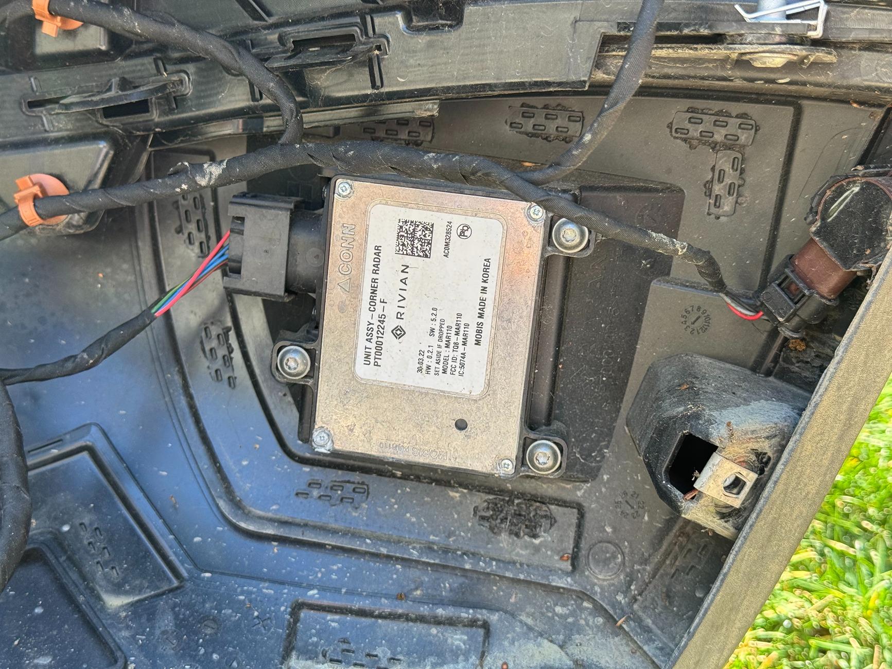

Was interesting to get to see all the components behind the bumper.
Rivian R1T R1S Rivian R1T Quad Gen1 2023 Horn Repair - Mobile Service IMG_0381

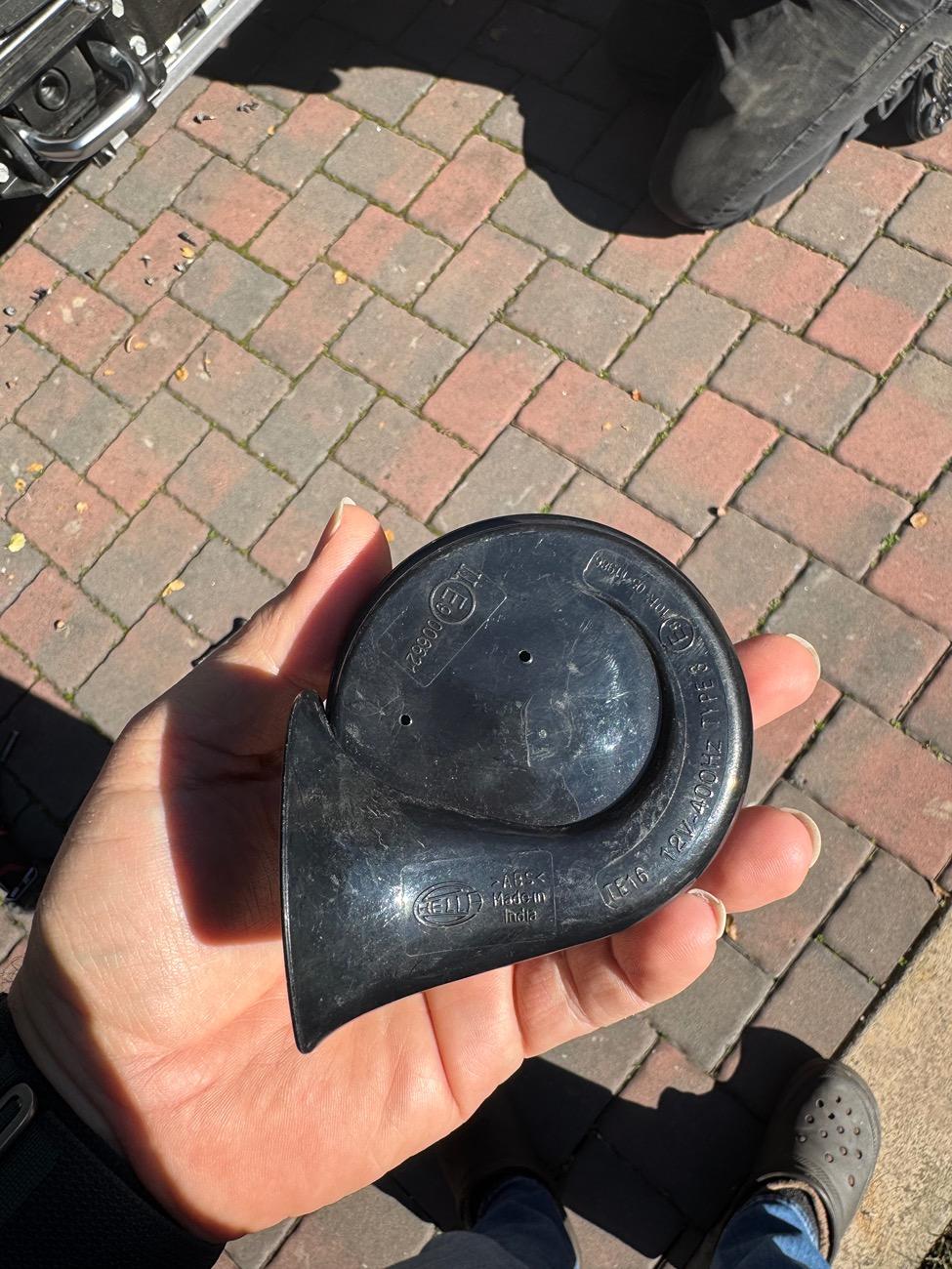

In the end the OEM 400Hz horn was replaced with a new one and sounds at least back to what it was on day one.
Excellent service experience and way more work that I thought mobile service would be willing to do. Great learning experience.

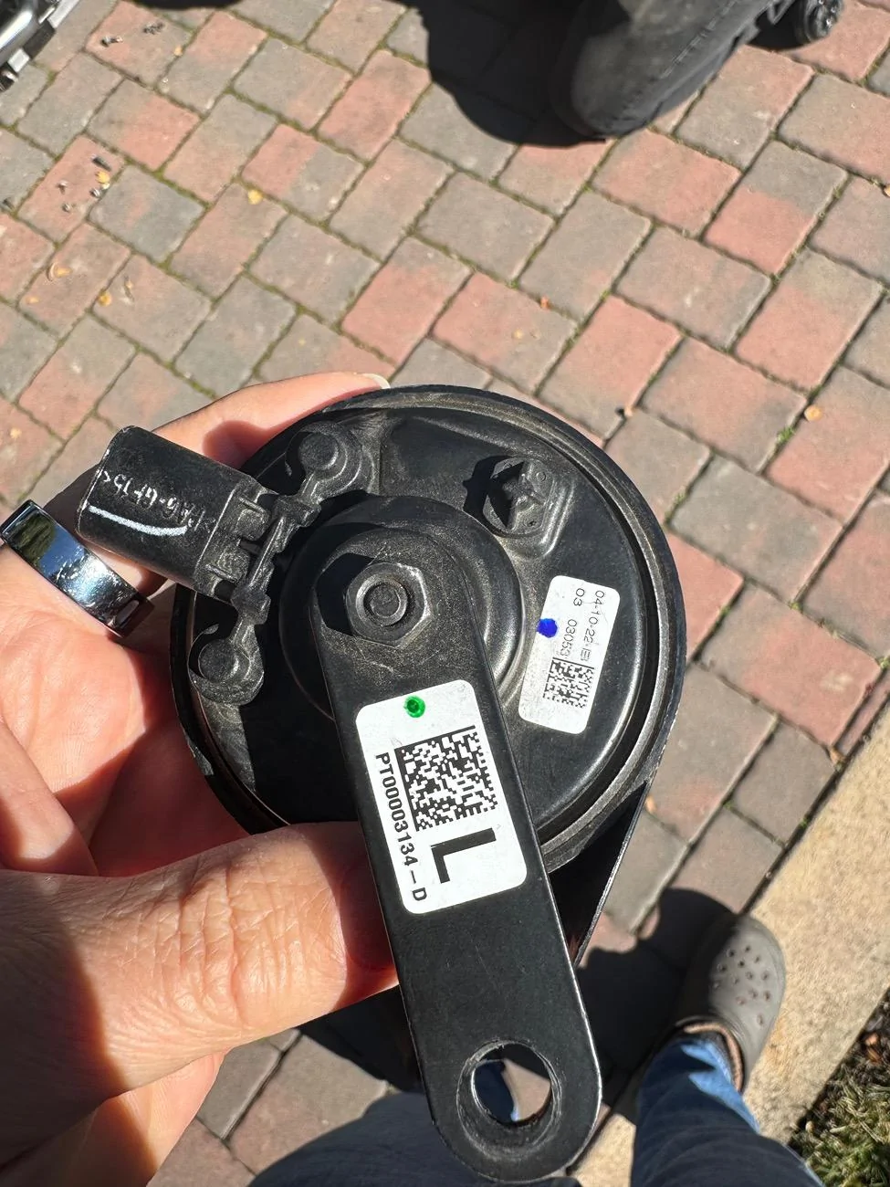

yes definitely 400Hz:
Rivian R1T R1S Rivian R1T Quad Gen1 2023 Horn Repair - Mobile Service IMG_0390
Rivian R1T R1S Rivian R1T Quad Gen1 2023 Horn Repair - Mobile Service IMG_0392
And like for like replacement.
