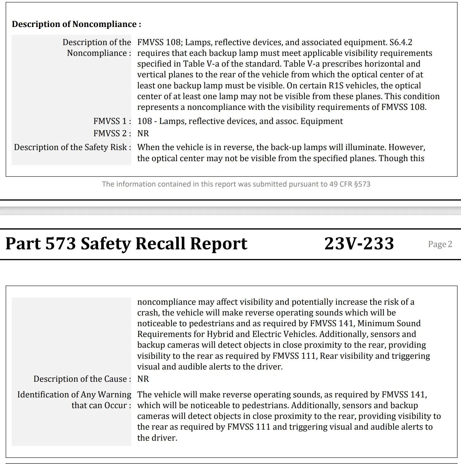

Updated with NHTSA recall document and official Rivian website info:
NHTSA Recall: https://static.nhtsa.gov/odi/rcl/2023/RCLRPT-23V233-4885.PDF
Rivian site:
https://rivian.com/support/article/When-will-Rivian-offer-the-updated-backup-lamp-lenses-for-R1S
https://www.carscoops.com/2023/04/r...-new-backup-light-design-to-meet-regulations/
The issue affects 5,030 R1Ss built between November 19, 2021, and March 21, 2023. These were shipped with reverse lights that do not meet federal regulations. Although the light will shine, the optical center of the lamps may not be adequately visible to satisfy the Department of Transportation’s requirements.
The company was made aware that the reverse lights on the R1S are non-compliant on March 8, 2023. Although the SUV’s taillights appear to be similar in design to its sister vehicle, the R1T pickup, it is the only model affected by this recall. We have reached out to Rivian for more information on that score, and will update this story when we hear back.
The automaker says it has revised the design of the vehicle’s taillights, and will install the new units in vehicles affected by this issue. Rivian will start reaching out to customers on May 20 to alert them to the existence of the recall campaign.

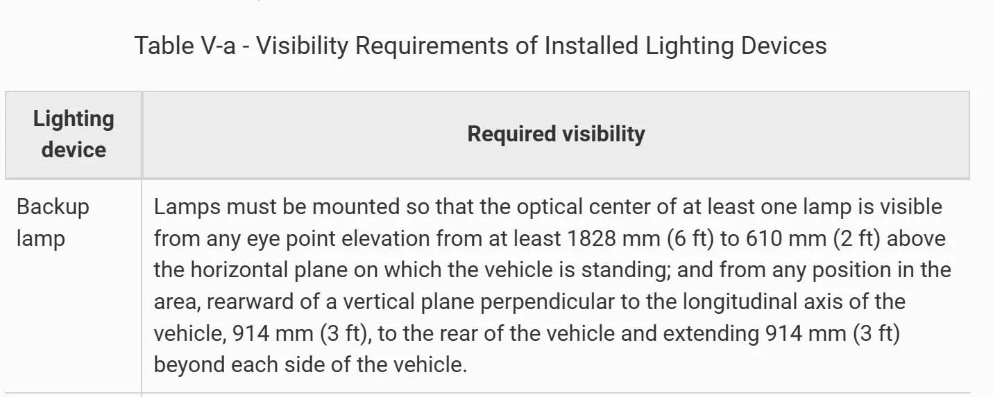

Thanks, @electruck. I now have a clearer picture of what's going on. The noncompliance issue is not that the backup lamps are too dim. Instead, the issue is that some pedestrians can't see the (optical center of) the backup lamp from all positions required by the federal regulation.

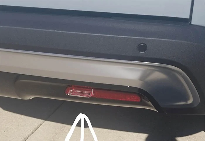

A NHTSA recall document cites noncompliance with Table V-a "Visibility Requirements." In the applicable federal reg, Table V-a specifies all the positions from which at least one back up lamp must be visible. Specifically, a tall pedestrian standing 3 feet behind the vehicle, whose eyes are 6 feet above the pavement, must be able to see at least one backup lamp. (Feel free to try this at home, kids.) Note that R1S backup lamps are somewhat recessed into the corners of the bumper. A photo posted on Reddit in March shows that Rivian's temporary fix was to extend the backup lens rearward (apparently by gluing a piece of clear plastic to the original lens) so that said tall pedestrian can see it. I suspect that the permanent fix (with a redesigned lens) will be more elegant.

I think that is a temporary fix, they are redesigning the lens for the permanent fix and should ready around July to start replacing them based on the Rivian support site.
I’ve seen some recently delivered R1S that have protruding pieces of plastic on the backup lamps. Is that the new lens design?
These extensions are a current measure while we update the lens that sits in the rear fascia of the R1S. Once the new backup lens is available, we’ll schedule a service appointment to install the updated lenses.
When will the updated backup lamps be ready?
We expect to begin scheduling service appointments for impacted R1S customers in July of 2023.
