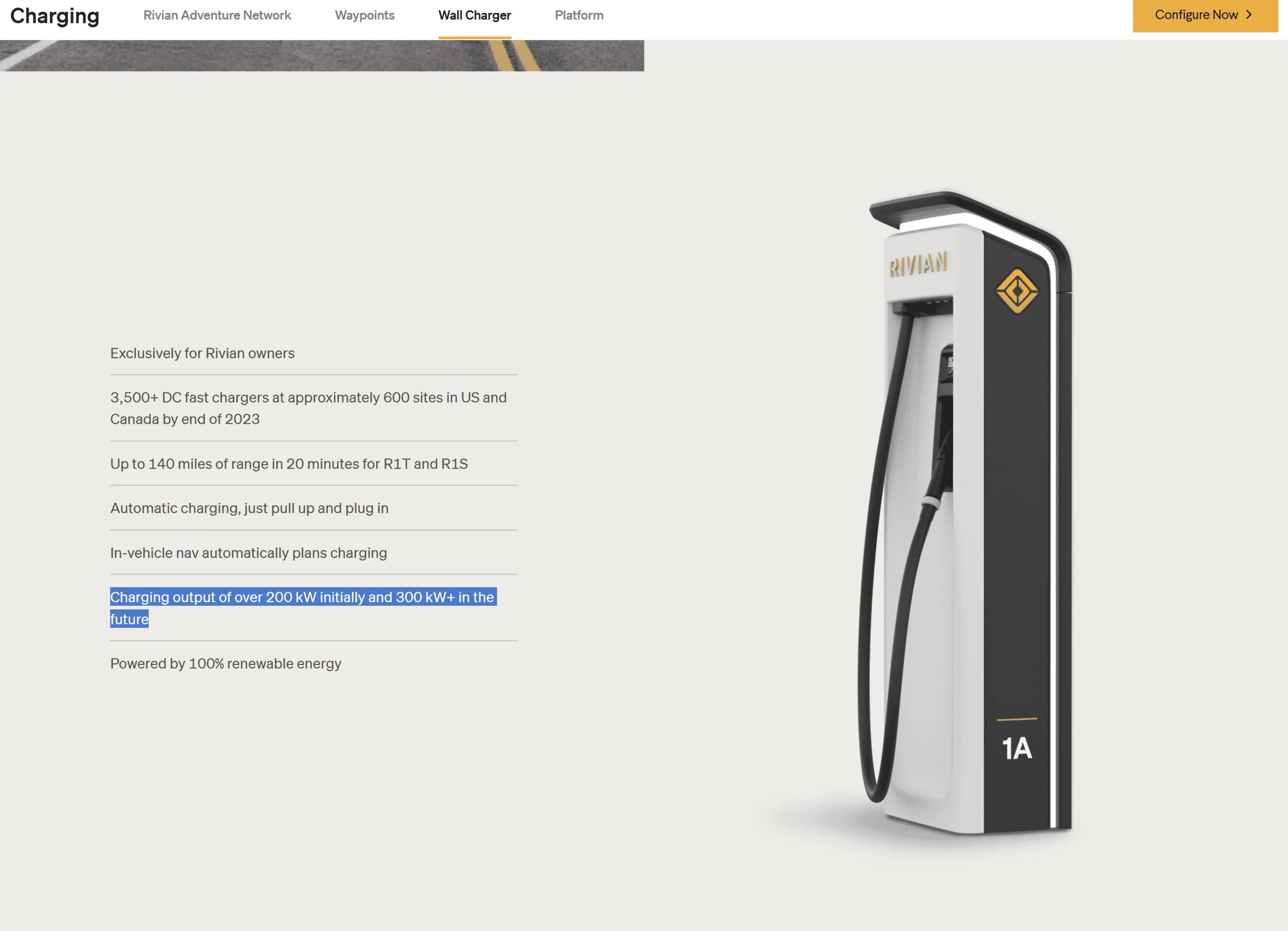

So, I know Rivian's own page as it relates to charging talks about how the R1 platform can charge at a speed of "up to 140 miles in 20 minutes" and then goes on to talk about their own chargers and how they will initially charge at "speeds of 200kw and up to 300kw in the future". Every time I would read that made me think the chargers would be updated over software to 300kw for use with future vehicle iterations, but the current lineup were hardware limited to 200kw.
I spoke with CS yesterday as I have a Max Pack on order and wanted to know if I was going to spend an eternity at a destination charger trying to top up. I asked if the vehicles were hardware or software limited to a 200kw peak rate and she confirmed they are currently software limited to 200, but they would be updated to 300 via software update. I followed up to double check that it pertained to the vehicle and not the chargers, and she confirmed vehicles they are currently delivering to customers are capable of a 300kw peak charge rate. For how long that can be maintained is anyone's guess, but its good to know!
A recent Car and Driver article also touched on this as well. Rivian claims that its R1T electric pickup can withstand peak charging rates of up to 220 kilowatts on a DC fast charger. In the future, it says, its vehicles will be able to accept energy at a rate of 300-plus kilowatts after an over-the-air update.

This was where my skepticism about the vehicles ability to do it crept in
