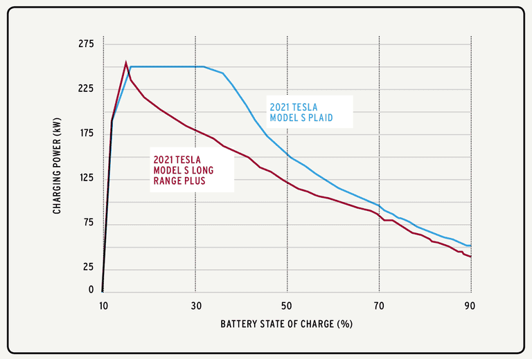

Here is a little graph which shows how two Model S differ in their respective charging curves,
Source: The Tesla Model S Plaid Is the Quickest-Charging EV We've Tested (caranddriver.com)
